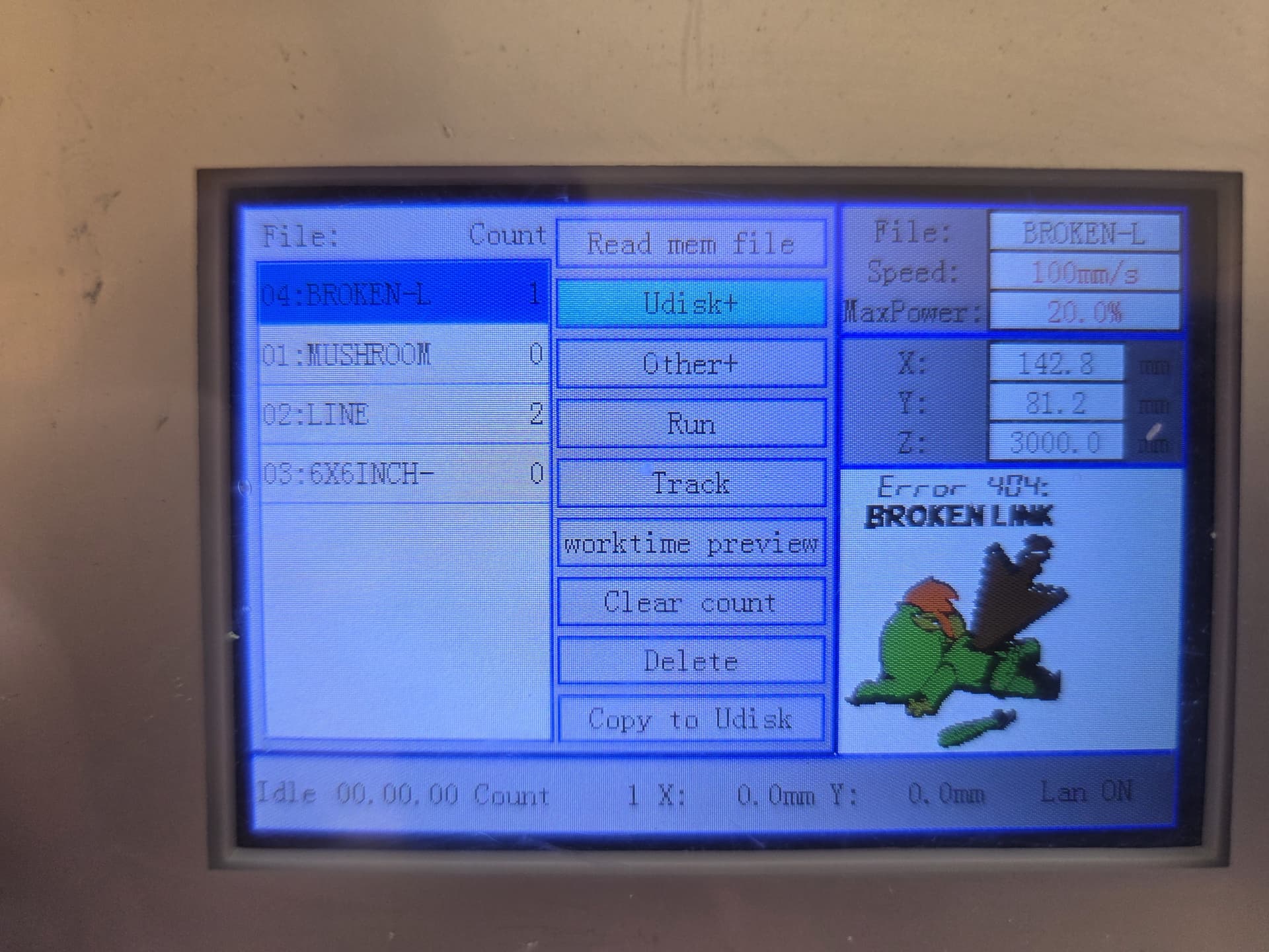

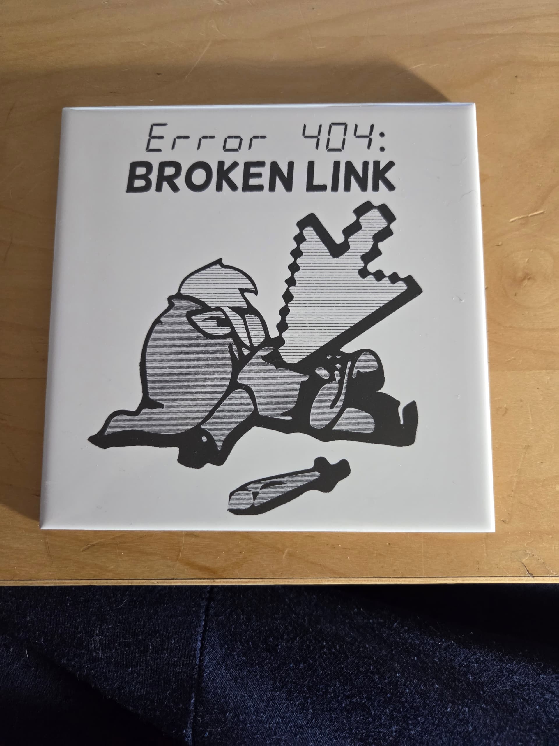

LBT100, Porcelain tile.
404 Error, broken link:
