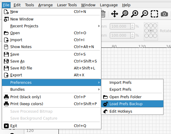

You can try loading the prefs backup. I’m running 1.7.04 version.
Does the engraver need to be turned on to import from backup?
I have version 1.2.04
You can import, but tt needs to write data to the controller, so yes the controller must be powered up.

I tried restoring from backup, but it doesn’t work
Whether it’s because of your slightly old version, I don’t dare say. But, if it were me, I would collect all relevant data such as controller number, end stop position, X and Y length…, and then either restore the settings myself or hope that another user with the same machine will make their file available.

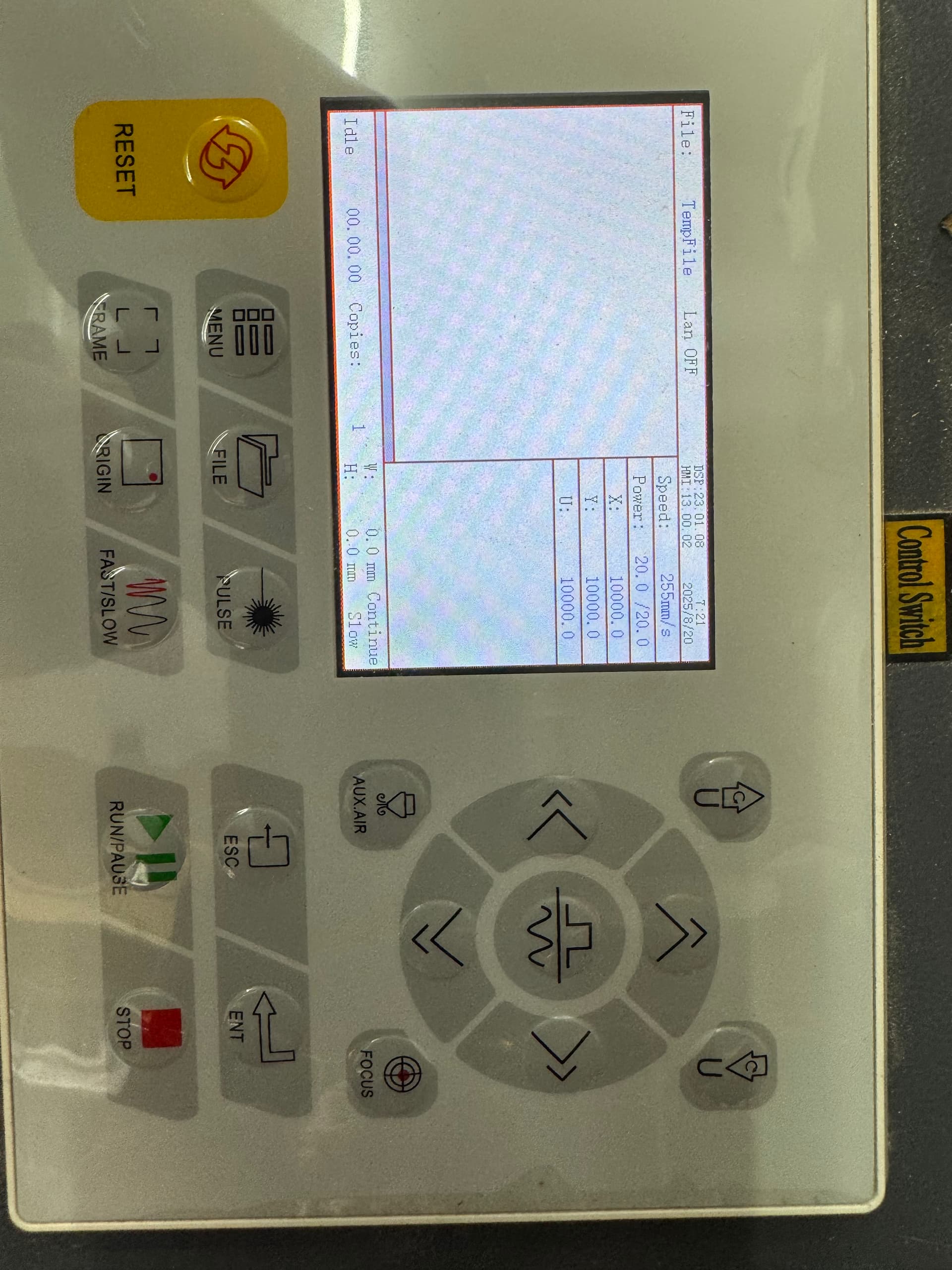

Then I switched to my Rotary. As a was positioning everything, I tried to job the laser (X axis), to align with the top of the Tumbler. I tapped the right button, once. Then head took off to the right, beyond the limit switch. I hit the E Stop. Reboot and I saw the controller had returned to 10000, 10000.
I tried to reload the machine settings (same as before) and but now it is not working.
When I reboot the controller, I get 0,0 for about 1 second, then it beeps and it shows the position as 10000, 10000 and the head no longer try’s to go to a home position.

Usually 10000 on the X and Y axes means it did not home properly. I would expect some type of error message from the Ruida.

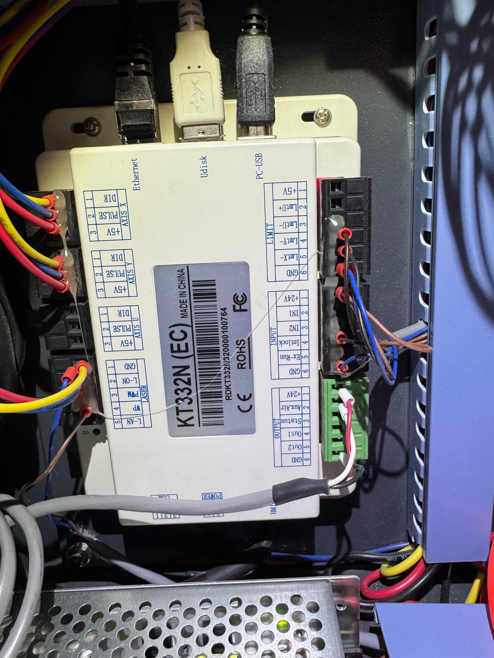

I haven’t seen a Ruida with limit switches in eons, are you sure you have limit switches?
Most Ruida have a pair of home switches. Once the Ruida has booted, these home switches are no longer used. You need a total of six switches for it to home and have limit switches.

Look inside the electronics cabinet and see that none of the motor drivers have red lights. The Ruida should have some led illuminated.

I could be wrong about the switches that are located at each end of the gantry. The switches are little red squares, and when you trip them, they have a red light.

Do you have six switches? Two home switches and 4 limit switches?
Here are photos
I don’t think the KT332 has limit switches. You are not wired up for them.
When the machine attempts to home, it should go towards the home switches. Usually when the machine indicates 10000 on the axes, that axes failed to home.
