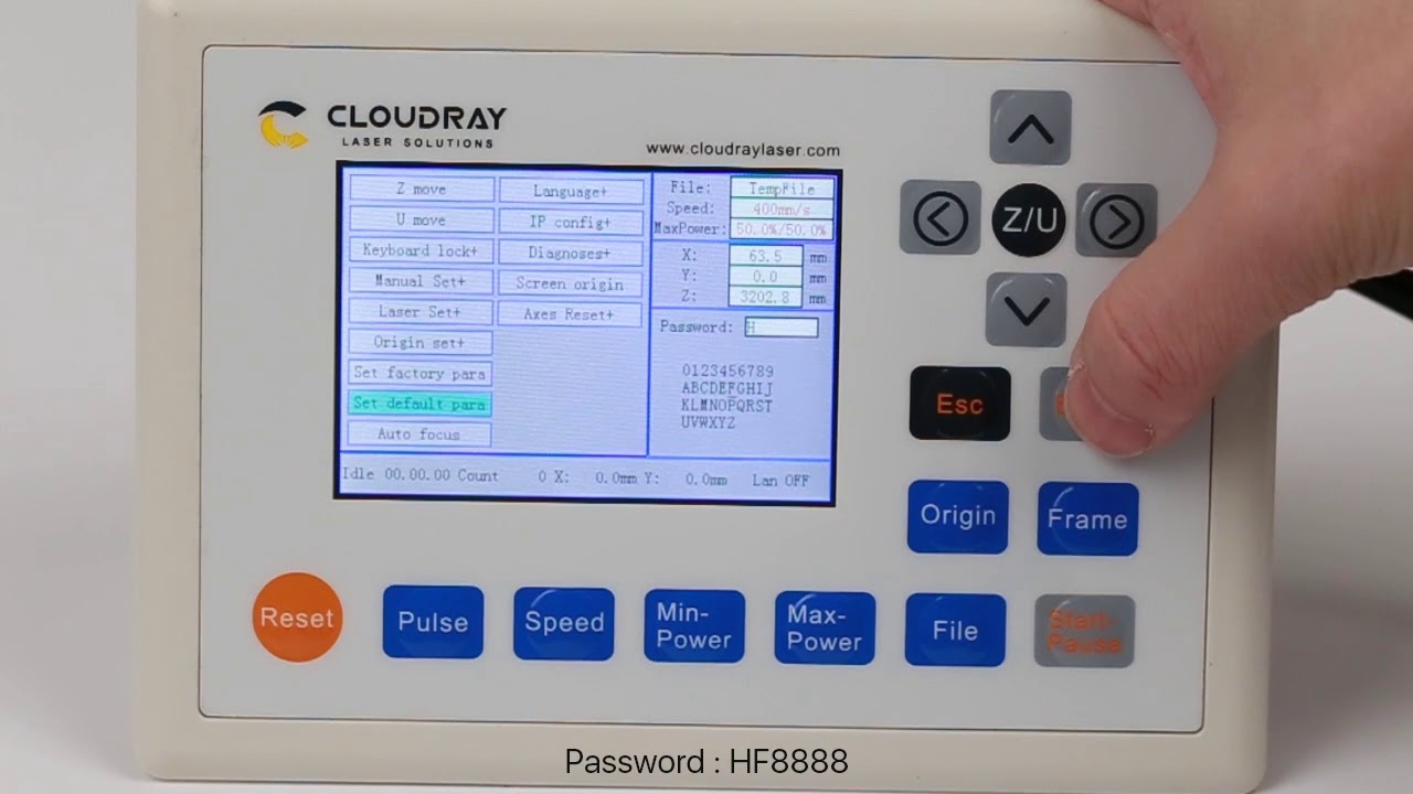

Also not sure how to factory reset the controller, but I do have the machine settings saved so I’m fine with trying.
Just a factory reset of all the parameters within the controller. You can probably find firmware for a re flash, but since it was working, I doubt that will buy you much…
It should talk via Ethernet where you can use Lightburn to restore your saved parameters.
It’'s basically the same for all of these. Just need to know the password… here’s a cloudray video of 30 seconds…
If you can’t talk to it, it’s pretty much lost, I believe, but you can’t talk to it now…
Check cable and all before taking these drastic steps…
Good luck
@jkwilborn Tried the factory reset, no luck unfortunately.
