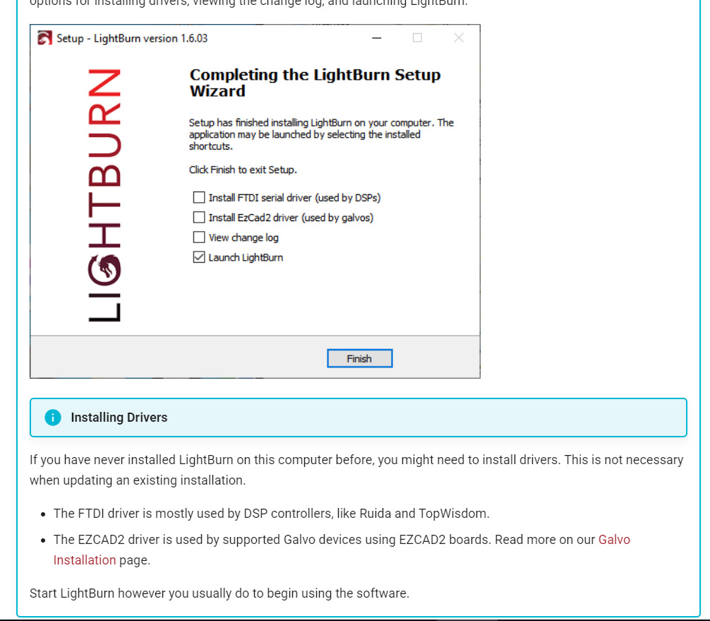

I have trouble to connect to the Ruida controlller from lightburn on my new laser machine. I have tried the edit, machine settings… option but does not read anything. Did connect cable with laser and laptop but still nothing. Can Lightburn please help me to set this up remotely?
Ethernet or USB?

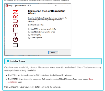

Try running Lightburn setup again and at the end install the FTDI drivers.

Note @parsec post above about the driver file, it is important to ensure you have installed that.
