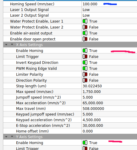

I’m adding RDC6445G and under settings there are no place to turn on homing switches for axis x,y,z. It’s homing like GRBL laser just crashes into limit switches. When I select ruida it change device To my diode laser. Thanks

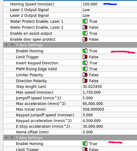

“Edit → Machine Settings → Vendor Settings”
Blue is homing mm/s – how fast it will run seeking the ‘limit’ switch at boot/reset
Red the homing enable…
That option isn’t available on screen. I would enable homing switch’s if they were there. That’s the problem is they aren’t. Thanks

I just upgraded for my new DIY twin head laser that I built. I didn’t open vender file so it was Operator error. Lightburn support pointed that out. It homes now so I can move on to cal. stepper motors. Thanks for take time to answer my questions. I do have diode laser that I have been using for last 8 months. I have a lot to learn about lasers. Thanks again
