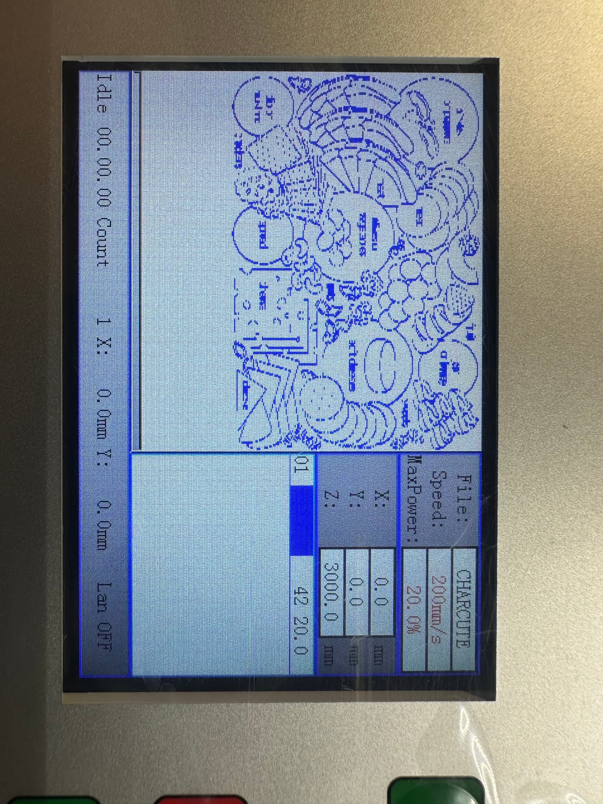

OK I uploaded a phot of my Ruida controller and the Screen showing my computer and lightburn.
IN one spot on the ruida controller it’s showing 42mm at 20% and on the top, it’s showing 200MM with 20% but on the Lightburn Screen i put in 100MM at 20%. Why are they all different?
Those are, I think, the manual settings when a file is not running.

But on the Ruida Controller, the blue mark which is supposed to be the file that will be run is showing 42MM at 20%

The screen photo you attached seems to have metric units, but when I load it here the speeds and powers do not match what you are stating. The Blue layer that appears as 100 mm/s (?) shows here as 42.3 mm/s, there is no Red cut layer in your photo, and the file does not have the Tool layer.
The screen increments in your photo seem to be in inches, rather than millimeters.
Perhaps you have selected inch/sec or the mixed inch mm/sec, rather than mm/sec? Take a look at Edit → Settings → Display and Units to verify it’s what you want; a screenshot (rather than a photograph) of those settings would be helpful:
The file was from my Outur 5 watt laser but I did uodate the setting for the new Omtech laser. Laser does not fire like you said at less than 10%. The board I was using has a drip ring around it and the green layer was representing the drip ring. The inchs to MM is the old laser to the new laser. Still don’t understnd why the setting are all different. Also on my Diode laser, it would should how much of the project was completed. I get nothing from the Omtech showing the progress in Lightburn.

Because you have LightBurn set to inch/min.
The conversion from “inches and minutes” to “millimeters and seconds” is 25.4/60, which is exactly the ratio between the 100 mm/s you think you set and the 42 mm/s the Ruida controller is displaying.
Thank you Ed, now i understand.

I found where the confusion was, it was in the device settings. It was set for inches. Changed it to mm and now all the settings are the same, Thank you Ed. Thanks for you help and giving me a hand.
