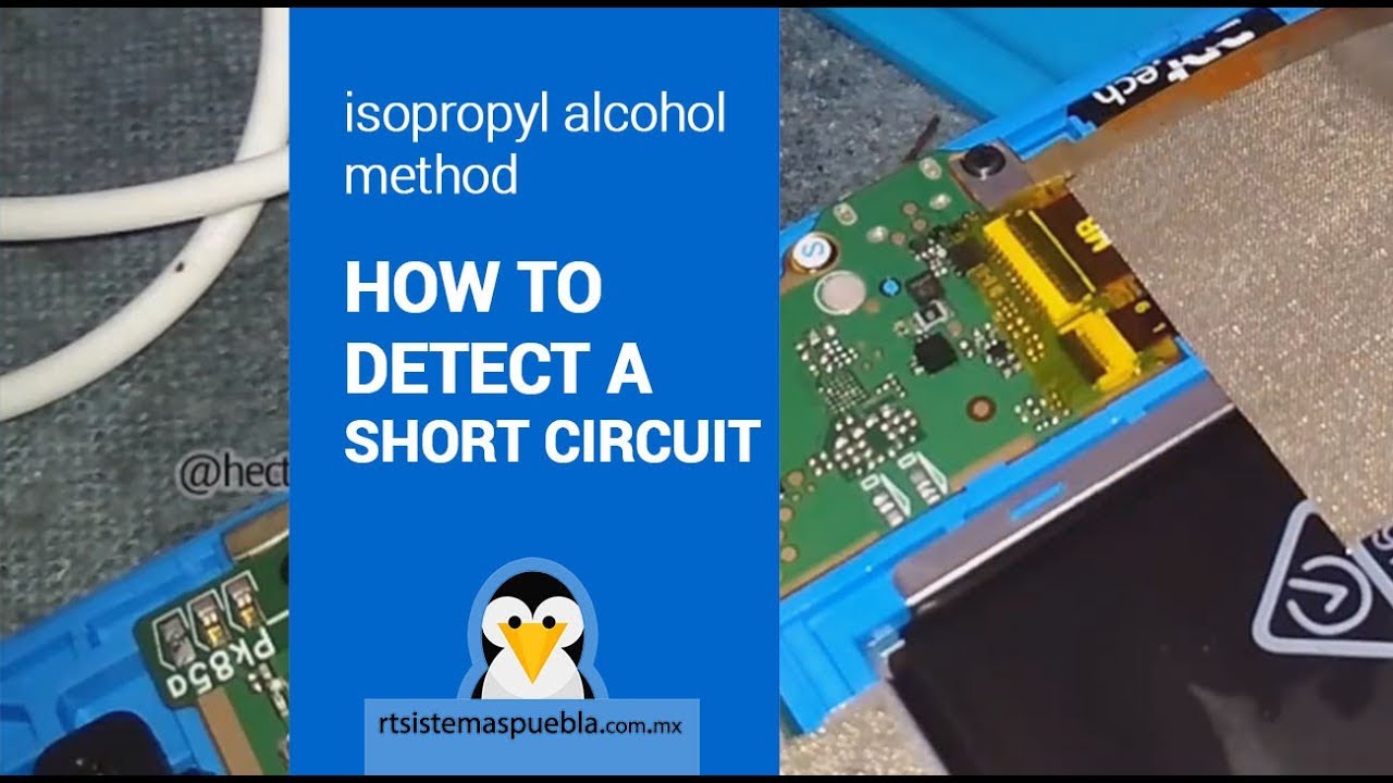

You can use isopropyl alcohol or an inverted air duster can/ freeze spray (to freeze up the board) and see what component heats up first - this can be useful to find shorted SMT components, but it’t sure fire by any means.
