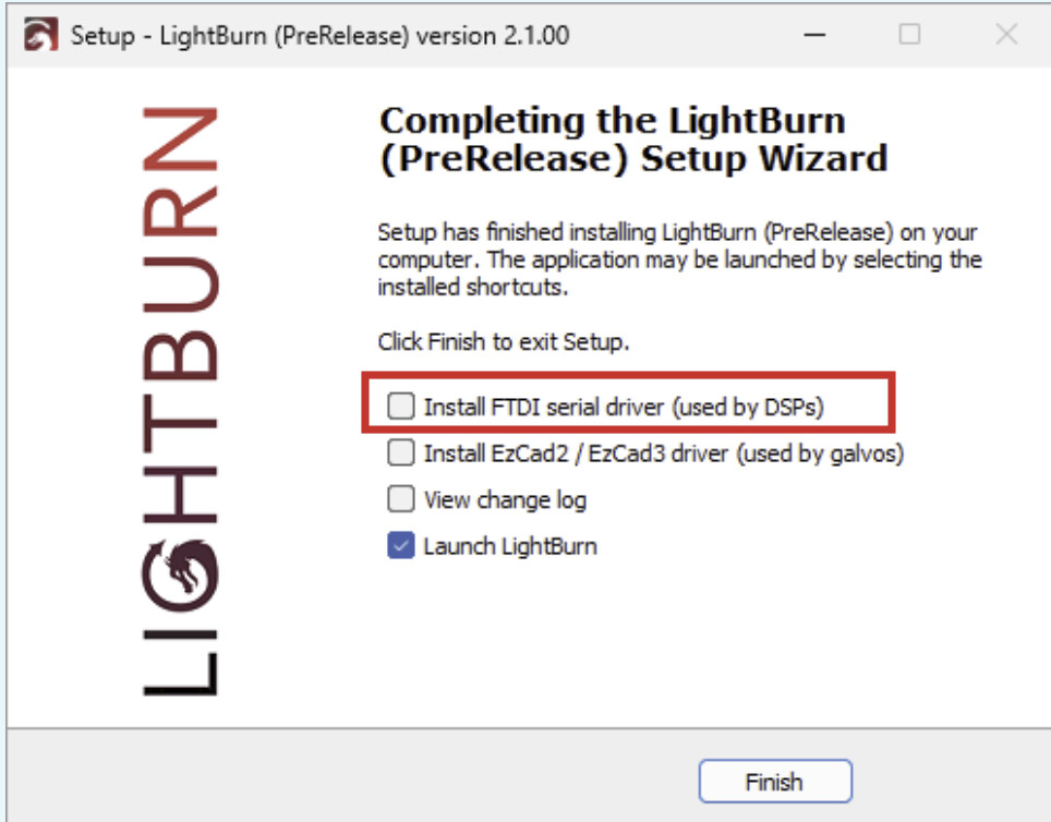

The LightBurn installer also comes with drivers for a DSP controller like your RuiDa. You would need to tick this box in the last step of the installer:
“FTDI” is the manufacturer of the Serial-USB chip in most, if not every RuiDa controller.
We only know your firmware version. Which exact controller do you have?
With your galvo laser, it’s a similar story as my previous message, but you’ll need to tick the other box Install EzCad3 / EzCad3 driver
If your controller is a BSL, you should have receveived the necessary driver from the manufacturer instead.
