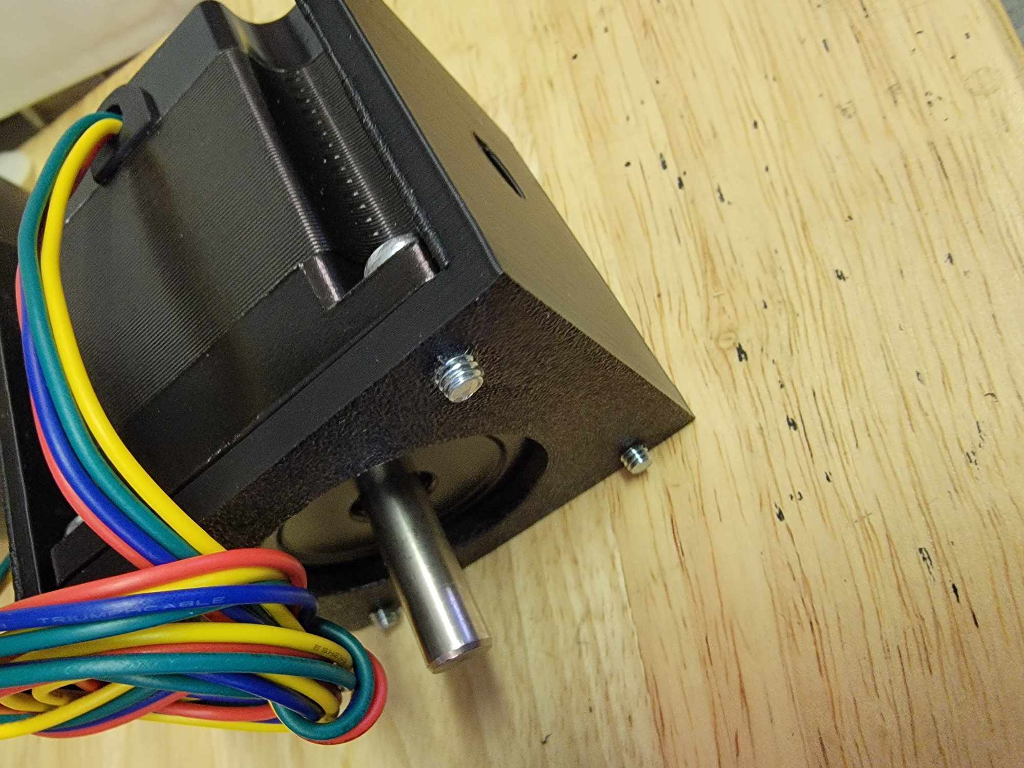

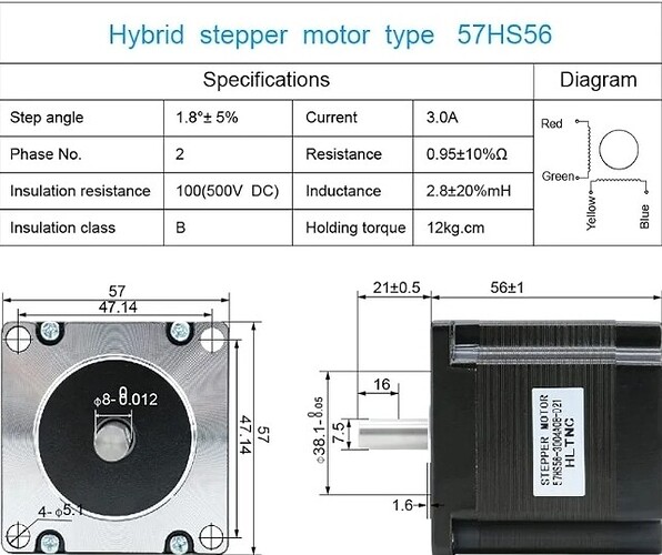

Put together a rotary using a Creality Rotary Pro, a couple 3D printed parts, and a NEMA 23 motor. (Pic of motor specs attached) Thought I had it figured out since I’ve been using it for a while but tonight noticed some connection wires smokin’. The motor itself wasn’t abnormally warm or hot to the touch.

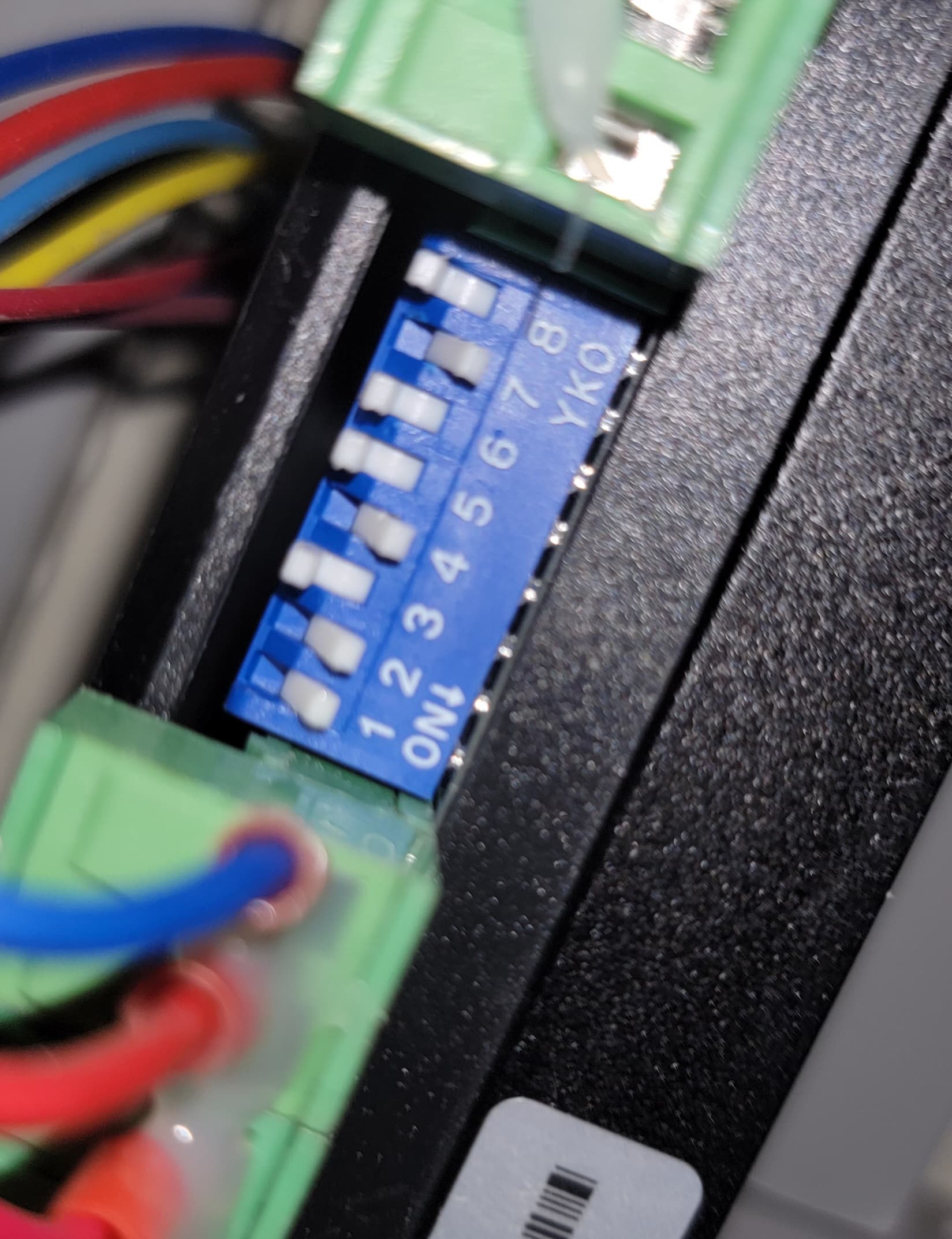

This is a Monport 100w CO2 running the KT332N /DM545A controller. Attached are pics of the dipswitch settings which should be set correctly, or so I thought. Default config for y axis for laser is as pictured except switch 1 is set to off.

The usual stepper motor cables for diode lasers tend to be grossly under-sized for whatever wire size they claim to be (some don’t bother mentioning that) and might not even be copper, so if that’s what you’re using, now you know why it’s a Bad Idea.
Because the rotary won’t need much holding torque, you should set SW4 Off to drop the idle current to 1.5 A.

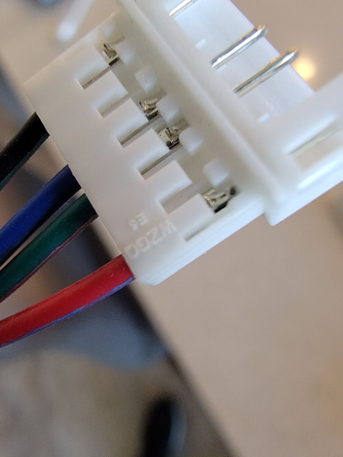

I’ll definitely give SW4 a shot. The motor wires come attached to it, so I have jumper wires between those then to this 4 pin cable. Perhaps the jumper wires are the ones that are too small. By chance do you know what end this is? I’ve exhausted my searches and can’t match it up exactly.
Maybe this?
or
Thank you Jeff. I did order a JST connector kit from Amazon but it didn’t work out for some reason, don’t remember why as it was January lol. I can’t seem to find just the connectors with the notch out of it. IDK if it really matters. These also have a smaller gauge wire, so didn’t go with ones like the links you sent.
Both of those are 26 AWG and grossly under-qualified for 3 A, even if they happened to be pure copper.
If I were wiring that thing, I’d get rid of that white connector and splice the motor directly to the connector on the right end of that xTool cable, which is some flavor of an “aviation connector” along these lines:
Assuming the socket end of the aviation connector is on the laser, measure its inside diameter to be sure xTool hasn’t used some weird non-standard standard.

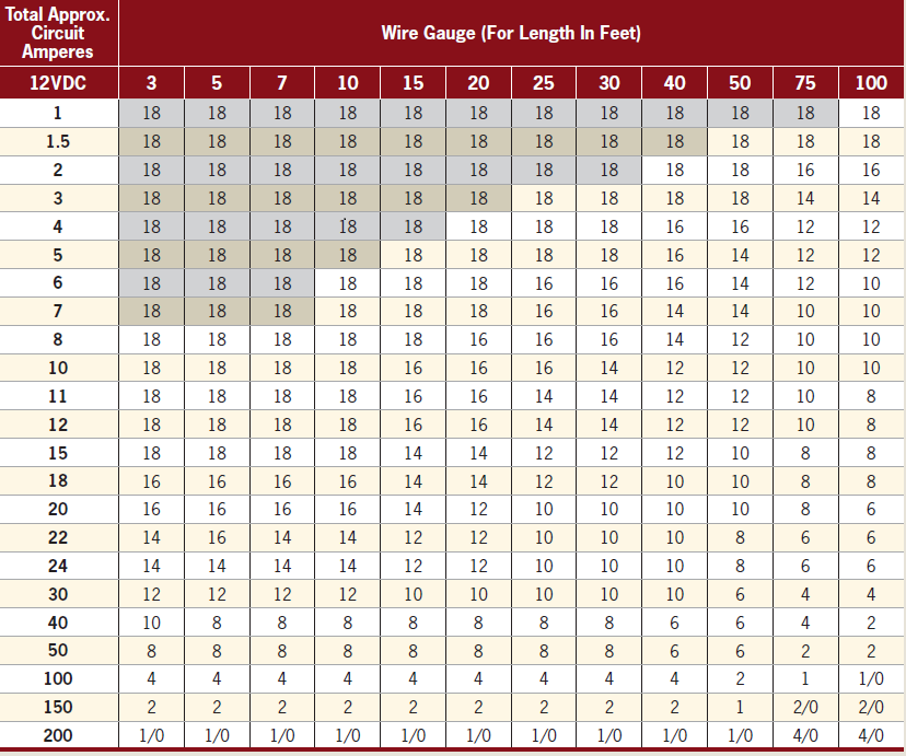

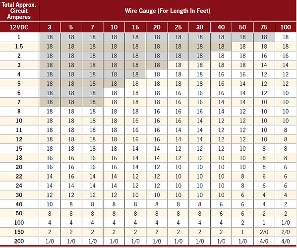

I have some 18/5 solid copper wire. Think that’s good enough?
Wire ampacity chart shows minimum 18ga wire for 1 amp, at any length.
No, it has to be flexible. Continuous flexing solid wire will break it. Solid wire is only used in coils and house or factory wiring.

I tend to be conservative with wire sizes, but 18 AWG is about as chunky as I’d want for maybe a meter of cable = 2 m out-and-back.
