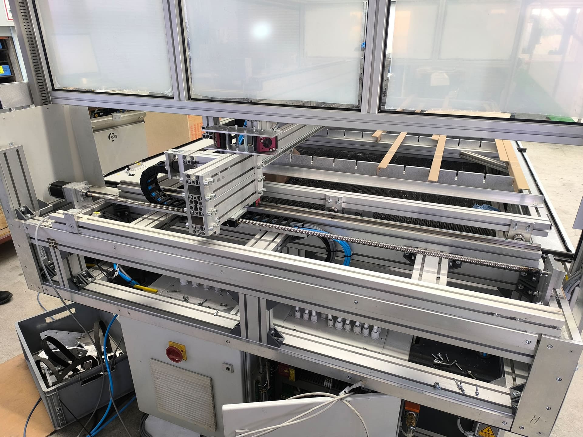

We are currently building a laser that needs a double drive for the Y-axis (portal).
As it is over 2500mm wide. We have 1 stepper motor and 1 spindle per side.
Our problem at the moment is, and I can’t find a solution, so I’m asking here, maybe someone has already implemented this.
Connecting the output stages in parallel to the Ruida is no problem, the motors move simultaneously.
But we would like to use a separate reference switch for each motor.
So if a motor has step losses and the portal is no longer at an angle, each motor should rotate during the reference run until each side recognizes its own reference switch. Then the portal would be at an angle again. Unfortunately, I can only connect one reference switch to the Ruida and I only have one output for the stepper motor for the individual axes.
Perhaps someone has an idea or a tip for another controller with which this could be implemented.
Best Udo

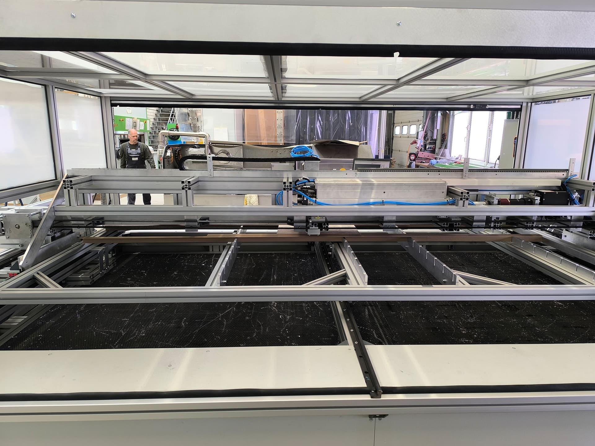

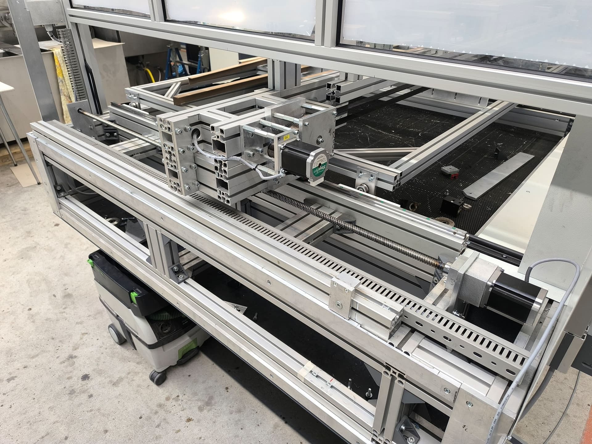

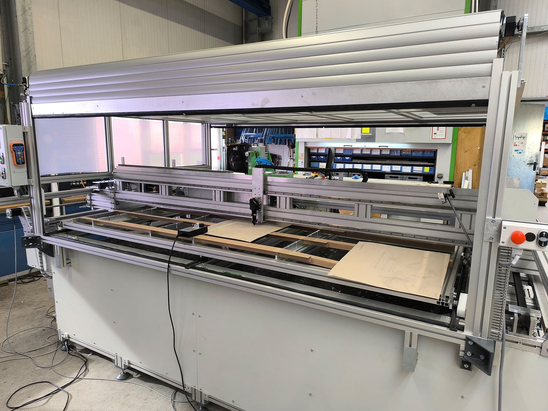

Due to our heavy gantry, we have to use 2 drives. A few pictures of what we are currently building.

We first had a motor with a timing belt drive, from one side to the other with a wave.
But there was the problem that the very heavy portal through the coherent source always swung when changing direction and the long straps also caused vibrations. Even if they were very tightly tensioned and supported by additional rollers.
We then decided to remove the belt drive and replace it with the two spindle drives.
We were able to significantly reduce the vibration and swinging by using the additional spindle with the ball nuts.
In principle, this also works in parallel operation on the Ruida, as long as there are no step losses, e.g. when accelerating too hard.

We’ve rebuilt and reinforced the gantry quite a bit.
We’ve switched to two spindles with a pitch of 5.
The laser has been in production at the customer’s for 2 weeks, and they’re very satisfied.
