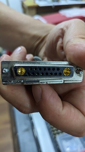

As I know I have this plug see picture.
Description for wiring colors
Blue -wiring number 4 on plug means Modulation +
White - wiring number 5 on plug - Key +
Brown - wiring number 9 on plug - Laser diode input
Green - wiring number 10 on plug - Laser diode return
Orange - wiring number 13 on plug - interlock -
Yellow - wiring number 14 on plug - interlock+
As shows Ruida manual (see picture) I need to plug 3 wires only to control RF tube.
Maybe someone have any idea which colors should I use?
Below also pictures from plug
Here picture from Ruida manual.

RF systems are generally only one wire, the pwm.
If you look at the Ruida schematic, the enable is hard wired to 5V, so all you need is ground and pwm… The pwm would likely be the modulation.
The ULR needs roughly 13v on pin 13 to enable. The mfg has 13v on pin 14, the intent was to use magnetic reed switches that connect these two pins with just a mechanical switch. It’s intended to be a low-level hardware interlock at the laser itself that electronics and software can’t screw up. Without ~13V on pin 13, it will power down its input stage and ignore the PWM input.
The RDC6445S connection diagram shows it’s kinda bypassing a laser’s Enable because it’s just hooked to 5V so it will be enabled any time the Ruida has power, it’s not a safety interlock. But the Ruida does implement door-open and coolant flow inputs and isn’t supposed to be able to send out a Modulation signal if the door is open. In any case, the Ruida’s 5V probably isn’t enough to wire to pin 13, and the 24V rail is too much and will probably damage the ULR tube’s input. So, don’t do that.
You’re using the existing ULS frame, so you’d leave this connected as it is. It goes through I think two Hamlin magnetic reed switches. If the lid is open, the controller won’t know this will just disable the beam and it runs without cutting for as long as the lid is open.
Warning though: ULS kinda screwed up these switches by mounting it in a steel frame. The flux from the magnet on the movable lid tends to mostly shunt through the steel frame so the switch has a much reduced detection range and very sensitive to misalignment. And with multiple switches in series it’s very hard to tell which one isn’t closing. A lot of people bypass the extra(s) and just rely on one switch.
The ULR tubes do not require pre-ignition, so you may not need to select “RF laser” at all.
