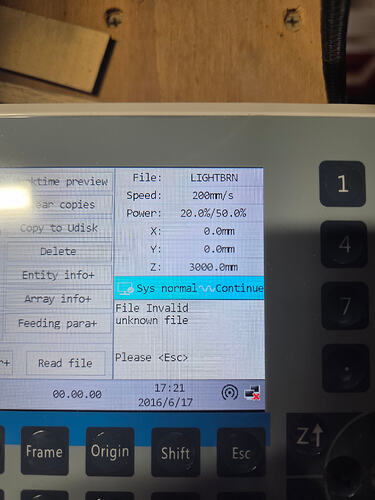

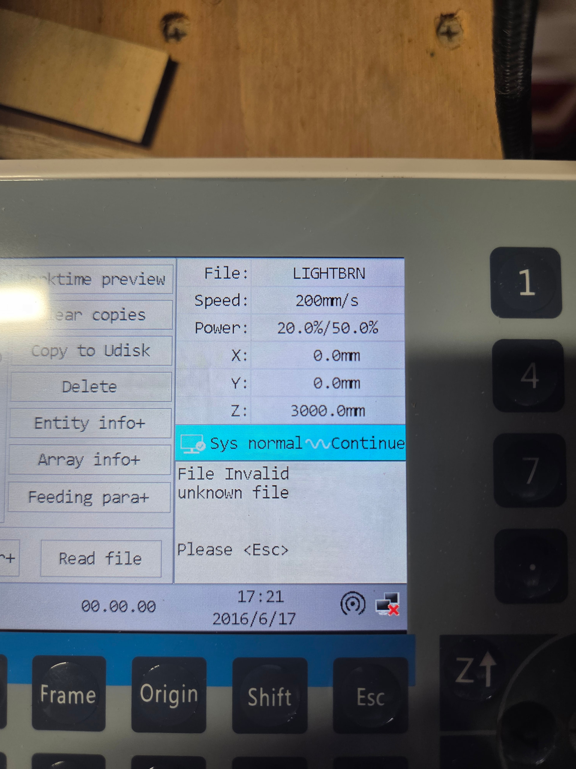

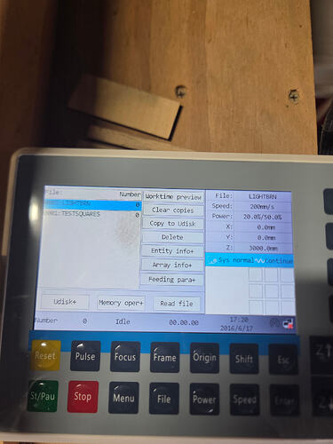

RuiDa RDC8445S(EC) WiFi, and bust. Total Communication Lockout across USB, LAN, and some success in Wi-Fi
No funny characters or weird symbols or anything on my end, it just sends a file and then I i can’t access the file menu in the controller
I think the problem might be in the version software inside the controller. The controller came with v10.30.01.09
Well, you’re the comment got me to thinking and started irritating something in the back of my mind, did I use weird characters when I sent us file names? Did I try multiple file names? So I just tried to send a file using a very simple name, and it seems to have worked.
That is a very little detail that I missed

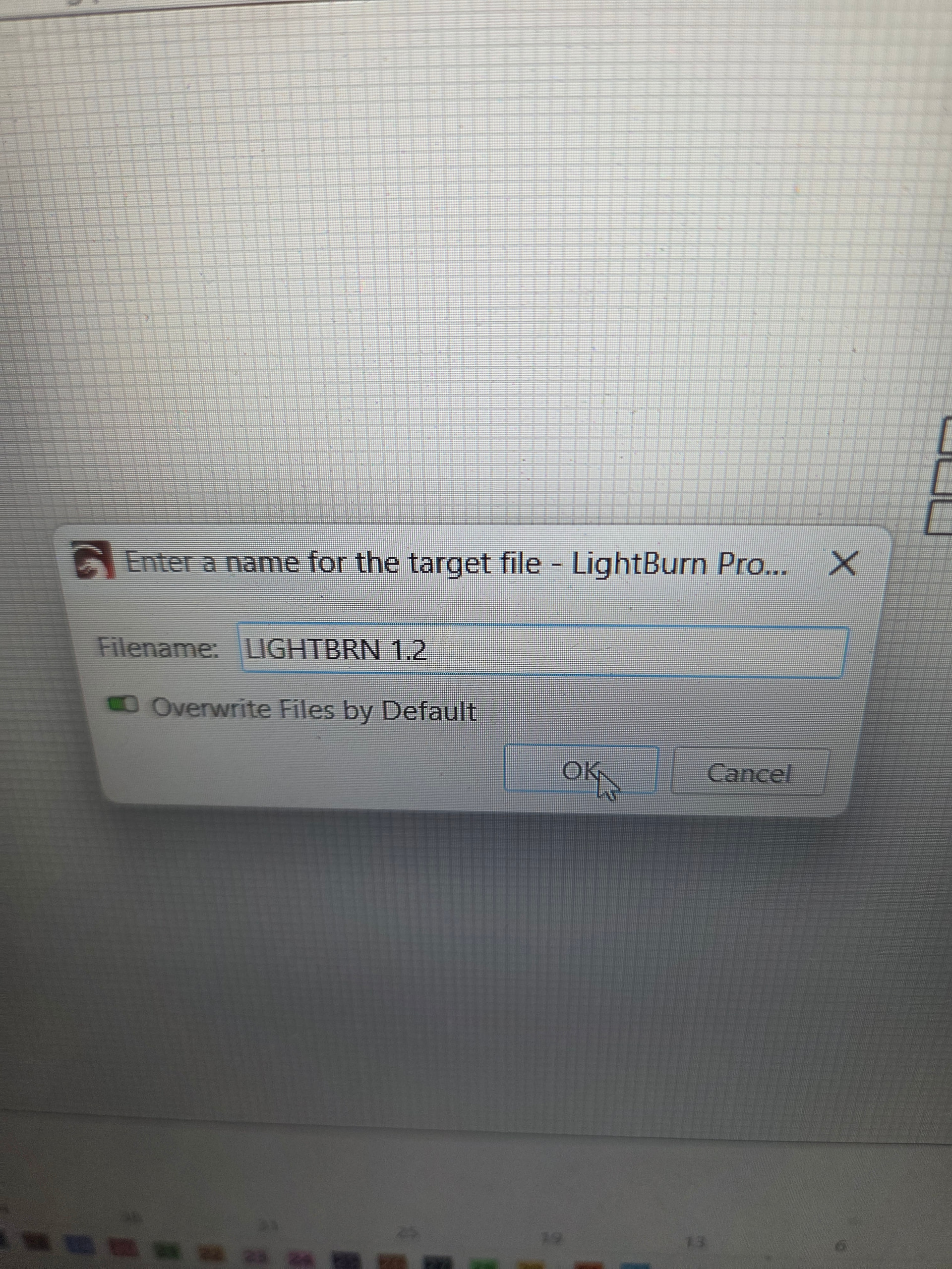

As a test, give it a space and a period in the filename and see what happens…
Ie “test 1.2”
I’m interested to see if it behaves like mine…

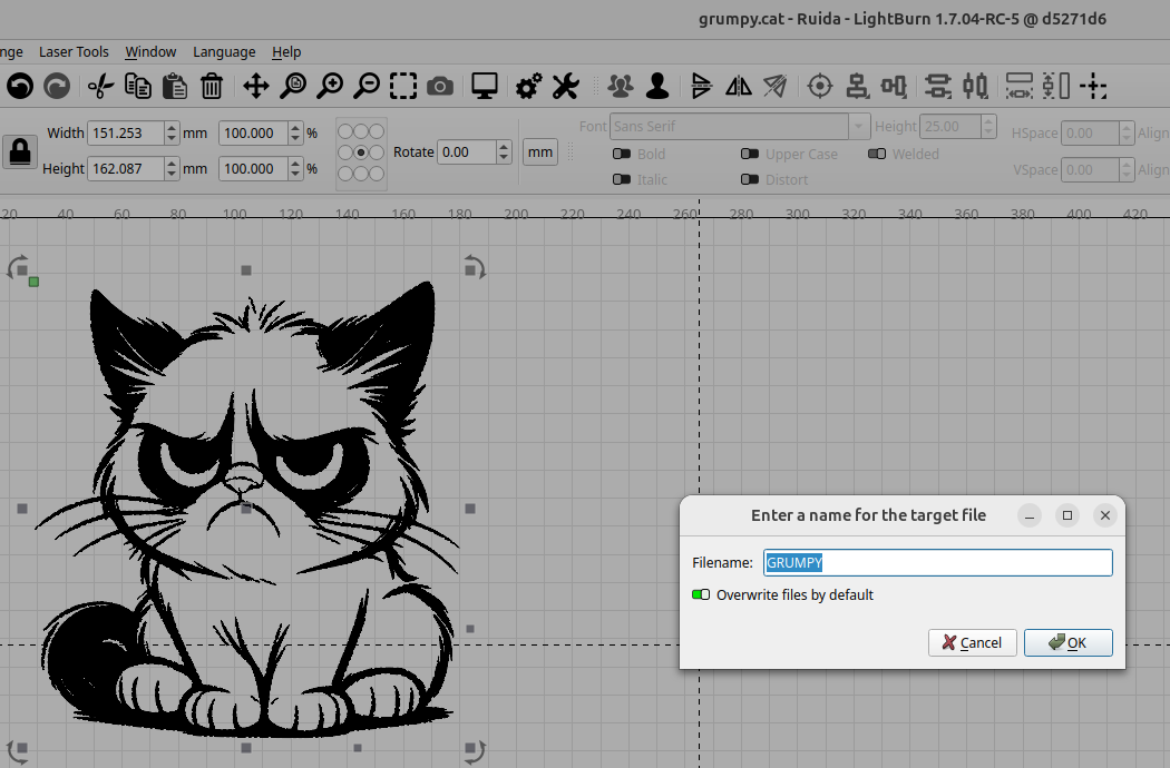

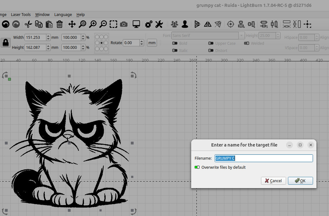

I think Lightburn truncates it. Notice the project name (red box), then when I try to send it, it’s truncated after the 8th character.
Replacing the ‘-’ with a space, they also seem to be truncated.
Changing the space or ‘-’ for a dot or period.

I’m using the mobile app, so I had to do this in 2 posts. I just tried uploading a file using the numbers. 1.2 and I had the same issue. Immediate failure to get into files. So yeah, that seems to be the problem. It won’t accept anything except basic file names without spaces or special characters

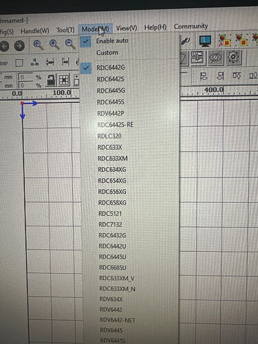

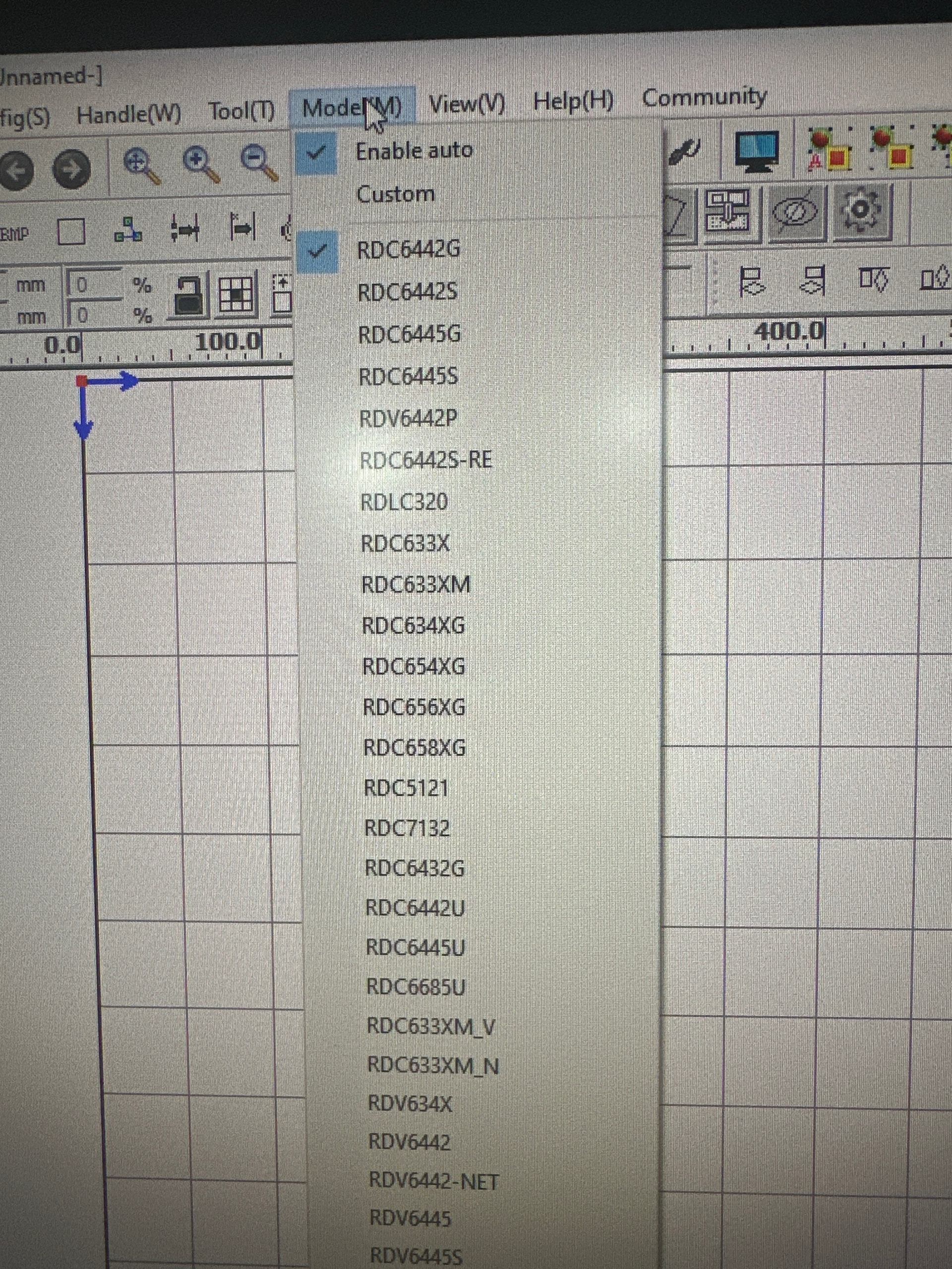

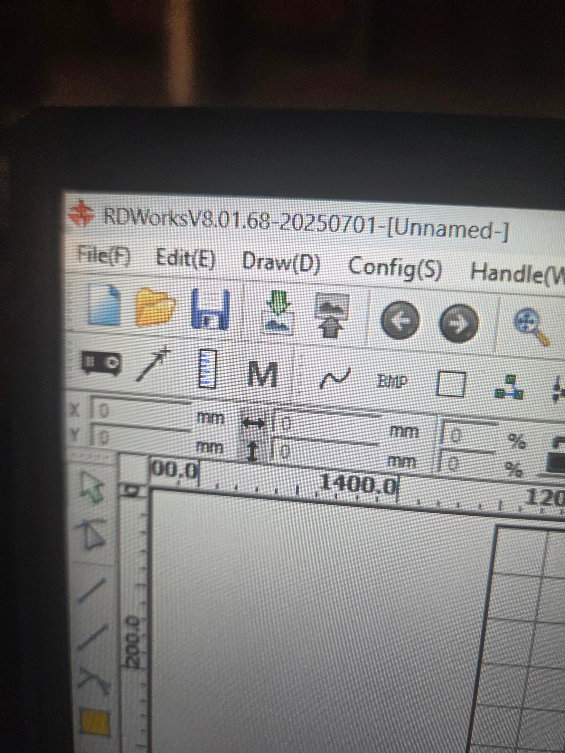

Hello , I found your post and I’m desperate looking for help with same model of ruida . No matter what I do I cannot connect ruida to my pc , usb or Ethernet directly to my pc , or via internet.
Already spend hours to try fixt this and nothing works, could you help me what you did and how did you fix it ?
My rdworks don’t even showing model of my ruida :person_shrugging:t3::man_facepalming:
Try updating the windows visual c++. Google update the windows visual c++ and follow the steps.
Read this thread very carefully, there is a problem when naming files and sending to the controller. You can try oz’s suggestion and email the results of the test. He requested.I haven’t gotten around to it, sorry oz.
Adam where did you found this software version version 8.01.68 for rdworks ?
The only version I can find is 8.01.65
And in my rdworks don’t even have my ruida model.
It’s on the splash screen of the controller, as you turn it onIt’s on, power on the controller, look at the control screen. Did the virtual c++ work? You also need the newest version of R. D works.
