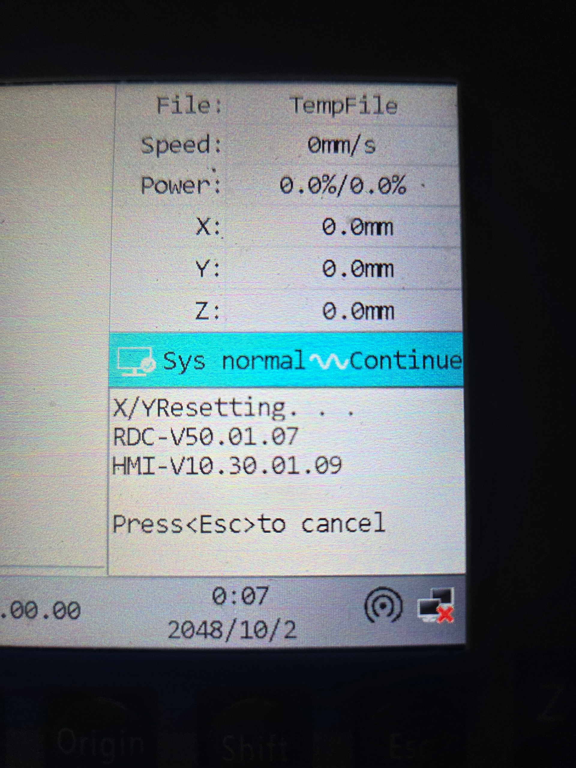

​The physical installation is complete, but I am hitting a total software communication block.
​Windows Device Manager proves I have a solid, healthy physical connection through the USB-B port. The assigned COM port shows up active and working perfectly with zero error flags.
​However, no software can actually talk to the board. Here is the exact progression of what I have installed and tried so far:
  • ​Fired up the physical USB connection, verified clean Device Manager enumeration, and installed standalone driver packages directly from Ruida’s site.
  • ​Attempted to download RDWorks directly from Ruida’s official website, but kept hitting dead 404 error pages.
  • ​Tracked down a mirror on FabCreator to successfully get standard RDWorks V8 installed. Running the USB port test failed immediately.
  • ​Installed RDWorks V8 Lite to test if the newer branch contained updated board definitions. The port test failed on that version as well.
  • ​Installed Mantisolo on my mobile to test alternative software routing. That works and lets me connect.It’s a crude version of RDworks but it does allow me to move the gantry remotely, score!
​Because the computer clearly sees the hardware on the COM bus, I am convinced this is a missing driver, an uninstalled dependency, or a protocol lockout specific to this new RDC8445S(EC) architecture.
​What specific driver package, dependency, or configuration step am I missing to make this controller accept a software handshake? I am completely out of ideas on where to look next.

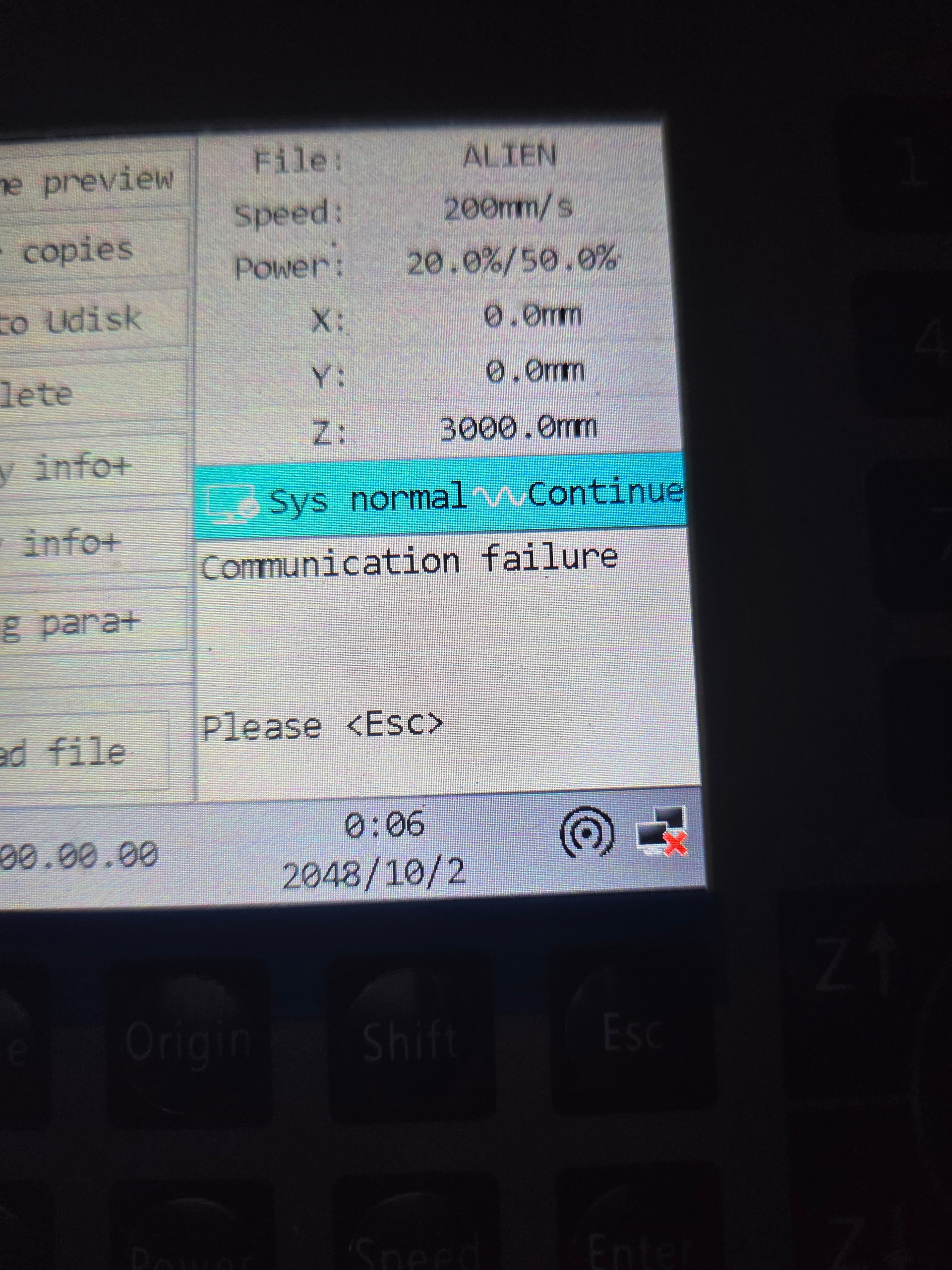

What does the error look like at the control panel? Send a pic please of the error if you see one.
Are files sent from RDWorks ok? If so, what happens if you start the same file from LightBurn using “Run RD File”?

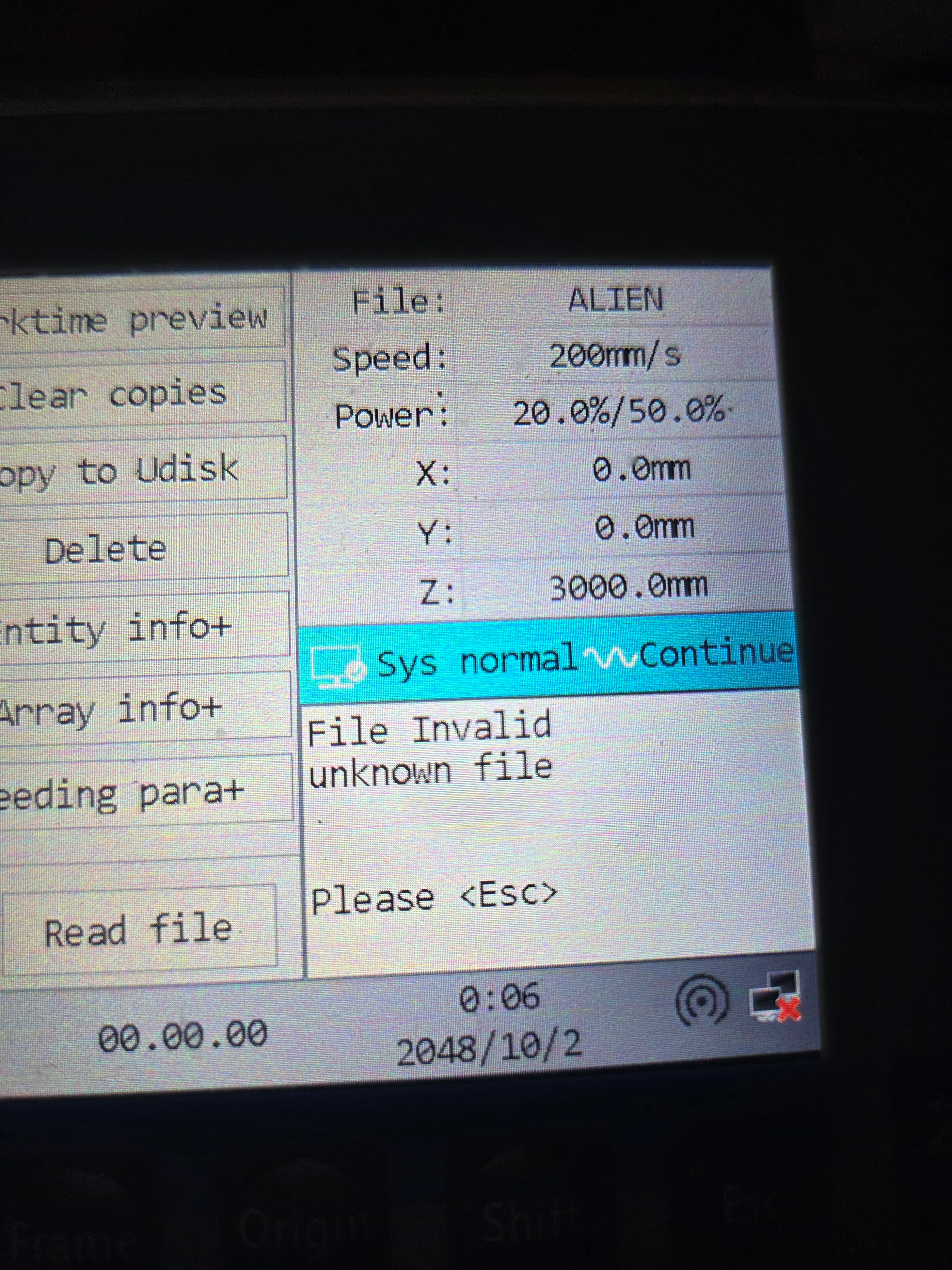

There are really no error codes are visual indicators of a problem. If I send a file from light burn, it acts as if the file transfer.It’s mostly successful although the the control board does not beep indicating receipt of file. Then if I press the file button on the controller, the file menu will appear populated the first time but I have no input controls. And then after about 5 seconds, I get a communication error. R d works files seem just fine, if I have a file from r d works and a file from light bur, the cursor will be free to move around until it touches the light burn file. Then I have communication error again. If the directional buttons, stop working, only escape allows you to continue to clear the corrupted file I have to read docs from Artie works to find the corrupted file and delete it. Once the file is deleted, normal operations

Regarding file corruption, limit your filename to standard characters, no punctuation or spaces and no longer than 8 characters … Good old MsDos standard… Oh and no suffix either… This is for doing the “Send” of a file via network - Lightburn will tack on the suffix during the upload to the Ruida… Step out of the old MsDos standard and chaos ensues…
Hope this helps…
