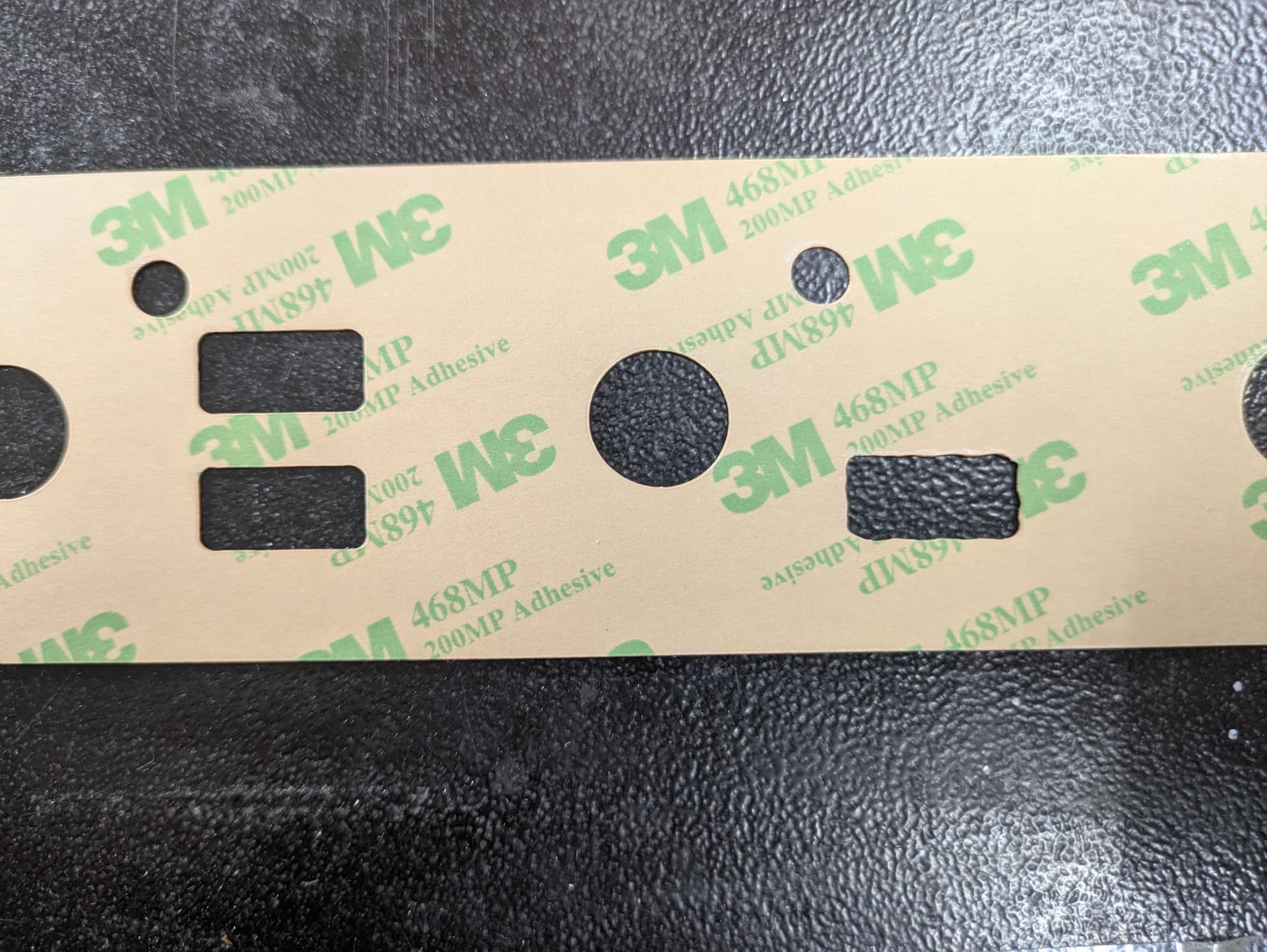

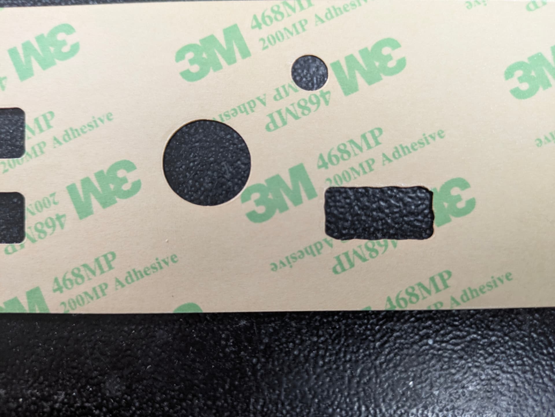

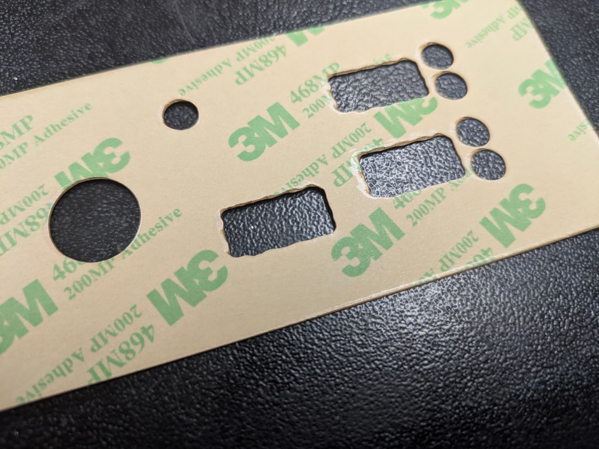

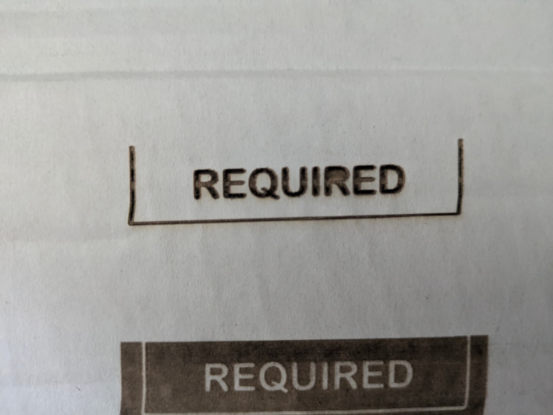

Hi guys, I need some help if someone may recognise the issue and what that may be.

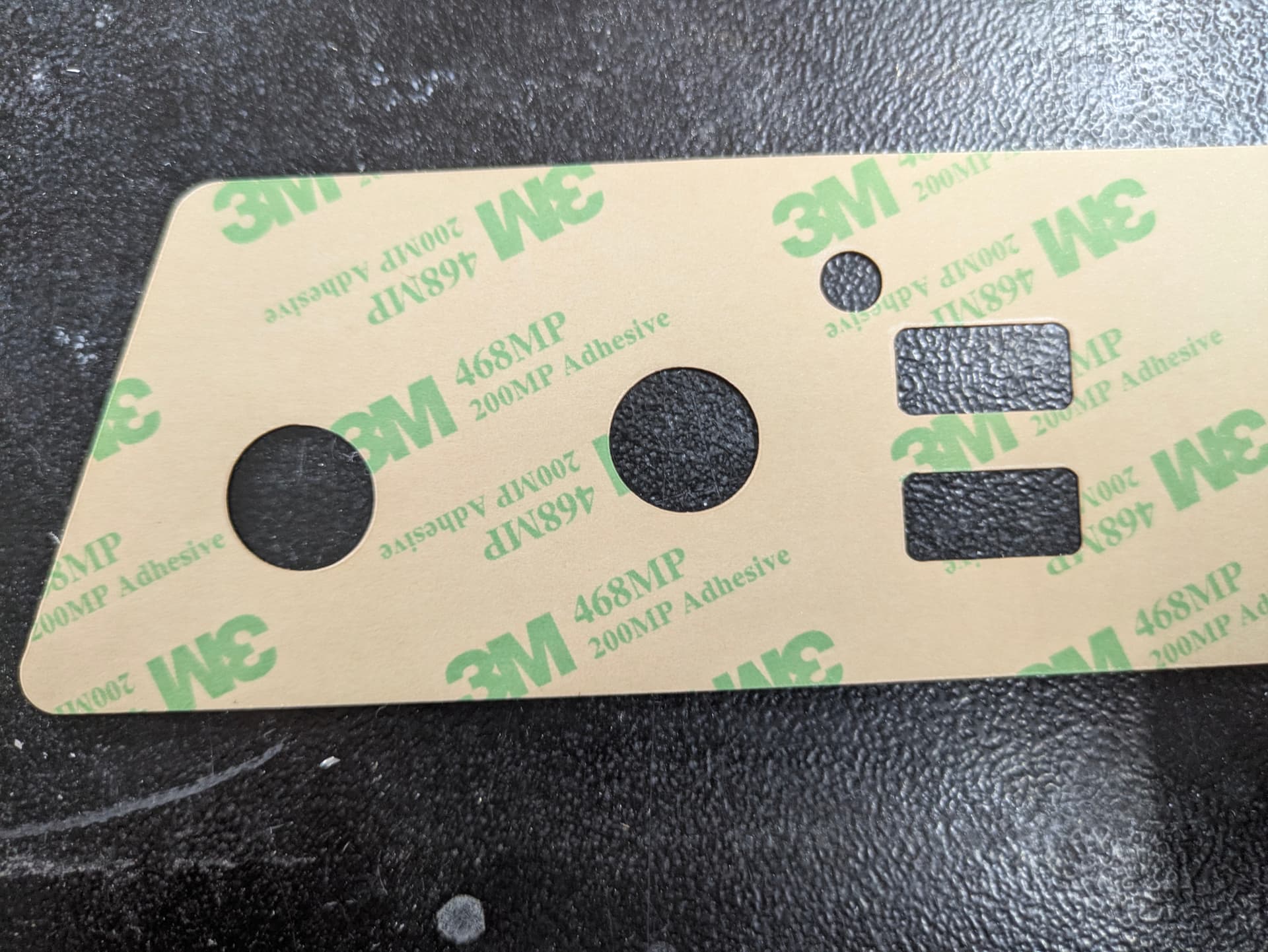

The machine I have is extremely old and I got it with some problems I didn’t know about, but after the replacement of belts and carriages on x and y linear rails I was happy how it was working for the things I do (mainly cutting thin adhesive films and some engraving here and there).

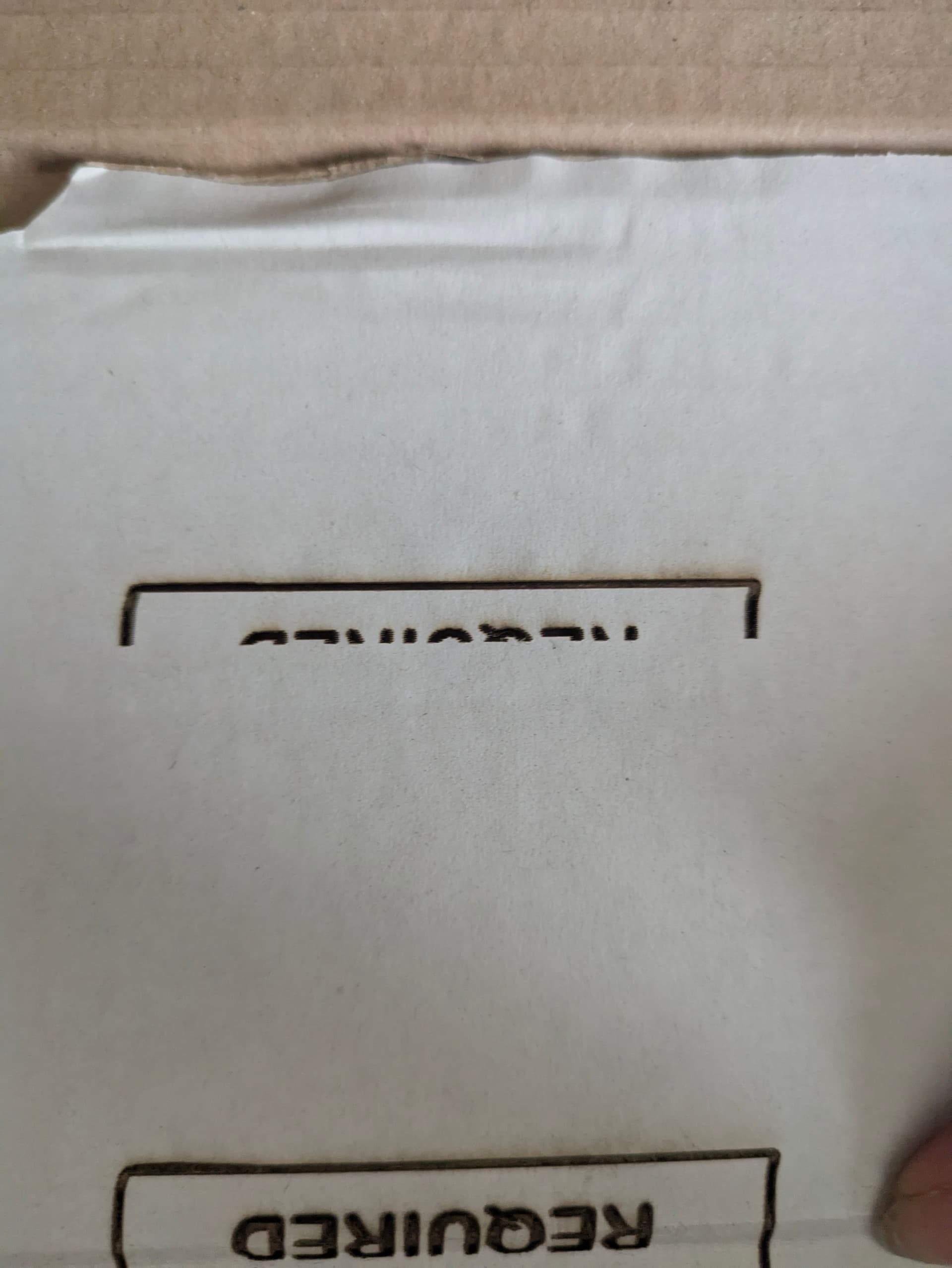

The machine was stationary for a while, and when I tried running a design it started behaving strangely, engraving design is “pulled” to the side. (The required design)
Then it gets better and I noticed that the behaviour is better or worse in different parts of the table.

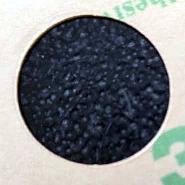

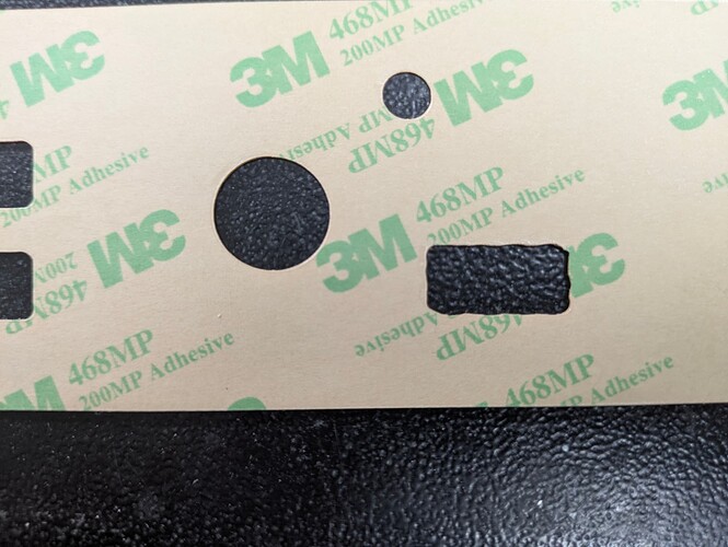

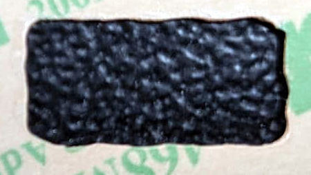

The other example is cut outs, the line is extremely wobbly, but then at the certain point it’s almost perfect. My first thought was to check belts and mirror alignment, but the tension seems to be ok. And considering the machine was stationary, I’m not sure what could possibly change.
Is there anything I cat try to troubleshoot this?
It is very likely a mechanical problem. Even though you write that you checked the belts for tension, the problem can be found either here or in the pulley itself. Start by checking if the small pinion screws have come loose, this is an often overlooked problem.

The wobbles in the rectangle suggest a loose laser head:
Other to check:
  • The focus lens is loose inside the head
  • A mirror lock ring has worked loose
  • The tube below the lens is loose
The flattening on the top and bottom of the circle suggest the Y axis has some very slight backlash:
Look for a slightly loose pulley / flex coupler screw, perhaps in the jack shaft across the back of the cabinet. Some machines have a small belt from the Y axis motor to the jack shaft that can be totally worn out without being visible.
That suggests a problem with the linear rails, perhaps being misadjusted or having a few loose screws along their length. A mechanical problem, like a bad bearing or a buildup of crud, can cause anything loose to rattle around, so the machine may have multiple problems contributing to the visible symptoms.
To some extent, cutting at relatively high speeds will show off even the slightest instability. These tests at various speeds show a reasonably tight machine can still have small wobbles:
