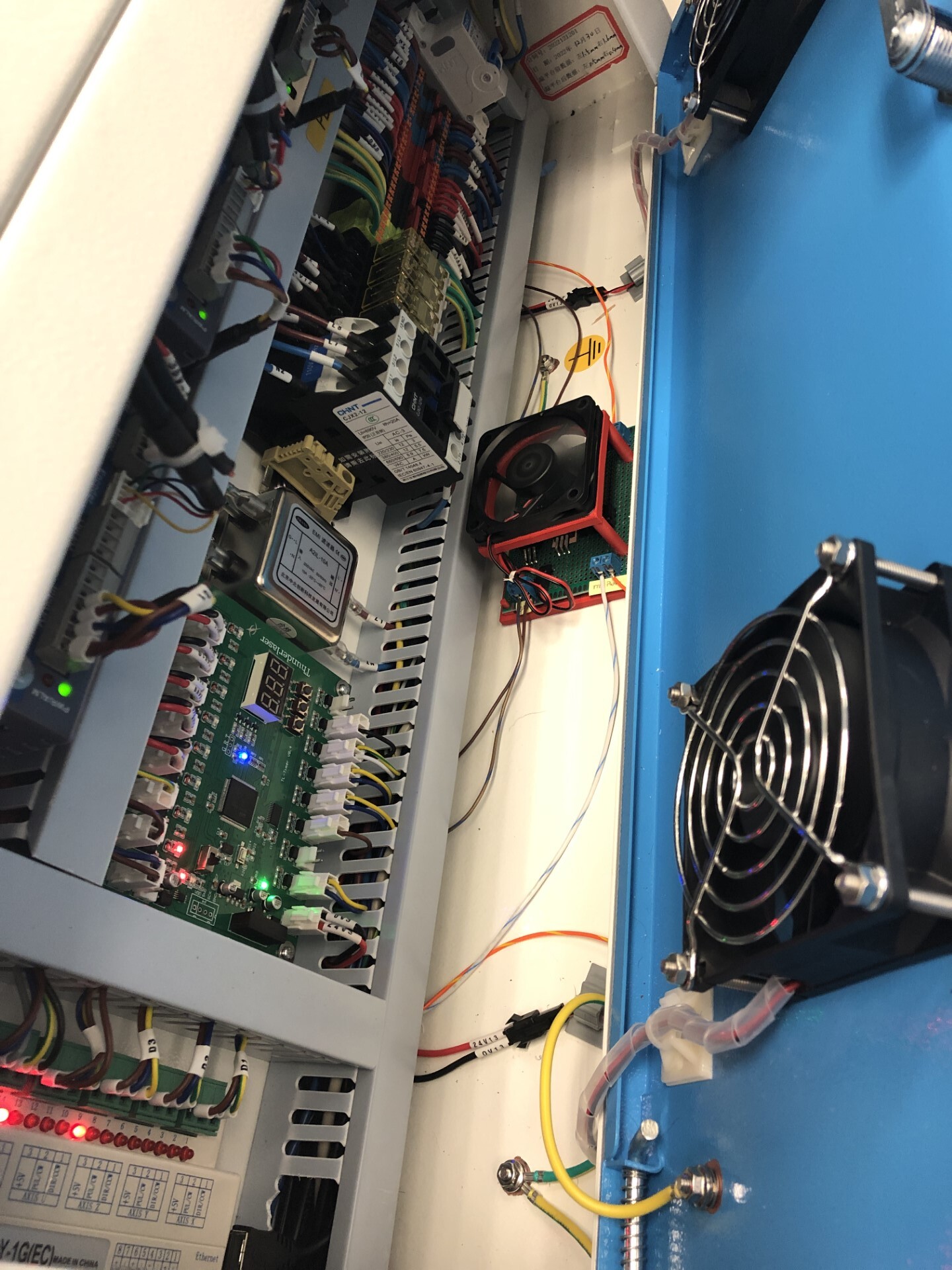

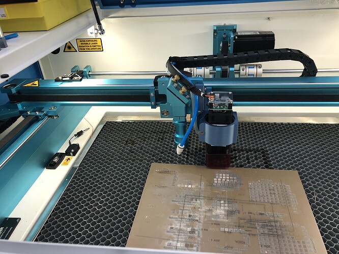

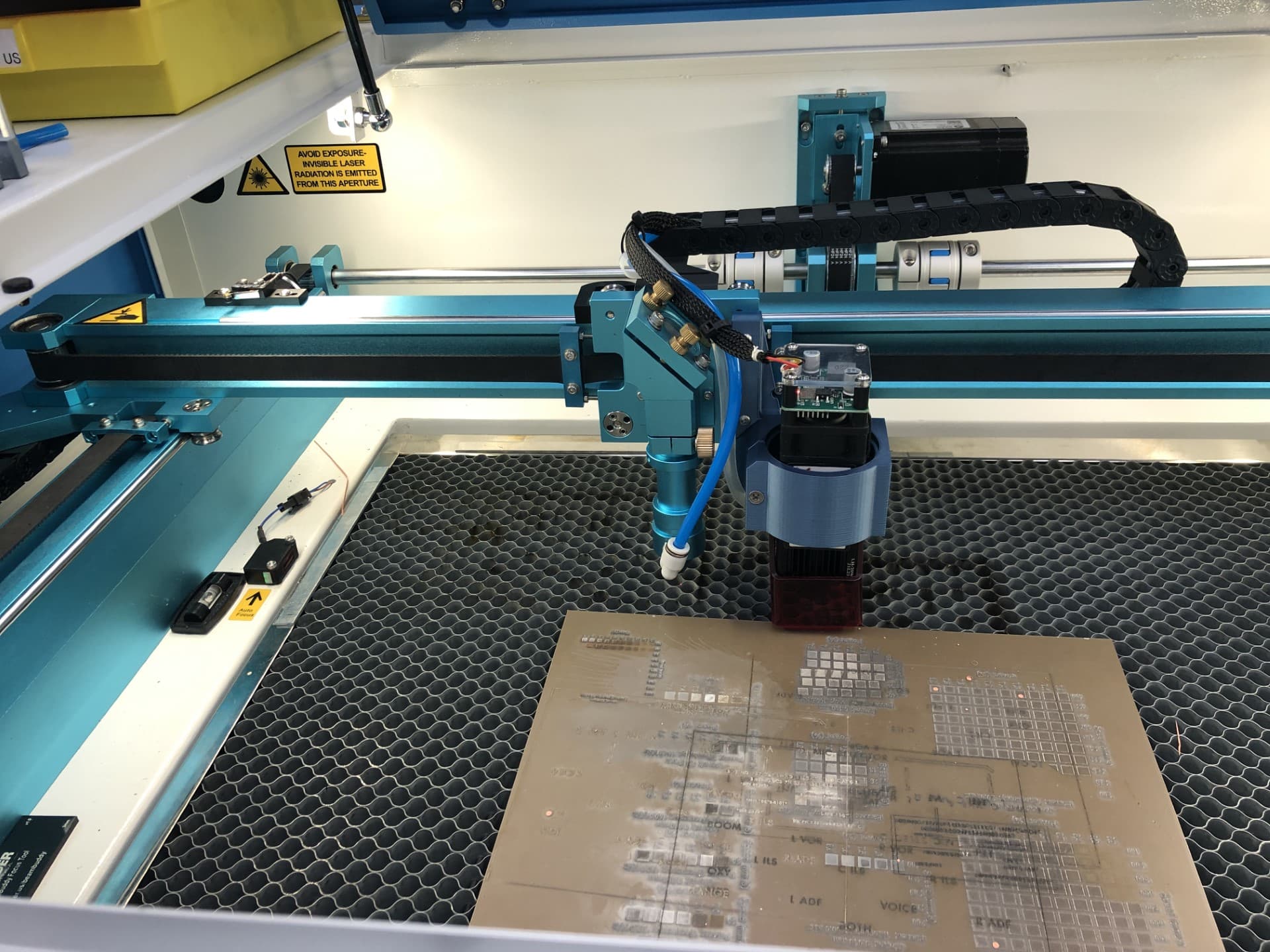

Sure can here is the new head all mounted up and the interface card mounted with a cooling fan.
Excellent… thanks so much for the photo… I love seeing these…
What does the Thunder laser board do, that is between the EMI filter and the Ruida?
It a timer control board. Its used to time the Air assist, compressor and vent fan.
Thanks… Rather a large board…
