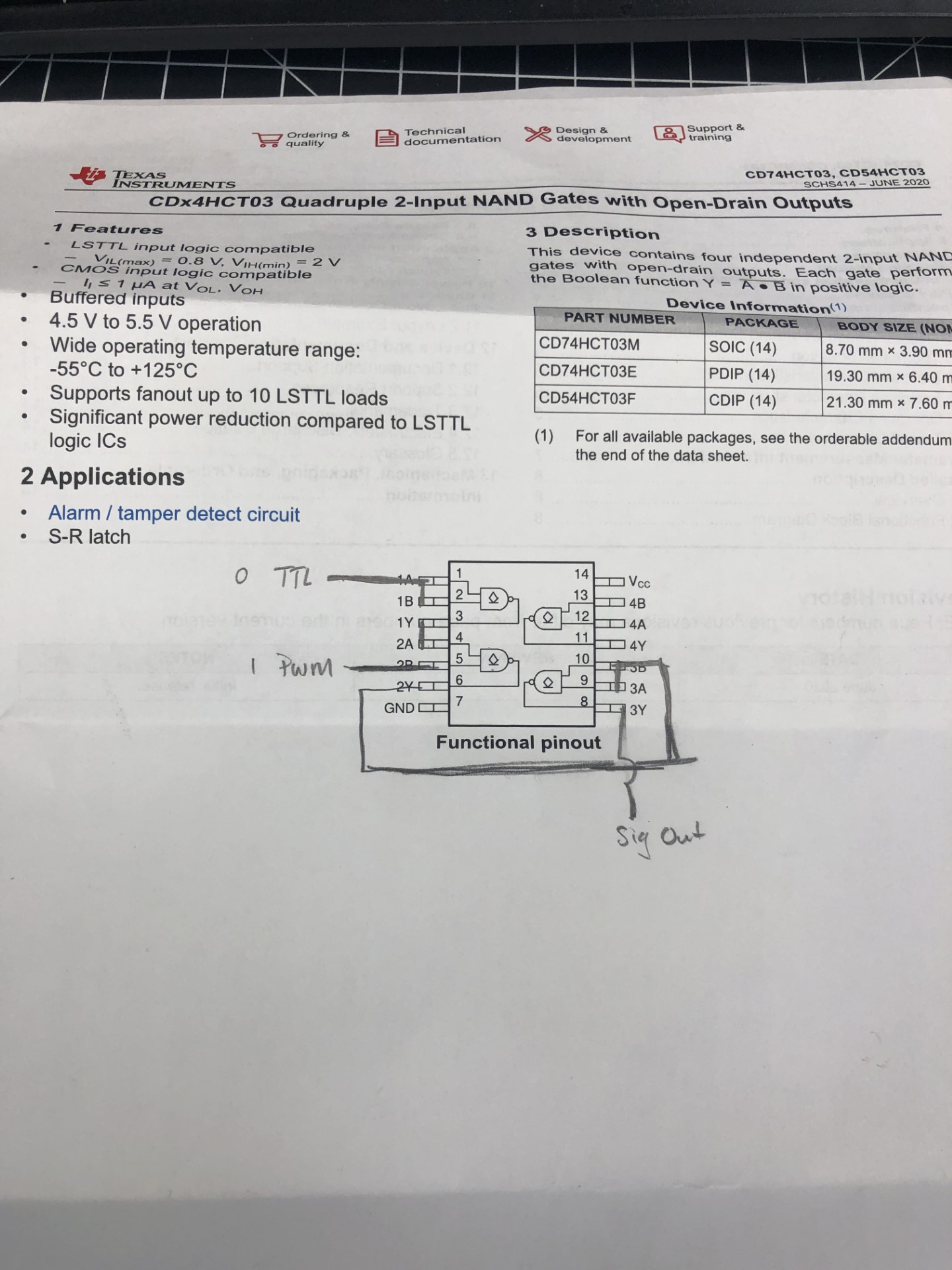

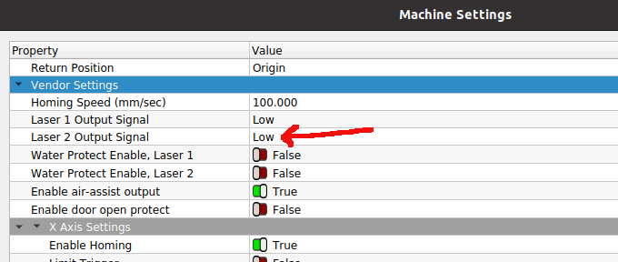

Okay, I built a gate circuit using 3 NAND’s and no luck. I tried changing the machine settings (Glass Tube, RF (with pre-ignition), RF (w/o pre-ignition). I tried laser output signal under vendor settings (Low and High) as well with no change. The diode is firing when I manually move the gantry and nothing when I start a cut. Is the pullup resistor necessary for the TTL signal to be present going into the gates. ?

So I should keep the LB setting to glass tube and signal low?

Now that I look at the data sheet, you’re using an HCT03 with open drain gates, so you must also supply pullups on their outputs.
It would be better to use a standard 74x00 NAND with totem-pole outputs, with solid logic levels and decent drive capability.
I put 4.7k pullups on each of the outputs and its not gating the laser. Turns on and stays on during a cut when the output signal is HIGH under vendor settings and nothing from the laser when the output is set LOW. Are there any settings I should check in LB?

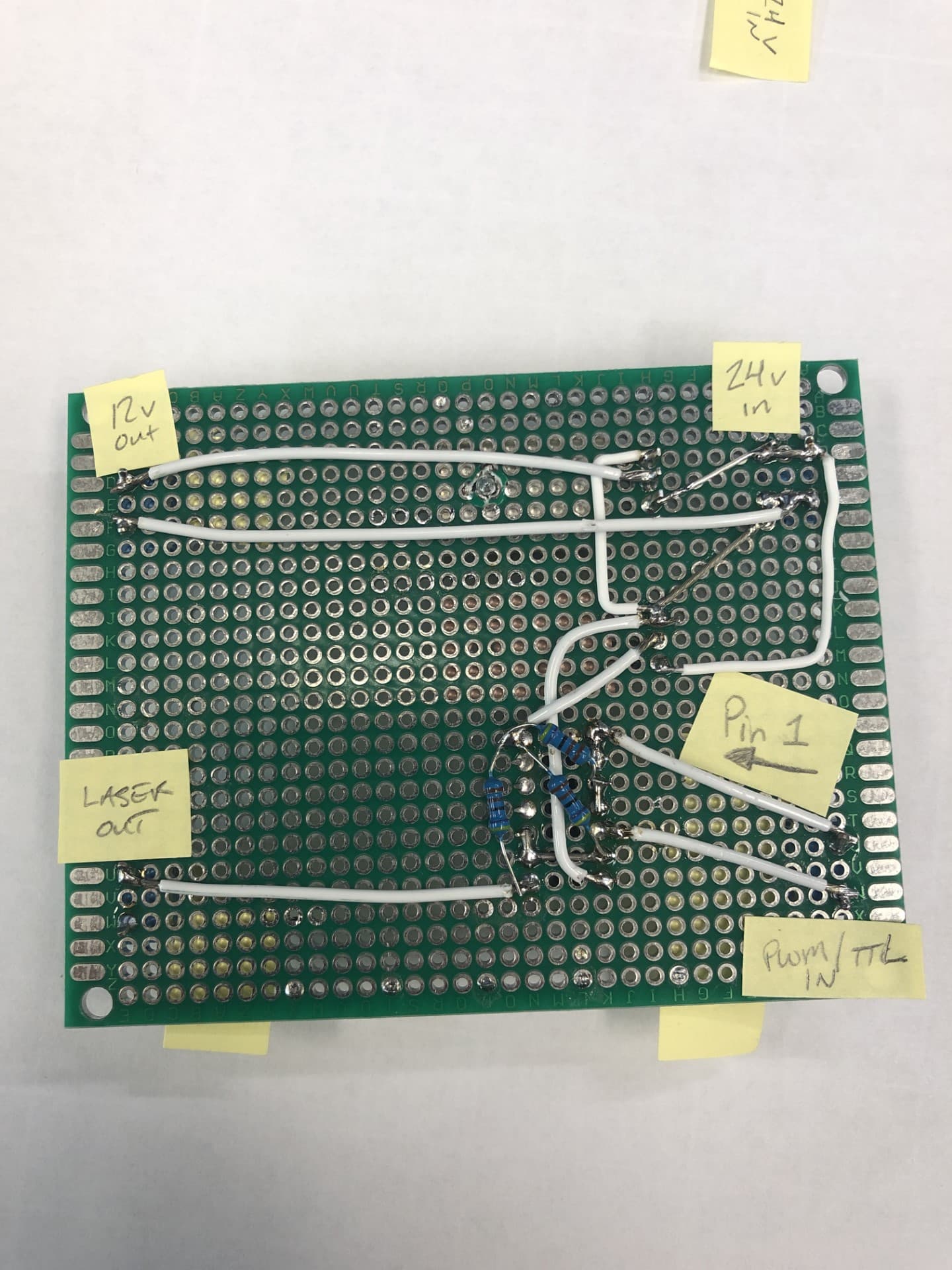

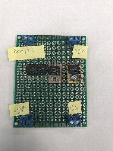

I have a dedicated 5v voltage regulator (LT1086IT-5) going to the HCT03
Put it on the bench and manually pull the input signals where they should be, to ground or to 5V… the output should reflect the correct logical operation…
You can manually do every step with this and correct it before it moves to the real world (Ruida).
Do you have a photo you can post of this diy chip/build?
