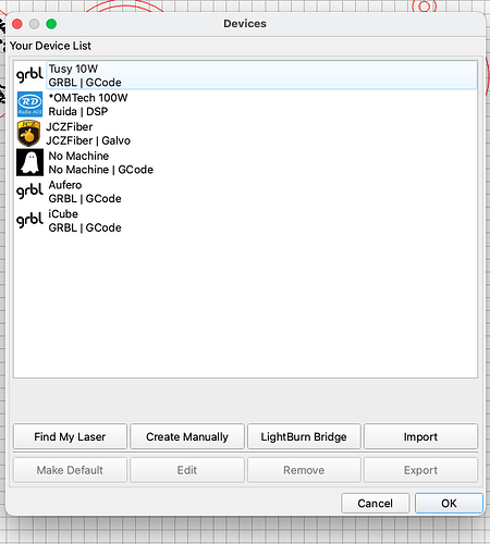

I commute from home to the RUIDA co2 Laser at a maker space called QueLab. I am unable to show Ruida as the laser I use on my home computer where I do 90% of my prep work. I tried exporting the Ruida laser from the Lab computer (Laser Tools>Manage Devices>Export) to a thumb drive and Import it into my computer (Windows 11 up to date), . (Laser Tools>Manage Devices>Import). I am sorry but I do not have the Labs LIghtBurn .version number (Close to 1.0.6, IM not sure)

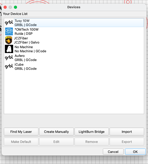

You can certainly set up a ruida laser in Lightburn and not connect to it. It works fine. Click Devices and select create manually and enter the parameters that match the machine in the makerspace.
I only have 1 laser actually connected to this computer but have several devices set up.
Thanks for your reply. I figured out how to change the inch/mm settings and that worked.
