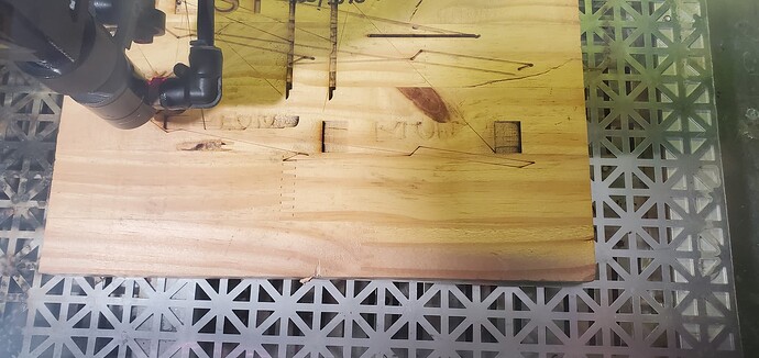

Hello! You guys have helped me tremendously over the years just learning this machine, and lasering in general, i am hoping you guys can figure this out for me too!!
A few weeks ago i tried engraving a ss tumber which winded up engraving severely skewed. I read, watched lots of videos, tried everything, and nothing worked. So i moved onto a flat piece. This has not been working either. The machine is engraving all the transversal moves, and not the object i want engraved (sort of like its engraving the negative, but offset). I use LB but tried rdworks to see if its a software problem and its doing it there too. I wrote the factory settings back to the controller and its still doing it.i will also mention when i was messing with the tumblers it appeared that the machine was sporatically firing. Now its firing all the time, just not where its supposed to. Also when i hit frame at the machine it fires, which is where the box on the glass came from, but framing using the software works fine. Up until i tried the tumbler last month everything worked fine. Also the last attempt i made caused the machine to start engraving front to back instead of left to right with no changes to initiate that. I have a ruida controller. 50w blue chinese laser. The preview is correct. Could all these problems be caused by the power supply?

It looks like the machine is being controlled properly… i.e. it appears to follow the right path. I’d suspect the lps.
Hi! Thank you for this info. I unplugged the connector that appears to be the control signal, and it did not fire. I plugged it back in and its still doing the same thing. So I should just buy an lps at this point then you think right? Thanks again for the help!
Let me add here…i just ran a file in line only mode, and it did the sporratic firing (the lines u see in the photo). So, none of the functions are working right; line causes these lines and fill engraves the opposite of what it should.

Well Jack, i have some great news. Its all fixed now-after i spent hours reading, checking wires, taking everything apart, etc.-i found the issue. So when i was going through machine settings when the tumbler issue came up, i changed the laser to high power in the vendor settings, because i thought i read somewhere my unit was set to fire hire power. I did re-write the settings to factory earlier in my steps like i said before poating here, but apparently vendor settings do not get changed. So once i manually went in and changed it back to low, everything is back to normal!!! Yay!!! This is why i shouldnt mess with vendor settings lol!!! Thanks so much for the help!!! It was a great learning experience!!
