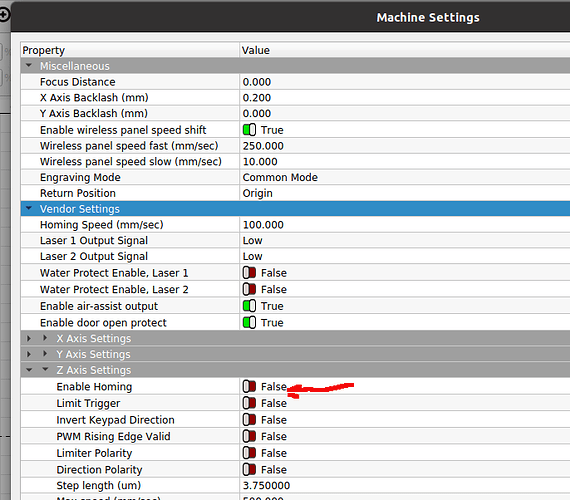

Z- is typical, since the laser head is “moving down” as the platform moves up.
Edit > Machine Settings > Vendor Settings > Z Axis Settings > Direction Polarity (toggle)
Acting as a limit switch the whole time is the default behaviour as far as I am aware, as long as this setting is enabled: Edit > Machine Settings > Vendor Settings > Z Axis Settings > Limit Trigger

1.I tried to reset the controller, and it homes X/Y but not Z. Z-distance was set to 3000mm after reset.
“Enable homing” was green under Vendor settings.
2.I tried to switch Direction Polarity, but the bed still only goes up. It did however switch the buttons on the controller that controlls Z-movement.

This has to be enabled within the Ruida… Each axes can be enabled or disabled for a home operation. Did you enable the Z axes home?
It it’s not enabled, I would expect the Ruida to ignore it.
If you did this on a working machine, it should fail.

The ”Enable homing” is indeed enabled for z-axis.

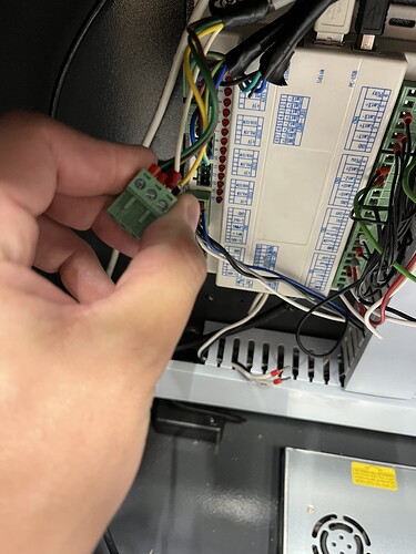

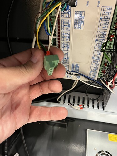

Thanks everyone! The issue is a glitchy Z-axis contact on the ruida controller. Most likely the contact on the controller, rather the connector on the cable.
But it is worth to try change the cable connector first I believe.
Do anyone know the name of the connector?
Somebody finally traced the problem down to a completely missing contact inside the cable connector: no guts!
May yours be as simple to fix …
As the saying goes, “Phoenix. Phoenix Connector”:
https://www.amazon.com/s?k=phoenix+connector
CAUTION They come in both hard metric (5 mm) and quasi-inch (5.08 mm) spacing that matter in blocks of two or more, plus 3.5 mm (and likely other) variations. Trust, but verify!
I got these from Amazon, and they work fine with the Ruida and also the motor drivers…
Motor drivers are usually 6pin, but sometimes are 4pin + 2pin, whereas the Ruida is usually built with 6pin or 4pin + 2pin connectors…
