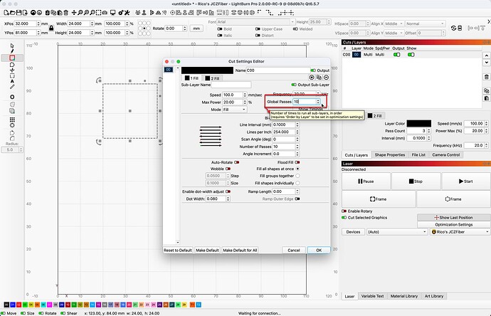

Is there a way to run, say, a simple fill shape engraving of 100 passes with a cleanup pass every 10 passes, without creating 10 engraving layers with a cleanup layer in between each?
Enable this setting to repeat all Sub-Layers in the layer, in sequence, the specified number of times.
I would consider a single layer with 10 passes and a Cleanup pass(es) set on a Sub-layer, then set Global Passes to 10.
