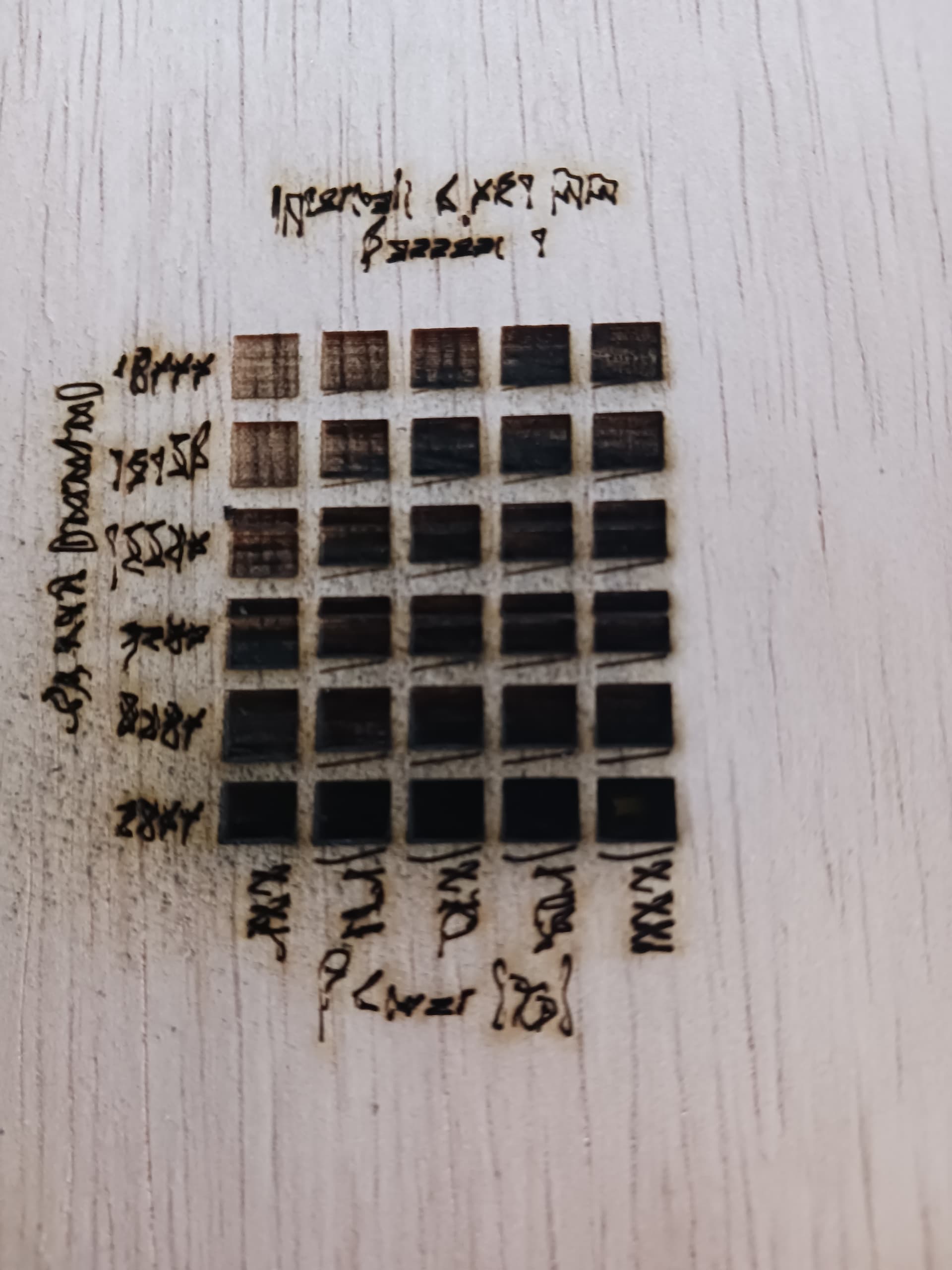

Ive been trying to work with lightburn for a couple of weeks, but I’ve had some on going issues. One of which is im trying to run a materal test and i cant exactly get my results to come out clear. Ive tried to adjust my line interval and lines per inch which was suggested from a similar forum post. However. It never changed much. Any ideas?
Check belt tension and excentric nuts
Whom are you targeting here? Anyone in particular? ![]()
You may want to confirm that you’re working in mm per minute or inches per minute and your chosen engrave speeds are within range of the capability of the engraver.
If you’d like to share a screen capture of your material test settings, the following link may be of service.
