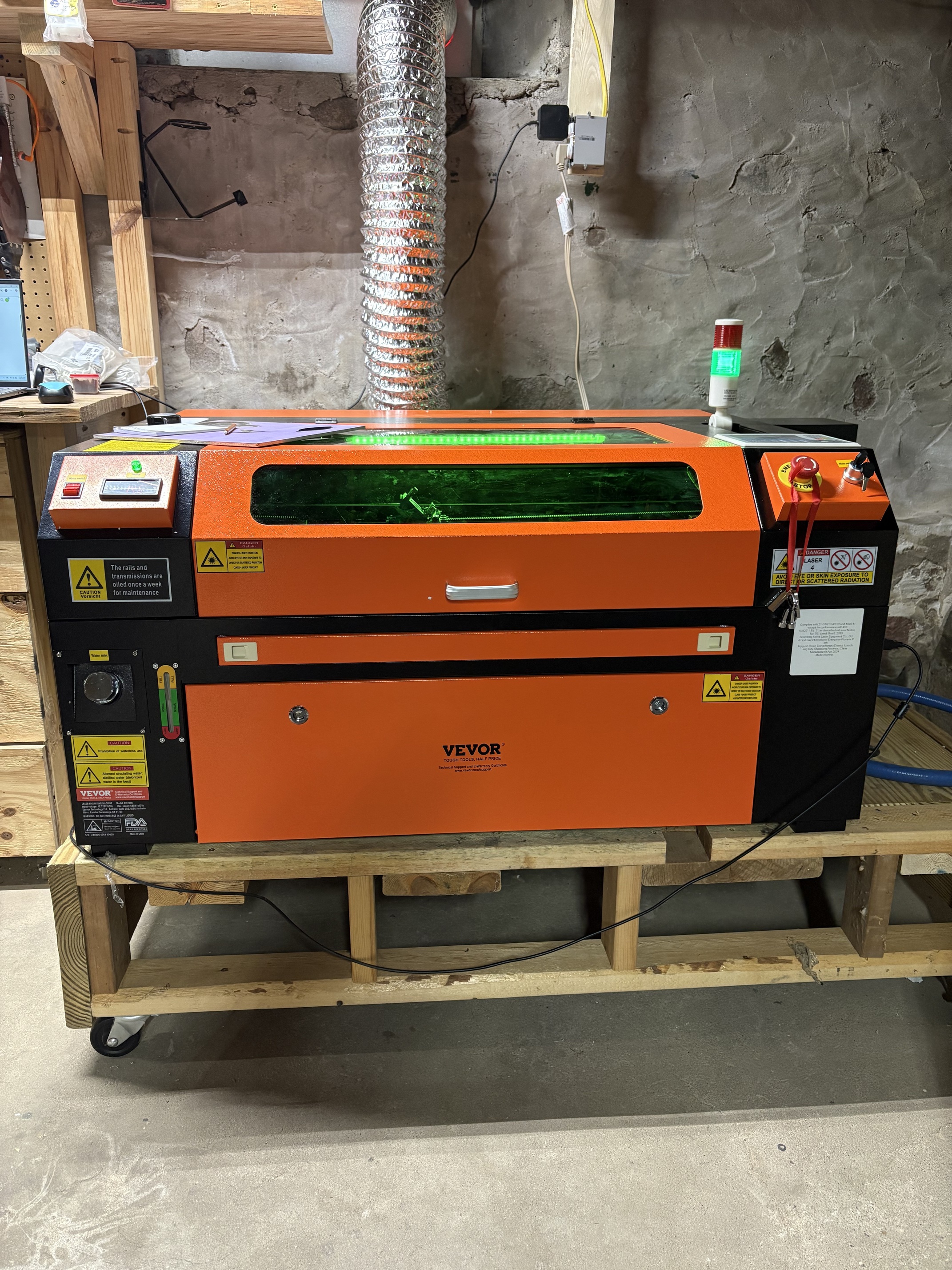

Hi just purchased a new VEVOR 80 watt co2 laser , hooked up to lightburn (having been on lightburn for a while) , lightburn told me I need to upgrade so I did , now it frames and does material testing just fine but when I drag image on to lightburn and go to run it , it runs but won’t fire , but when I click on default on the settings screen, it will fire but to ruida settings, I have no control on power a speed settings
I’m lost :disappointed_face:

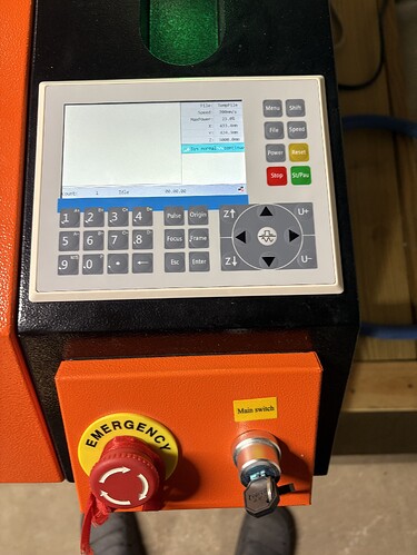

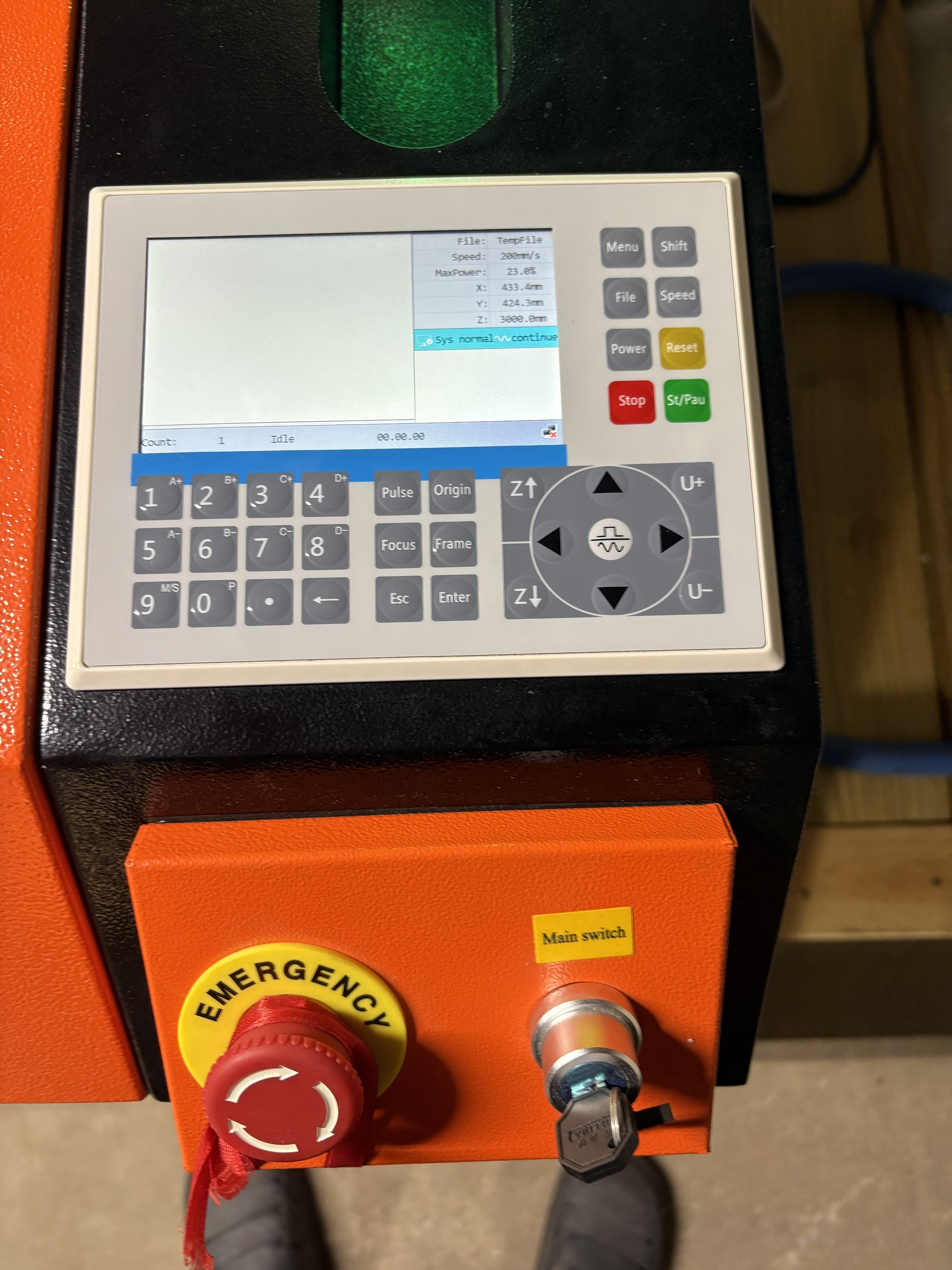

Have you set the power and speed on the layer and it’s isn’t making it to the Ruida? If you send the file to the Ruida and open it there, does it have the correct values in the parameters?
What values for speed and power are you attempting to use?

Nice and big machine. Can you see if there is a standard test file in the controller?, if so, could you test it.
When you write “no control over power”…, does that mean that you can’t make a small square with fill e.g. 200mm/s and 20% power, option for this layer and run it?
