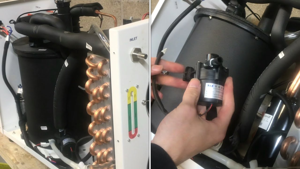

What does the E7 error mean and how can it be solved?
From manufacturer specs
E1 - ultra-high ambient temperature
E2 - ultra-high water temperature
E3 - ultra-low water temperature
E4 - room temperature sensor failure
E5 - water temperature sensor failure
E6 - external alarm input
E7 - water flow alarm input
So either the water flow sensor on the input is faulty or you do not have pump going?
Where did you get these?
I found the chiller and the smart temperature controller manual and they all only went to E6…?
@starchim01 do you have the chiller wired to your laser to detect a circulation failure?
I would think the laser would have stopped if this is a circulation error…

Additionally from checking youtube
Tons of “pump” replacement videos
Although no specific E7 error
So i am thinking this might be a common(ish) problem.
Just guess estimating though
If it is indeed a flow error, a common cause is a crushed or kinked tube.
