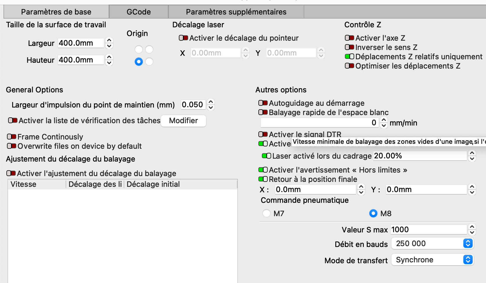

Hello, my laser don’t switch on, when I’m launch my cut. Some one tell me there missing the S on my G1 command. I check this option but my Gcode stay without the S.

Thanks
What is this set to in device settings?
255 but I have no light at all.
Edit, same result with 1000.
Enter $$ in console and paste output.
$$ is not recognized the my parameters :
Are you using inline?
I haven’t this option, so I write in “start gcode”
