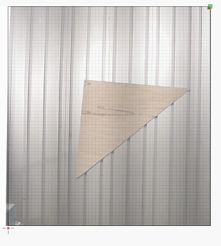

and right now it will show my laser position on the screen opposite of what it is on the machine. right now its in the left rear corner and on the screen it shows the laser in the bottom right corner of the grid

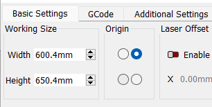

What is showing you this? Can you confirm that you set your machine origin to bottom left in Device Settings? If not, can you make that change? Your machine origin is intended to be bottom left. The fact that it homes right back is a little unusual but not a problem.

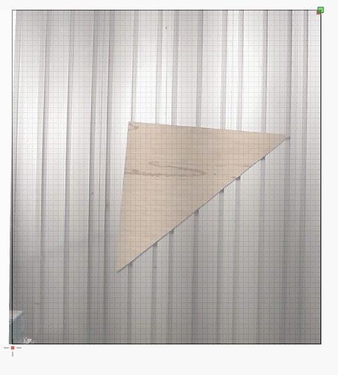

so the origin is in the upper right i think at least that is how i look at it and the second screen shot shows my laser in the bottom left of the screen and origin in the top right. and as i am typing this I realize that the screen is set like i am standing behind my machine the laser position is in the lower left of the screen and would be the same if i was on the stepper motor side of the machine

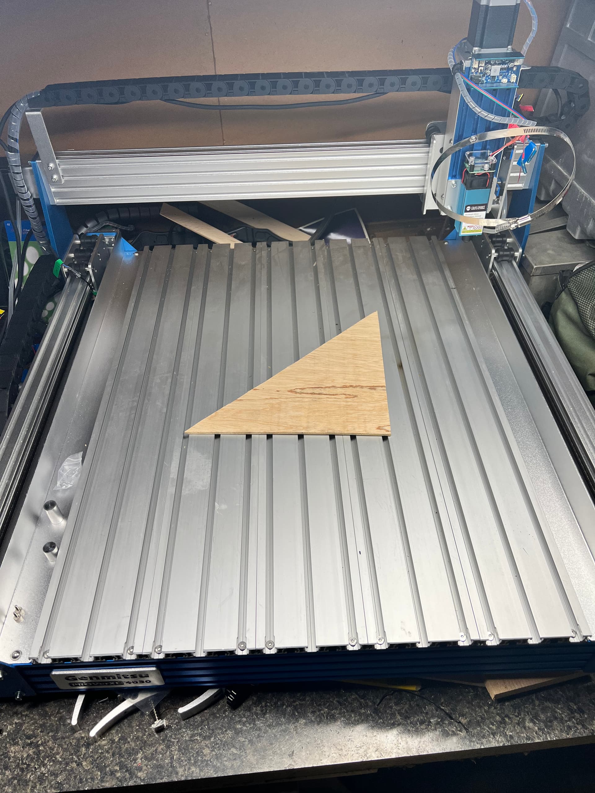

Can you take a photo of your machine from your perspective with the laser homed? If you can leave the triangle on the bed that will help me orient.

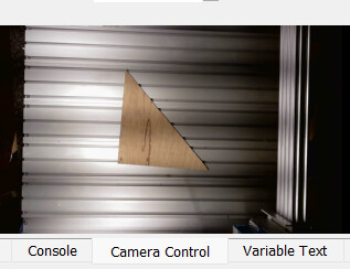

everything is exactly the same as the photo I sent earlier i didnt move the triangle on the bed. the second shows the camera view home is in the bottom right corner of that image.
Okay thanks. I think that makes sense…
Switch the origin in Device Settings to the lower-left dot. Opposite of what you have now. This should get everything oriented correctly.
well that worked everything is up and running as it should I have the camera set up and it is working as it should as well now thank you for all your help on this one.
