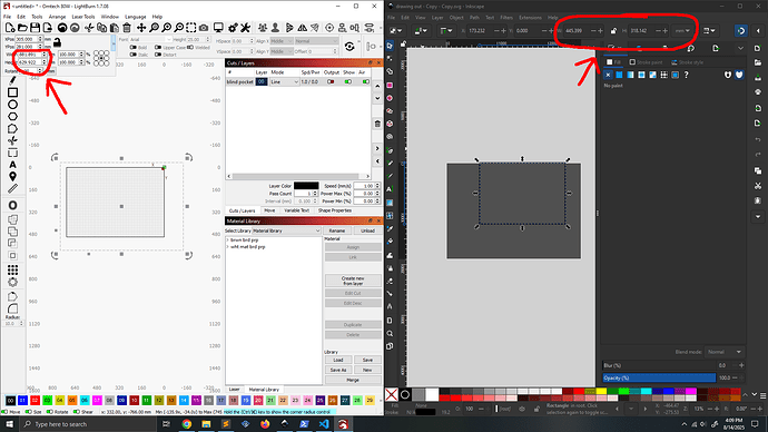

The attached svg file has a single rectangle. When opened in Inkscape, it says the rectangle is 445mm x 318mm. When opened in lightburn, it says the rectangle is 881mm x 629mm. I THINK the discrepancy is caused by the svg document’s viewbox and width/height not matching. And I THINK the error is on lightburn’s side and not Inkscape’s? Am I correct on this?

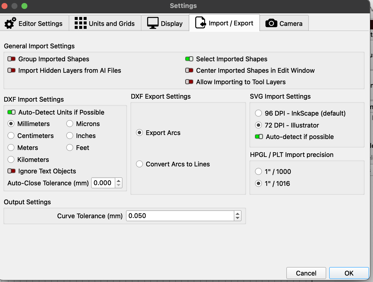

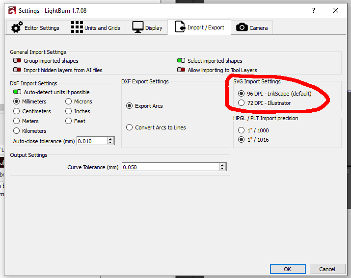

In the Settings Menu (Gears icon) Import Tab, check if you are set for Inkscape or Illustrator.
Import settings were already set to Inkscape.
Good to know that this is a setting though.
Was this created in Inkscape or Lightburn?
I opened it in Lightburn with my Illustrator setting and it was even larger. I switched to Inkscape and it opened at the 881 size same as you.

I was able to confirm the discrepancy between inkscape and lighburn is caused by the values in the svg document’s viewBox. Inkscape sets scale based on height, and lightburn sets scale based on width.
I was going to submit a bug report but after playing with this online tool I’ve realized the svg file specification itself is the issue. If the aspect ratio of a document’s width/height and viewBox dont match, it is ambiguous what the file is supposed to mean in a physical sense.
