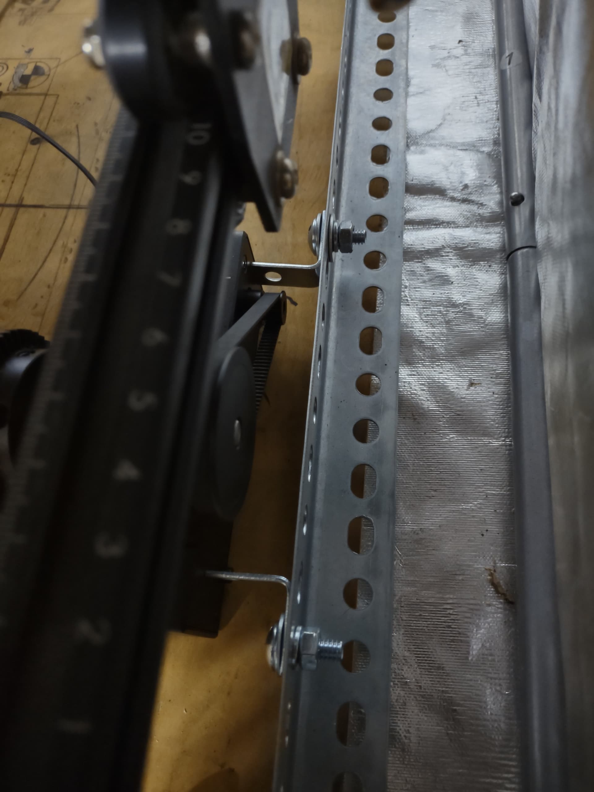

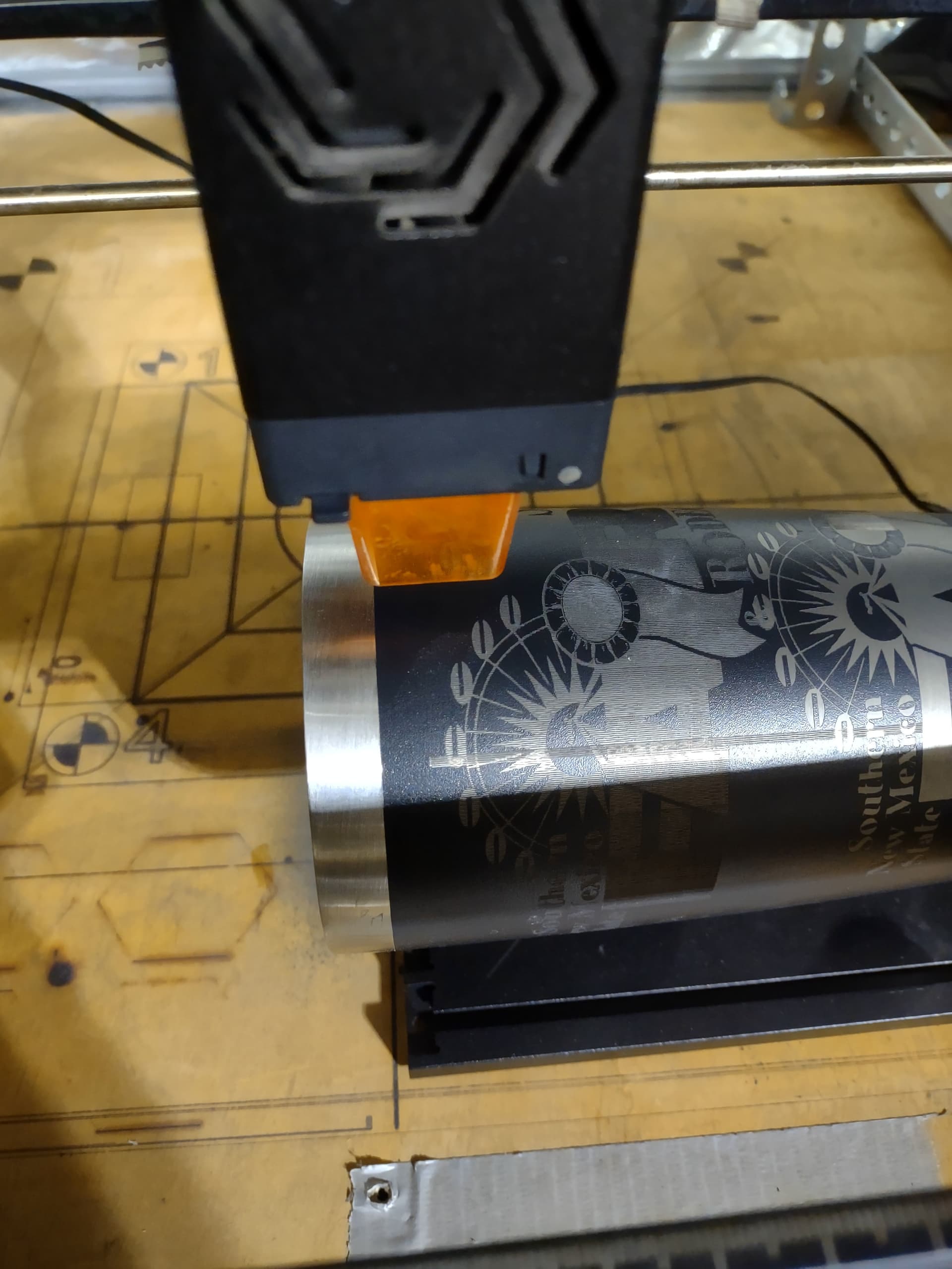

I too am swapping back and forth from rotary to flat plane work. I quick fabbed a jig to make sure the base of the rotary is square to the frame. I have a small orange flange on the bottom of the laser. I line that up with the edge of the plastic coating on the cup (or on this project, aligned with the top edge of the leather patch) and it gives a consistent alignment guide that is easy to see when I use the square “frame” key. I use this command to drive the laser from HOME to the work piece. I set the end job position to just move the laser far enough to get it out of the way to put a new cup in the jig.
Repeatable metric
simple square jig
