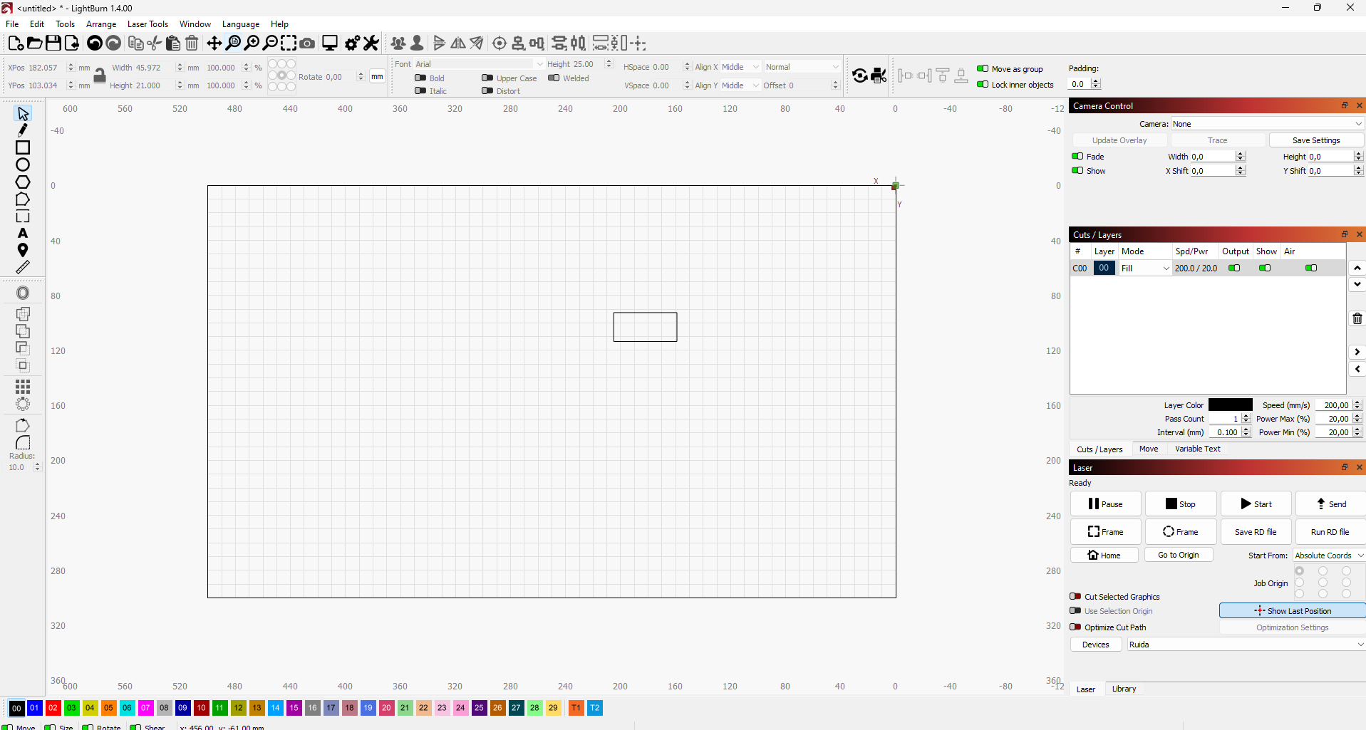

Hi,
I have some noname 500x300 40w laser. It wasn’t running for half a year, but it was working back then no problem.
When I save file it’s Blank no metter what. Laser also see it white as snow.
Engraver can be moved via PC (ethernet) and check frame no problem but when I send file or try to start nothing happens
Laser is in ready state. I tried reinstaling cleaning logs deafult settings nothing works and I don’t know why.
Laser is working with old files that are inside controler.
Enno

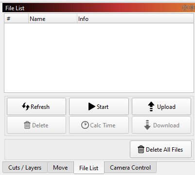

Although the Ruida is great for controlling a laser, some of it’s other functions are questionable.
Such as when it runs low on memory. They do all kinds of strange things. I’d suggest you delete some of your previous file from it’s memory…
You can save them to a U-Disk, but if you have the source you can re-create them.

When I create a circle and send it to the laser, the laser doesn’t see anything in preview in laser screen.
Also, I tried RDworks and it works normally, so I think it’s Semang in lightburn settings.

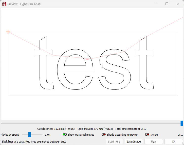

This ii what inside.
Simulation also works

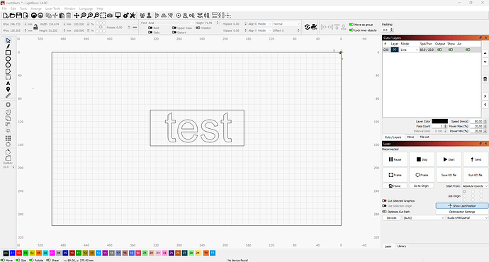

and there is file itself
test.lbrn2 (16,4 KB)

You have a tiny rectangle out here:
That could be causing issues for you, depending on which controller you have.
Otherwise I don’t see any specific issues with your file.
Turn on Window > File List, then look in the File List window to see how many files you have in your controller. If you store things there regularly you might need to delete some.
