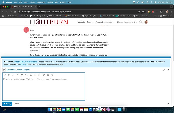

When I want to use a file I get a Shorter list of files with OPEN file than if I were to use IMPORT file..How come!
Also, I renamed and saved an image file yesterday after getting much improved settings results. I saved it…‘File save as’. then I was shutting down and I was asked if I wanted to Save or Discard, So I pressed discard as I did not want to get in a saving loop. I could not find it today after powering on.
Ps Is there a way to get more room in the/this typing window. I get three lines on my phone, but only one on my laptop.

Hover your mouse over the blue bar. Your cursor will change and you can drag it up as far as you want to.
Ah, excellent Tim..The narrow window was really cramping my style.
