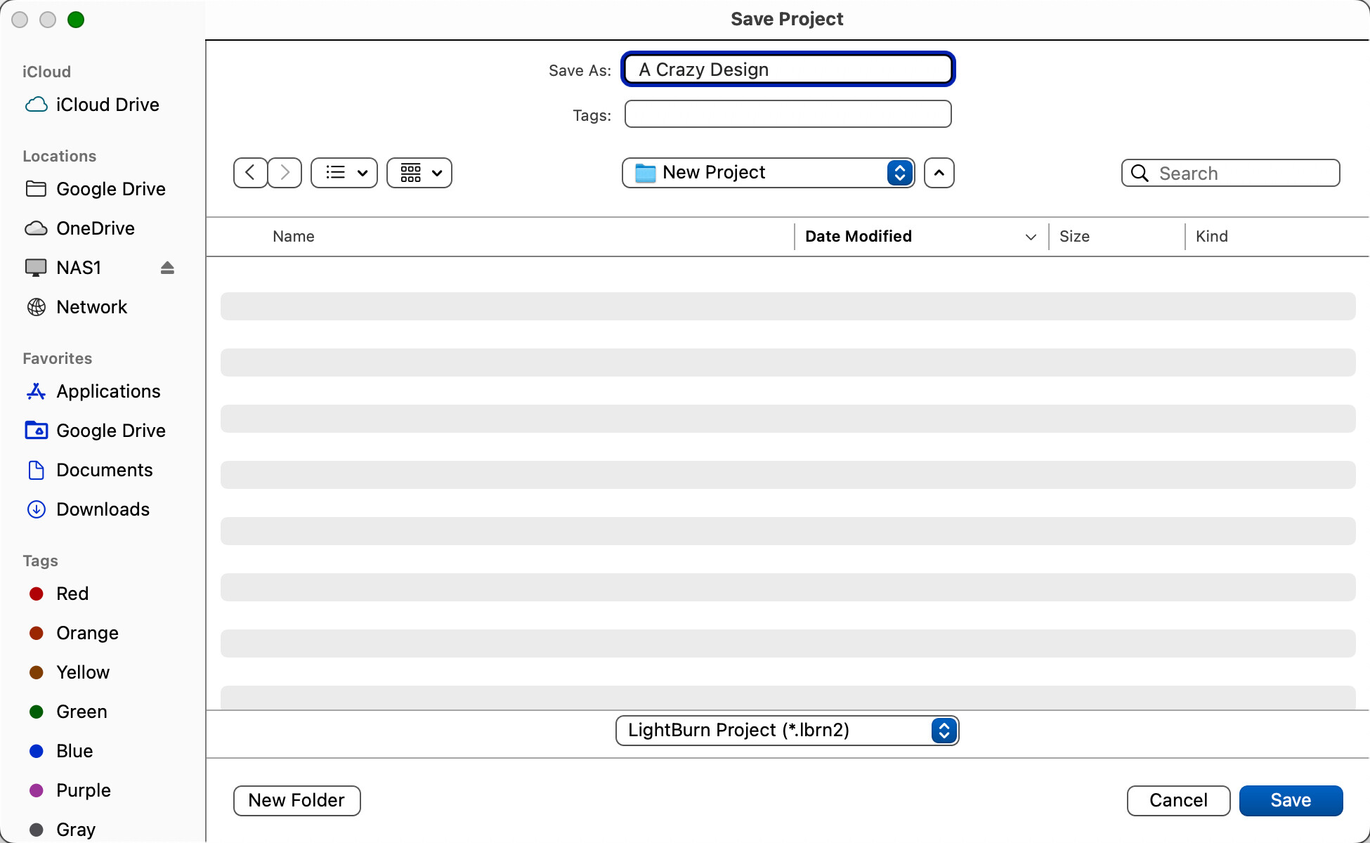

Art Libraries are different than working designs. When you save a new design a window will appear asking where to save the file and what to name the file.
Like so.
I use a Mac. If you use Windows your screen will look different.
If you’re working on an existing design and save it, the name and location are already known so Lightburn saves the file where it was.
If you use the “Save As” option, you’ll get a window like the one shown above giving you the opportunity to name the file differently and/or save it in a different location.

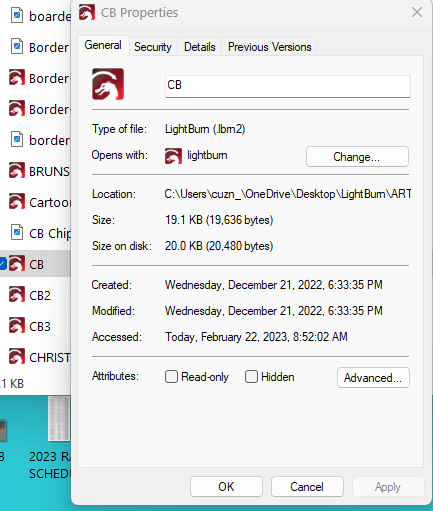

correct, I have a folder made on screen called [ liteburn ] so not to get it mixed up with the program of lightburn, in that folder I have another folder called Art, this is where all my completed designs are saved, and as .lbrn2 , screen shot shows , but now if I want to run this again say 3 days later, I have to import it from that folder to the art library in lightburn, and it will not come with the cuts&layers, so that I can just click on it in the art lib. and it put it on the grid,

Can you open file explorer and browse to \Lightburn\Art and see your completed designs? (*.lbrn2)
If so, what happens if you double click one of those?

I see that you’re using a cloud service. I have heard that there are potential problems with saving files to the cloud.
Thanks
Dang it can’t be that easy, I can go to the file in the folder, and double click and LB program opens and the cut & layer is there & correct, but I loose the cuts & layers when it imports it to the art library it does not take the cuts with it, THANKS THANKS THANKS ok all I have to do is forget about the lightburn art library and use my own folders. great
oh and the one drive does not seem to make a difference
