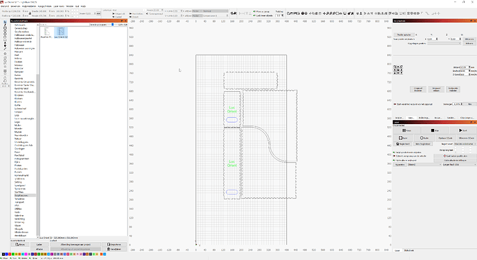

Thank you for the reply. My files always open in the middle of the screen. Never in the laser grid. I live in Belgium, so it’s afternoon here. Have a good evening.
HOW do you open them? Can you show a screenshot / video?
I always save them as LBRN2 and open them via the library.

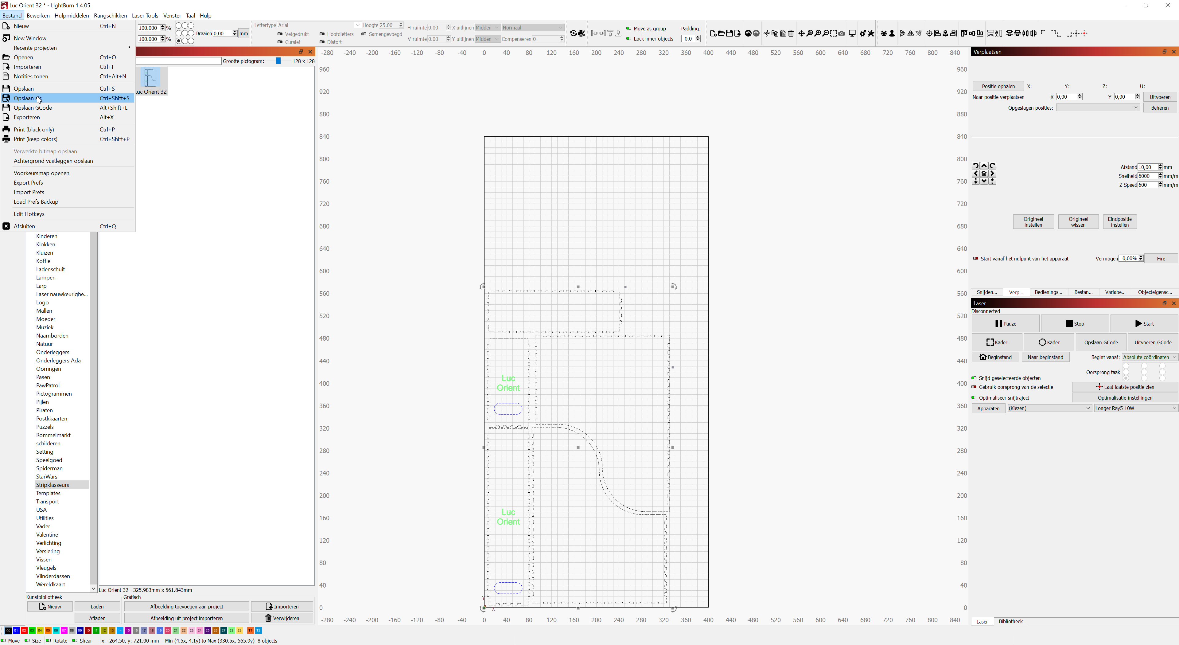

This is teh way a saved the file
That’s a different thing. The library doesn’t save any positioning information, it’s like you would expect - a library stores objects, nothing more. No positioning etc.
If you want to have the position stored, save as lbrn2 and the use File->Open to open that file.
Ah! I believe art library items are treated differently. I don’t think they retain location or setting data. I click/drag them in directly from the library window and drop them approximately where I want, then fine tune and assign layer properties. It’s a habit of mine to verify EVERYTHING multiple times, so I may not have noticed if some settings are always right.
You may want to develop an alternative organizational method and file>open the files rather than use the library.
Thanks, That was the problem. I always open through the library. When I open via Open file everything is fine. It’s a shame that this is not the case through the library. Have a nice day and thanks for the tip.
