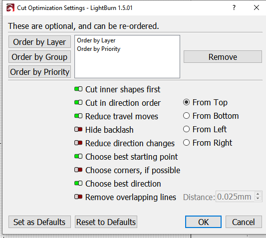

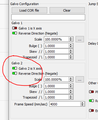

This may have been answered but I cannot find it anywhere. This has to do with Galvo settings staying between files and not saving to one specific file. Current job is serialization. Setup to engrave a specific way. If I go to create a new file and change the galvo from say x to y, or reverse direction it will stay that way when I go back to the original file where i’ll have to go and change it back. This is confusing to me and operators that go about their daily jobs. Is there a way to keep the settings per file?
Don´t know if I´m understanding you correctly, but check if the following options achieve the desired result.
I will check into this shortly. It just may be what I am looking for.

I’m not sure what you mean, reversing direction with the galvo reverse direction will mirror any text or images. If you want to change scan direction from top to bottom, bottom to top, etc use optimization. Or scan angle 180
Also, your settings would lead me to believe you have not calibrated your lens. It would be a rare find to get a lens that was 100% 1.000/1.000/1.000 both ways.
