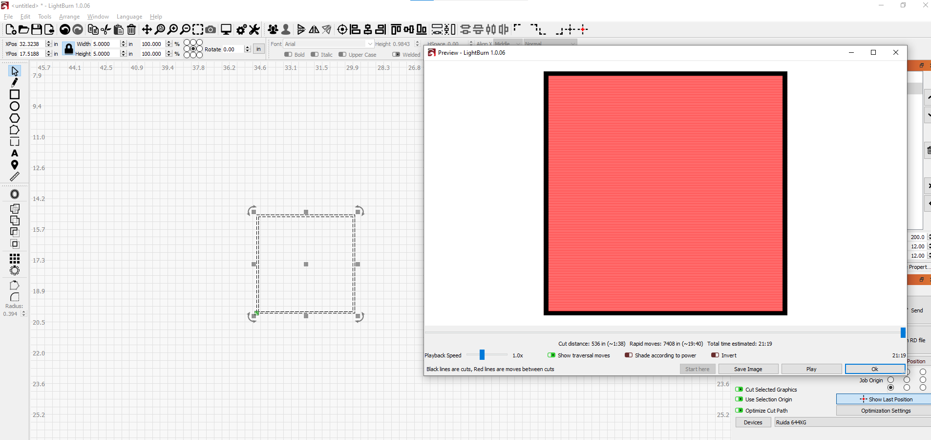

It sounds like you are looking for the option “Flood Fill”
Without flood fill on this 5x5 Square will take around 20 minutes to be filled.
With Flood Fill enabled it is dropped significantly
I hope this is what you were looking for, Flood Fill is located in the layer settings for “Fill” under advanced. It will still raster engrave the “border” however it will not travel through the white space to do so.
