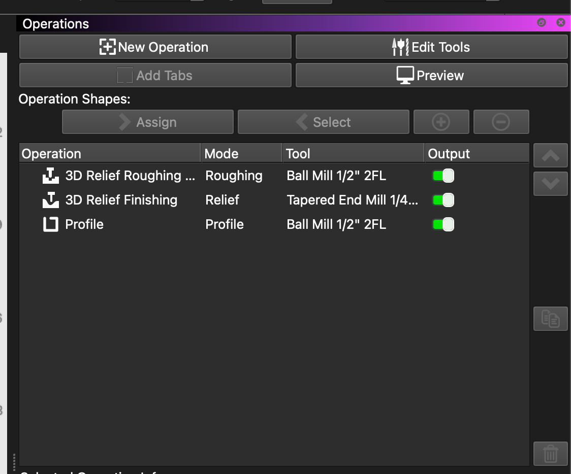

i’m on the trial of Millmage,i’ve made a project , my cnc is working only autonomous without a computer,so i need to save the gcode to send it to the machine but when doing save Gcode,nothing happen,what have i made wrong ?

with Millmage core,no problem,a window is opening when you save Gcode,but nothing in RC4.
i’ve found the solution to resolve the bug : right click on the operation and then choose export Gcode and that’s it
yes,off course,and my solution made files that don’t work in my cnc ,unknown error,will try with the core version.
it works with the core version,so RC4 doesn’t work with me,maybe could i do something to make it work ?
i deleted MM from my hd and uploaded again without import the prefs and all recreate,now all is ok,it works.
