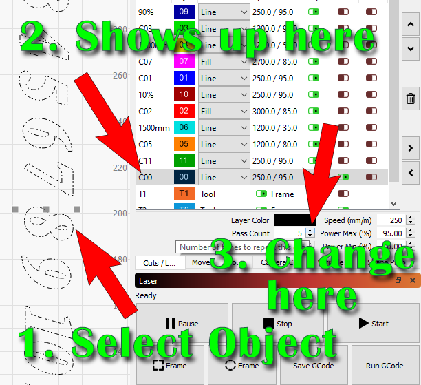

I’ve notice what appears to be a bug with the software: I have changed the Pass Count a few times and saved the file, only to find out the next time that it somehow reverted back to the previous setting. So I discovered what was causing it. I’ll give a step by step of how I discovered it, and the workaround. Keep in mind that the number of passes is irrelevant, it’s the change that seems to be the issue.
Select a shape/object and the correct layer shows up. Go to Pass Count and change it, then click on the Floppy in the menu bar to save it. It reverts back to the previous number. But if you deselect that shape/object, then change the pass count and save in the same manner, it maintains the new Pass Count. I’ve repeated this multiple times. Why would it matter that you have anything selected when you’re saving the Pass Count? Unless I’m missing the significance of this.

I’ll look into this - I’ve reproduced it here.
I assume this is a “sequencing” issue - Pass Count, and many of those values like it, commit their change when you click away from that control and do something else. (IE, when the control loses focus)
If that something else is the Save button, it’s possible that the save is processed before the change happens.

If I change the speed, the max power, or min power in the Cuts/Layers section on the right side of the application and click on the Save button, those changes are saved. If I change the Pass Count and click on the Save button, that change is not saved, it reverts back to the prior setting. It’s only doing this on the Pass Count. I’m strictly referring to the Cuts/Layers section on the right and making changes there.
Thanks, it’s only happening with the Pass Count, not the speed or Power settings. Initially I thought I was going nuts because I remember changing it to a lower pass count because it was 1 too many passes, then the next time I opened the file the pass count was higher.
This is fixed for the next release.
