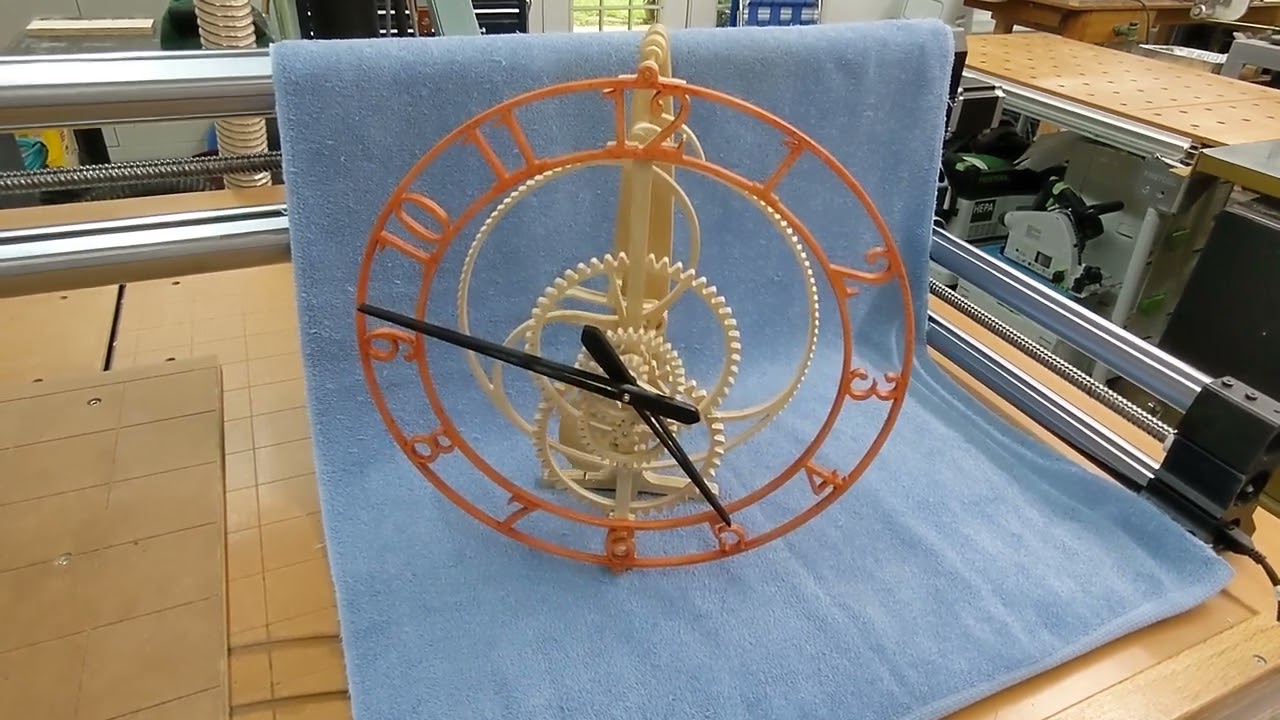

I have a cnc and have built a wooden gear clock using it. I will cut some of the parts for this clock on the CNC using VCarve.

I have seen his clocks. I have bought some other plans that include the files for CNC. I built one called the Magica but used my CNC spindle router to make it.
