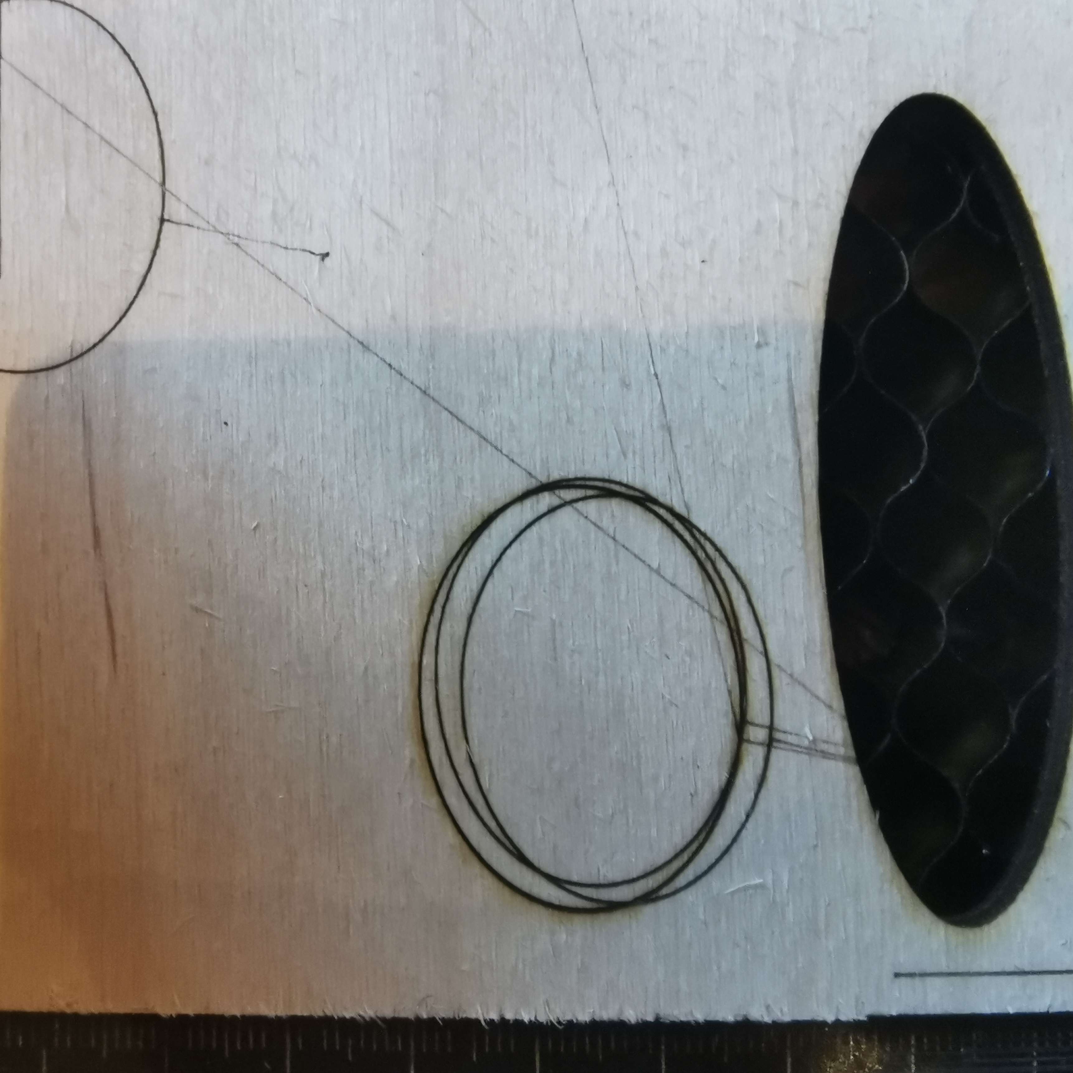

hello,
i have a SculpfunS9 and no problems before -
now i changed the orig. Lasermodule to a ‘LaserTree 80W AA’
[https://cdn.shopify.com/s/files/1/0549/7500/4823/files/LT-80W-AA_User_Manual.pdf?v=1663139401](https://usermanual LT-80W-SS)
i made some testcuts and the cutting worked well but i also did engraving -
if i start the program the laser direct turns on and did the engravings/cut but the laser dont turn off between the different cuts it always stay on…
the 2nd is i would do a test cut - a circle D=25mm(in Lightburn) and it tuns out as elipse (thhe bear also turns out as a elipse
look on the picturs
pls help me - i dont had those problems before if i use the orig. lasermodule…
cheers
Check your firmware settings. Most likely, you didn’t enable the laser mode. Set $32=1. Maybe also check $30 (1000) and $31 (0).
hi,hi there $32 is 1
$30 =1000
$31 = 0
Which board do you use? The original S9 mainboard? How did you connect the laser to it? Maybe show the full output of $$ in console window.
