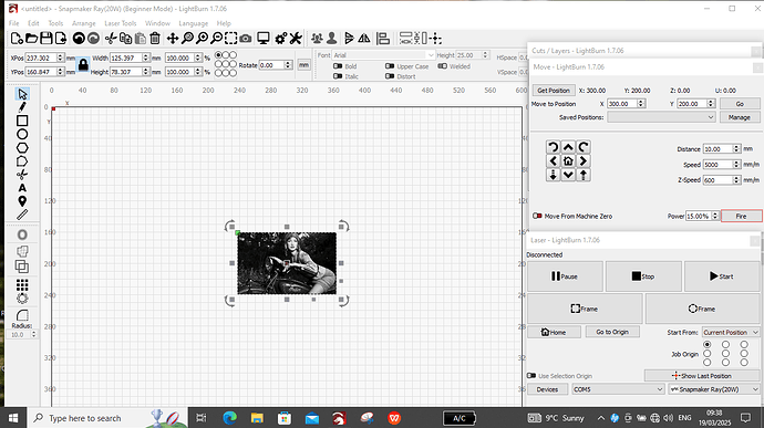

Im looking at the console report and noticed (G1 Y -79) and realised that is the Height of the rectangle on screen.
Also (Go X -122Y0) on the console, relates to the Width of the rectangle on screen
Does that indicate anything with regard to the ALARM2 on console and the ALARM:2 - Common user error (GRBL error…means…tried to send your laser out of its usable work area…your not using Absolute Coords as yr start from setting.
I was following the wiki instructions for set-up using LB which asked me to use Current position.
Sorry about the phone pics of screen, I was thinking so hard about this…I forgot how to get screen snips onto this msg.
I only use Current Position when using the rotary. ALL other times it is Absolute. Current position is not repeatable but Absolute Position is both repeatable and easily predictable.
Yes, it is possible to go out of bounds with that Y-122 command. With Absolute, there is never a negative motion command because Lightburn works in the first quadrant. Your machine can be confusing because your Home position is the left-rear rather than the left-front. However, if you imagine looking at the graph paper from the bottom instead of the top (flipped over top to bottom), you will see your coordinate system as +X+Y for all moves.

There was one thing I noticed about the ‘fisherman in the boat’ and that is its mirror III quadrant. In that quadrant the writing was reversed and in my image of the woman on the Indian Vtwin…the word Indian is also reversed…Is that significant?
I did a lot of study last night, into Error codes and G10 using +/- values and put some time into it today.
But kept getting Error2 and others, but speaking of other quadrants..I noticed above the 0 on Y axis Left side of grid, there is a -40 and the same -40 at opposite on the right side of the screen grid…hope it shows in that pic as I left the laptop as may return to it later.

Today I decided to input $RST=$
On screen, X Pos 300 & Y Pos 200 and the image I used was in the centre of the screen.
Job Origin set to top left circle.
Move Window, Get Pos = X 300 & Y 210
Move To Pos = X300 Y200
Laser Window-Start From = Current Pos.
I pressed START & module moved to front Right, and crashed into Y axis near front corner with Motor Judder…Pressed STOP.
In the Move Window, Jogged Forward ( chevron pointing down) and Gantry moved toward Back of machine.
Move button (Left pointing chevron) moves module to Left & Right pointing chevron moves module Right.
Move Pos set to X300 & Y 200..Pressed GO.
Module moved forward & Right..Juddered on Right hand Y axis.
I input to MOVE Pos, X0.00 & Y0.00…Pressed start…Moved a little bit…And began lasering.
I adjusted Power & Speed during engrave and job completed.
Because it was well out of focus, I discovered the laser dot is Narrow on X and long on the Y.
Gantry moved toward front during engrave.
The image was engraved Upside down.

Does this info say anything about the coordinates of the control board and those of Lightburn.
