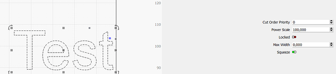

This is already possible with the latest version, you can set a size for the text property, and it will scale the text to the available space. Combined with the serial number / CSV function, you could automate at least some parts of it. A video about it:
And the shape properties feature (can be combined with the technique above).
