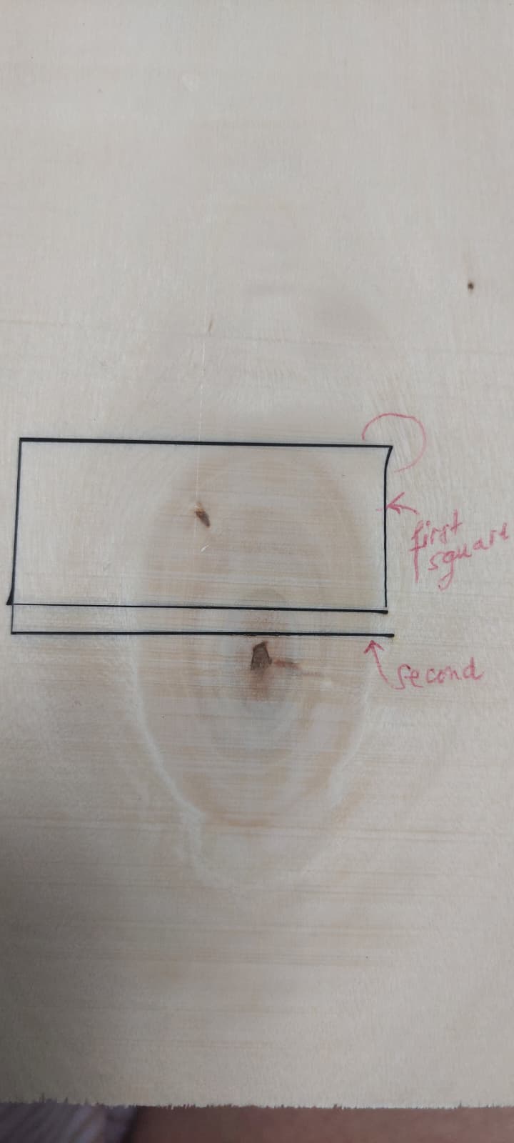

My SculpfunS30Pro20w it is not able to recognize the route conform the project. It is not able to keeo 2 paralel line. I beleive that she lost the zero;zero coordonate in running time.
in this picture is my cuttest…everythink is in misorder, the square are not closed…dezaster

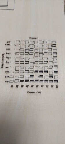

in second picture, i draw a rectangle and give start. after finish i start again the same project…the square. the second one it is not in the same place
please help me
You have serious mechanical issues. You need to set up the mechanics carefully (this is not done in the factory!). Especially your y-axis is losing steps, but x as well. Go through this guide:
Hello and thankyou. I found some screw untightethen. Now everythink it is ok. Read cap 11 on “Guide to mechanical adjustment”
Nice! A loose pulley screw perfectly explains the unconnected lines you saw.
