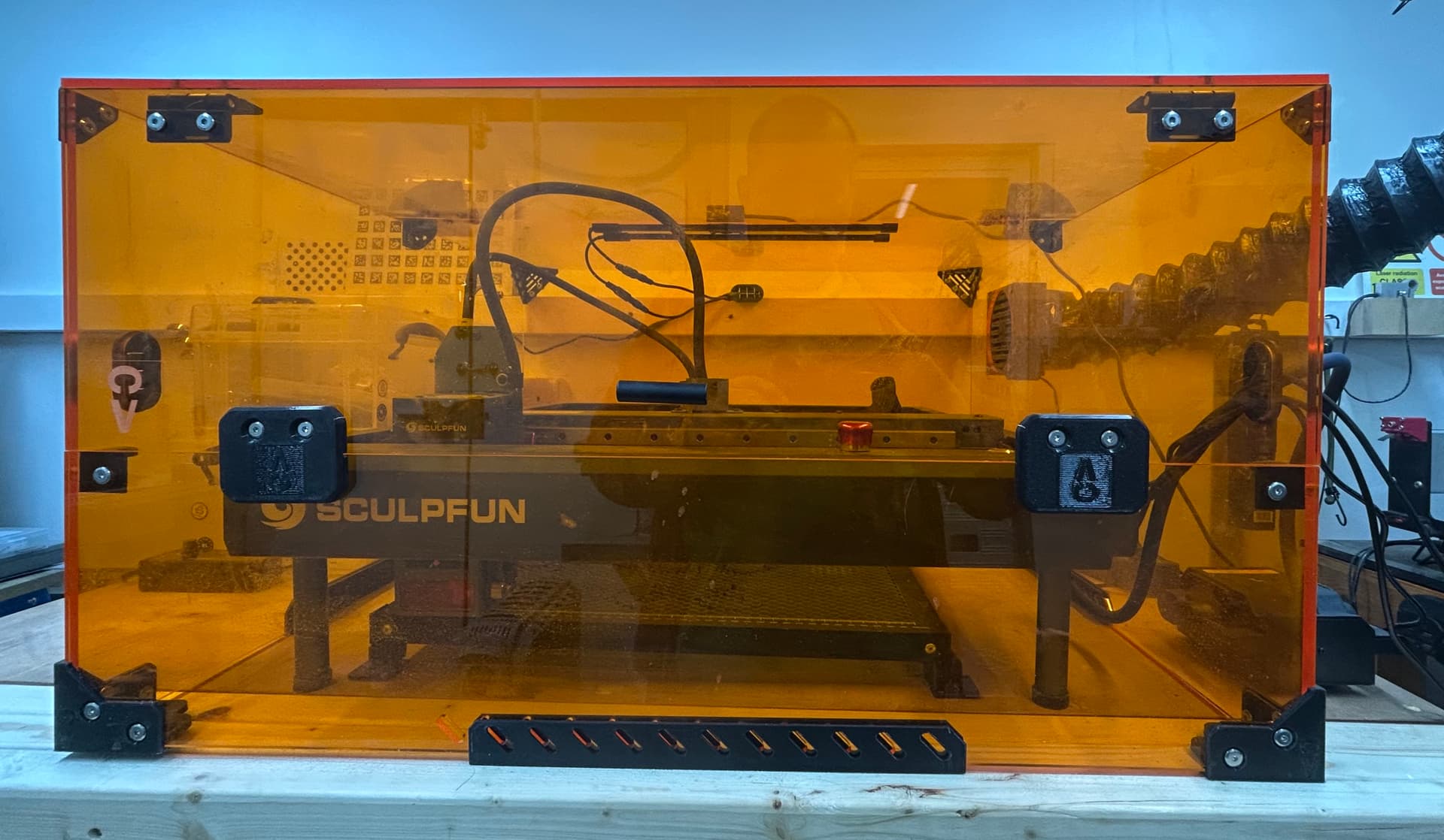

Following my purchase of the Sculpfun A9 40W several weeks ago, it has finally been fettled and is behaving as expected. Part of the delay in getting it up and running was awaiting parts for the enclosure. The following image is a 300 x 200 x 3mm piece of birch plywood. It was engraved at 40% of the 20 watt power setting (8 watts) with air assist. The laser traversal speed was 1000mm per minute. The total time to engrave the 180 x 180mm jpeg file, which was converted to a vector file using Lightburn’s trace tool, was 9 minutes.
The second image is the completed but open enclosure. It is equipped with a USB camera, 2 rows of LED strip lighting and a 200 CFM extractor fan with a 100mm outlet.
The third image shows the enclosure closed.

8 watts is a relatively small power output. The air assist prevented any scorch marks. The traversal speed of 1000mm/min provided enough local burn time to engrave the design to a uniform depth of 0.2mm, with the overall effect being that of a machined engraving. Being photographed from the front of the flat plane does not demonstrate the engraved line depth. It can be felt with the fingertips, while showing it photographically is unlikely at such a small depth. Overall, it provides a certainty of engraving the depth of the wood, which creates the impression that the pattern is evenly engraved across the whole surface of the workpiece.
