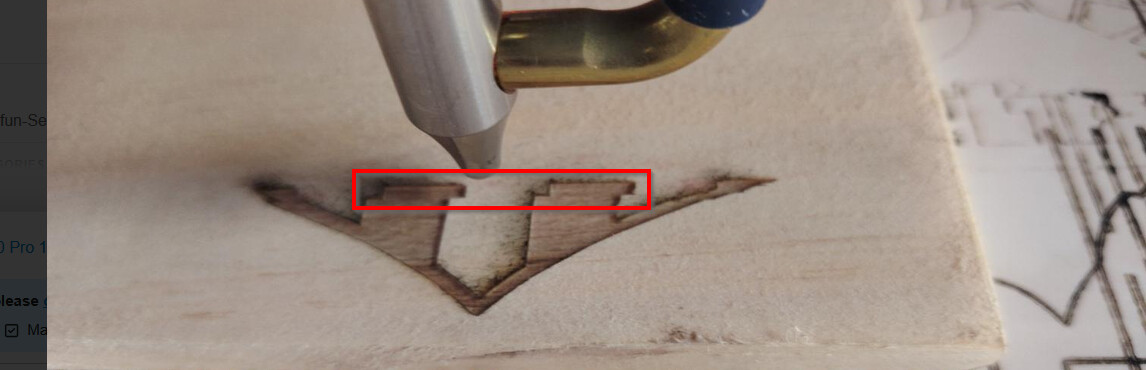

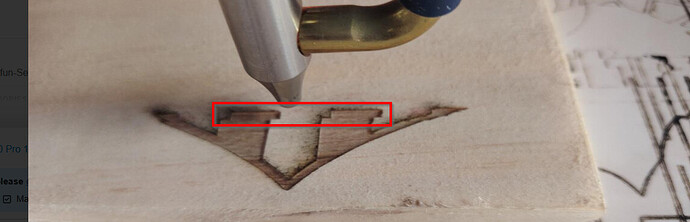

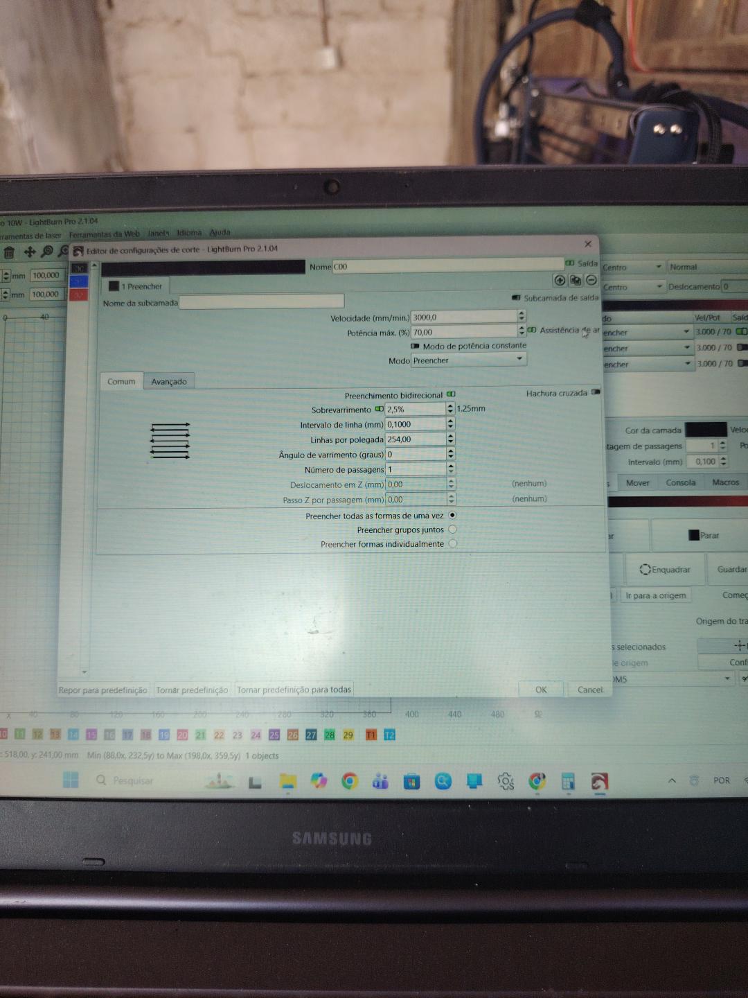

Hi. I have a SCULPFUN S30 Pro 10W and use LightBurn.
I’m having an issue with fill engravings. When I create designs, the engraving always starts to lose focus in the same spot.
I’ve already tried disabling Bidirectional Scanning, but that didn’t change anything.
I’m using the same speed and power settings as always.
Which settings should I check? Could it be the Line Interval, Overscan, acceleration, max speed, or another LightBurn setting?
It is not losing focus. I do see too much power outlining the shape. Can you mark what you mean in the image, and maybe upload the Lightburn file (.lbrn2) you used to create the burn in the image so we can inspect it? I also have the S30 10w machine, so what you get should duplicate here as well.
Hallo ! was ich auf den Bildern sehen konnte ist vielleich zu wenig Overscanning mit 2,5 % und dabei nur 1,25 mm , erhöhe den Wert damit du auf etwa 5 mm kommst dann werden die Ränder auch sauberer .

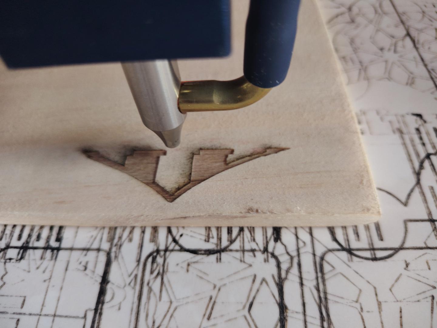

Are you talking about this?
This is 99% mechanical. Check your mechanics closely and try again. Probably a loose grub screw.
