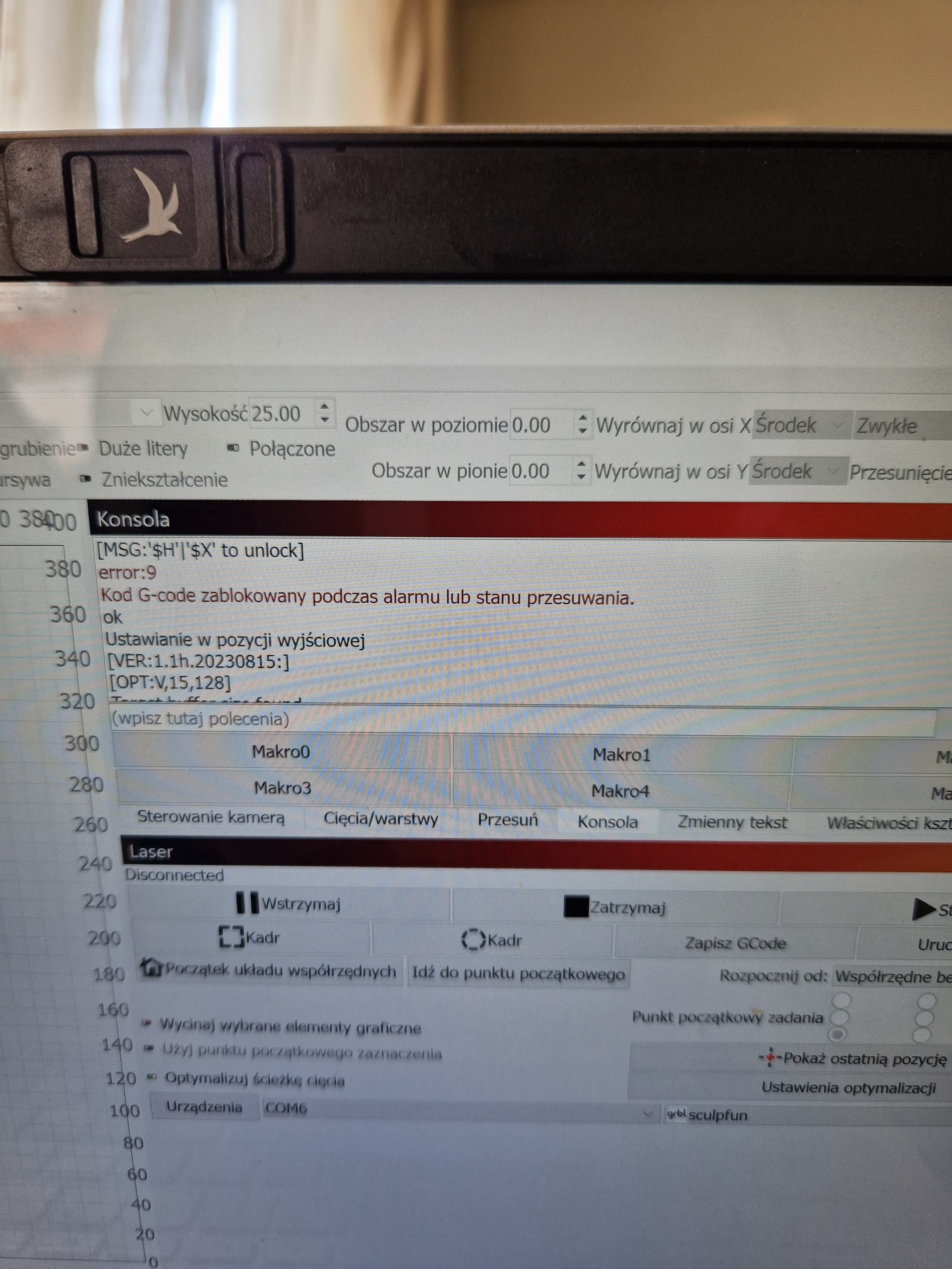

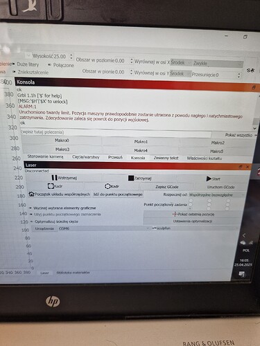

Sculpfun s30 pro alarm:1, 3,9
It worked normally for a few months, suddenly after switching it on it started making strange loud sounds and has problem moving. Alarms appear: 1, 3, 9 and G-code blocked. alternately but most often no. 1. After switching it on, start it to make e.g. a regular square - The machine goes forward and backward and when the laser is supposed to go sideways it makes noise and shakes in place. It also has a problem with returning to the origin of the coordinate system.
Do you have limit switches?
Sounds like switches not being tripped.
Turn off auto Home in Lightburn. Position laser module in middle of workspace. Power up machine. Click on Home.
Does it travel to the front-left corner, THEN make the noise?
Check for a loose switch or loose connector.
