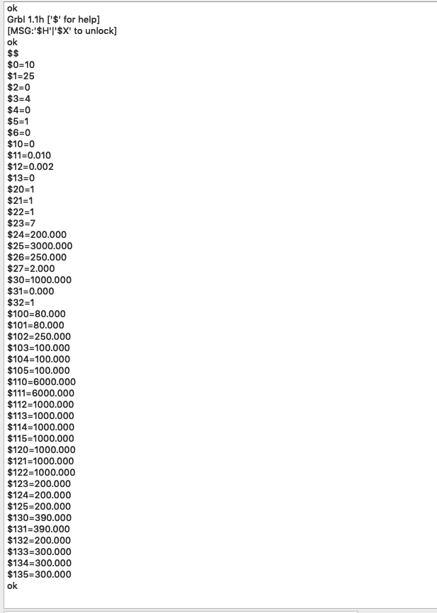

Hi everyone, I’m new to laser engraving, bought the Sculpfun S30 Pro Max right before the new year. Got it set up and was up and away printing with no issues on an older Macbook Pro running Mojave.
Then one day I decided to use my new Macbook Pro which is running Monterey 12.1. Immediately the machine started having issues homing, it would go to the correct corner but the motors would keep trying to move it making a horrible sound, and I noticed it said the positioning was like -430 and -430. I assume it has something to do with me using a new computer but I havent been able to use my old computer again and make it work. I’m also not very knowledgeable on much of this because I’m new to it all, but I took screenshots of all my settings and hope this can get me some help on what the hell is going on. Like I said, I had absolutely no issues for about two weeks, but it was the moment I connected to a new computer that everything seemed to stop working. I can’t believe that would mess everything up so bad but who knows. Much appreciated to anyone who can shed some light on this for me, I was having so much fun!

Sorry this wasnt included before, heres the settings from the Console
Homing is managed exclusively by the laser controller so this issue is unlikely to be related to the computer used.
For some reason your controller is not recognizing the homing switches as being activated. A few things to look for:

I agree to PY, this is not related to the new computer. The USB port could be different and causing problems, but it doesn’t seem so according to your screenshot. LB is working fine and the connection as well. So, it’s a firmware or hardware thing. Since your firmware settings look correct for the S30 series, I suggest checking the wiring and hardware, as PY suggested.
Thank you both for helping me verify that the software wasn’t the issue! I don’t know how I hadn’t actually verified that the laser head was triggering the limit switch or not, but I had raised it(the laser head) up high to put some material underneath and that position for the head actually would not set off the y axis switch. Just had to lower it to normal and it was fine, feel stupid for losing a week and a half because of that!
