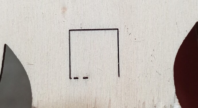

I have a Sculpfun S30 ultra 22W machine since early 2024 and have never encountered any serious issues except for now. A few days ago, after printing a project, I noticed some items were partially cut through and some items were not even cut at all. I tried to recut them but to no avail. I then decided to cut a simple square to see what is happening. I did this twice in different locations and the outcome for both was the same. These two cuts are seen in the attached photos. As you can see, there are some missing cuts. What I found very strange was how similar the cuts were! I then tried to cut a long rectangle and the cutting seems quite similar too. Photo is attached too. Clearly it is not a wood grain/glue issue as I cut them in different areas of the wood with the same result. It appears that that the laser module starts to move along the requested path but there is a delay in the emitting of the laser.

On the day after, I repeated the cutting process and this time I had similar cuts to the first tests that I did, ie the laser seems to be emitting with a delay! I have videos of this too.
I even tried to engrave but, in this case, no laser is being emitted at all.

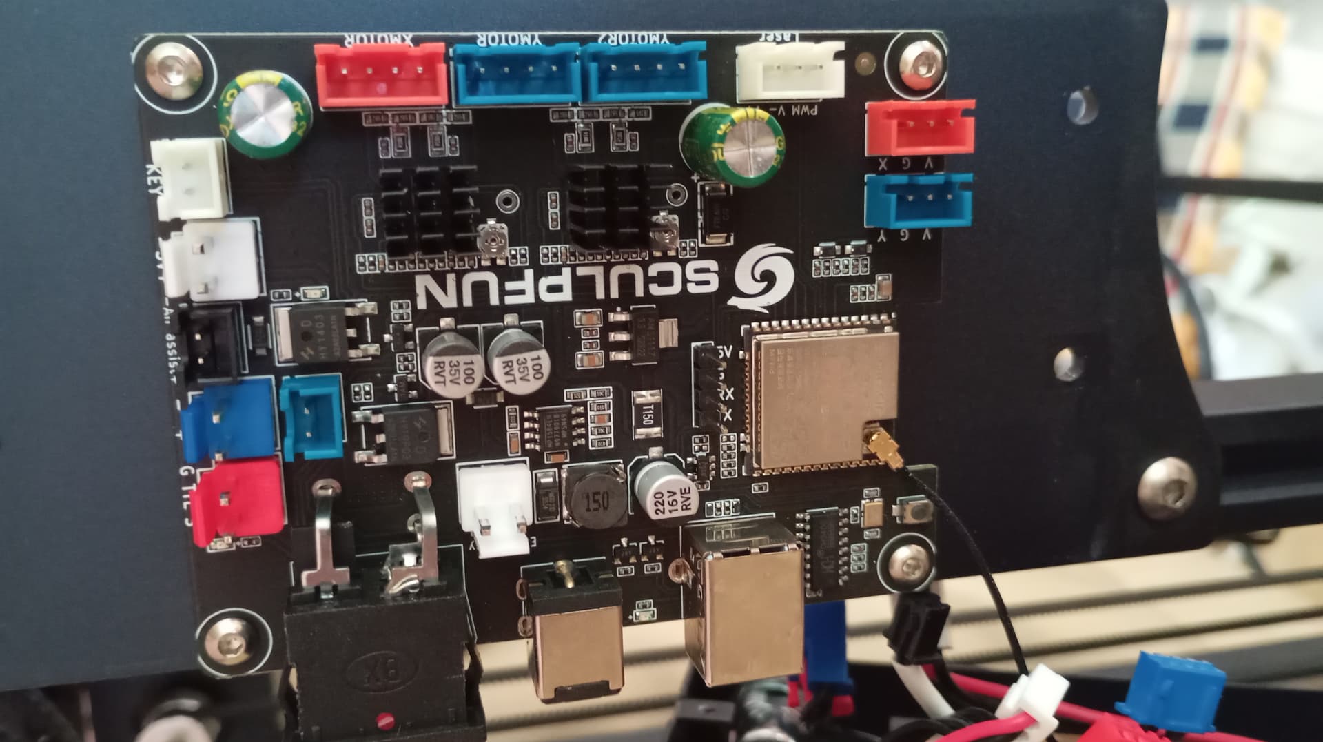

A few tests carried out since yesterday:
1: Replaced the usb lead from laptop to laser but same results.
2: I removed both the main motherboard and the laser module control board (photos attached). There is nothing suspicious with them.
3: Motherboard output voltage to control module should be 5v at 100% power. Mine was 4.7v.
4: I connected a multimeter to record voltage output from motherboard to laser whilst cutting at 90% power. When I look at the recorded video (1 : Cutting a square to show motherboard output voltage) in slow motion, one notices that the laser is being emitted with a delay AFTER the laser head starts to traverse the square (see video at about 15 seconds). It is clear that the motherboard is delaying the output voltage of around 4.26 to the laser module.
So, from this analysis, it appears the delay is coming from the motherboard and hence I think it is faulty.
5: Repeated the process with 40% power (for engraving). This time, despite the motherboard sending the voltage to the control module, the laser never emits anything!
This indicates that there is an issue with the control board.
Summarizing, could it be that both boards are faulty simultaneously or am I missing something? I wish that with this info, someone else might look at it and provides interpretation with a view to understand the source of the problem.

You can’t measure a PWM signal using an analog probe. So the PWM signal might be fine.
You can plug the PWM signal connector of the laser head to the 5V connector of the board and the module should fire at 100% all the time once powered, this can be used to test the overall function.
This is a weird issue, the first thing to do would be to flash the firmware again. Erase the board and flash the firmware. Then check again.

Many thanks. Just tried this procedure now. However, unfortunately I get the same results.
Then it sounds like a hardware defect. Sculpfun will replace the board most likely. They have great support.
This is to close up the subject. I tried to replace the motherboard but this was to no avail. However, the replacement of the laser control board did in fact solve the problem. All is well now.
