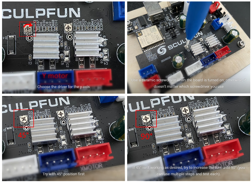

I guess you adjusted the stepper driver voltage during upgrade? Make sure to only turn the potentiometer 45° maximum. Not 90°, as the manual suggests. That caused issues for many users.

Only change it for the Y-axis driver. Do not adjust the X-axis one. The x-axis still has one motor, but the y-axis is driven by two. That’s why the power has to be increased on that one, but the video tells too much. Many users complained. With 45°, it worked fine for all (myself included).

You can also use my guide: Workspace extension kit - Diode Laser Wiki
Both correct.
Ok, I can fix that.
Also, did you have problems with the ports on the white, blue, and red connectors not being the same colors? I’d forgotten about that until seeing your images.
Yes, they might have changed the mainboards in the meantime. Colors do not count; check where the cables are going, the labels on the board are correct.
That seems to have been the perfect solution!! Thank you!!!
