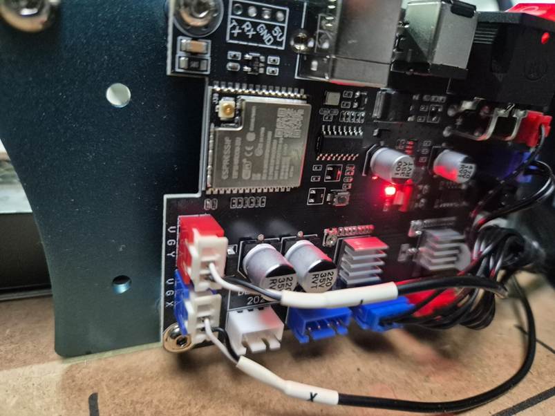

My 5.5 watt module lost power so I bought a new module / MB and Connection cables.
After I installed everything, the laser is not working how it should.

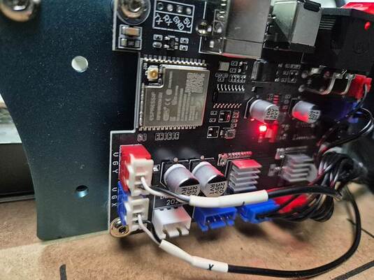

I connected the limit switch like:
RED (X): I connected the X cable
BLUE (Y): I connected the Y cable.
I have used the reset command.

When I try to home the gantry only moves to the left till it gives me error:
Hard limit triggered. Machine position is likely lost due to sudden and immediate halt.
Re-homing is highly recommended.

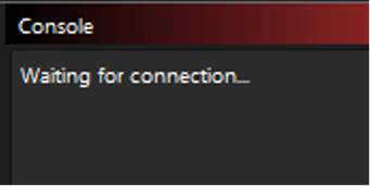

The console shows:
When I Switch the Limit cables.
RED (X): I connected the Y cable
BLUE (Y): I connected the X cable.
I can burn one project and after that the connection is lost.
Who can help me?
