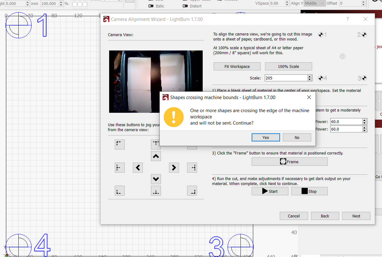

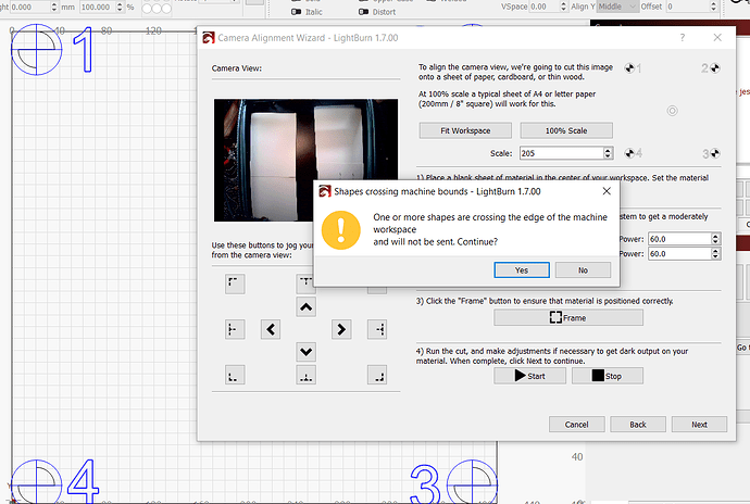

I try to calibrate camera, but its still some bugs, like distortion. Workspace is bugged too, i have 410x400 workspace, when im trying to configure camera, the frame are flatted, and example with 4 numbers too (look in screenshots).

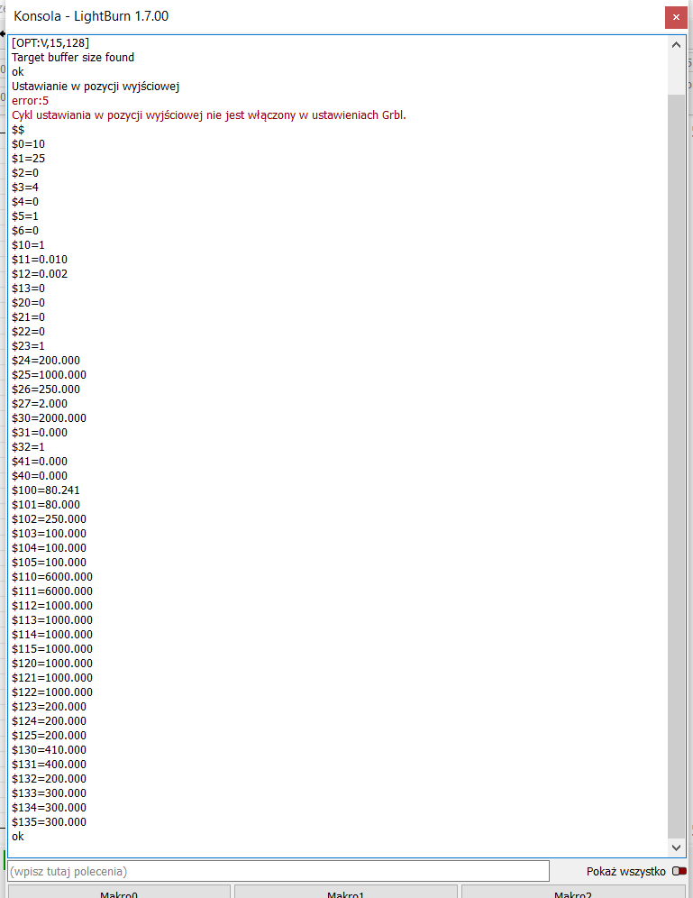

Can you go to your console window and type in $$ then enter and copy and paste output here?

Your steps/mm value for the Y axis is wrong. You have something like 26. This has to be 80. Set both axis to 80 steps/mm and then test again.
Something like this :slight_smile:

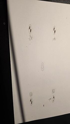

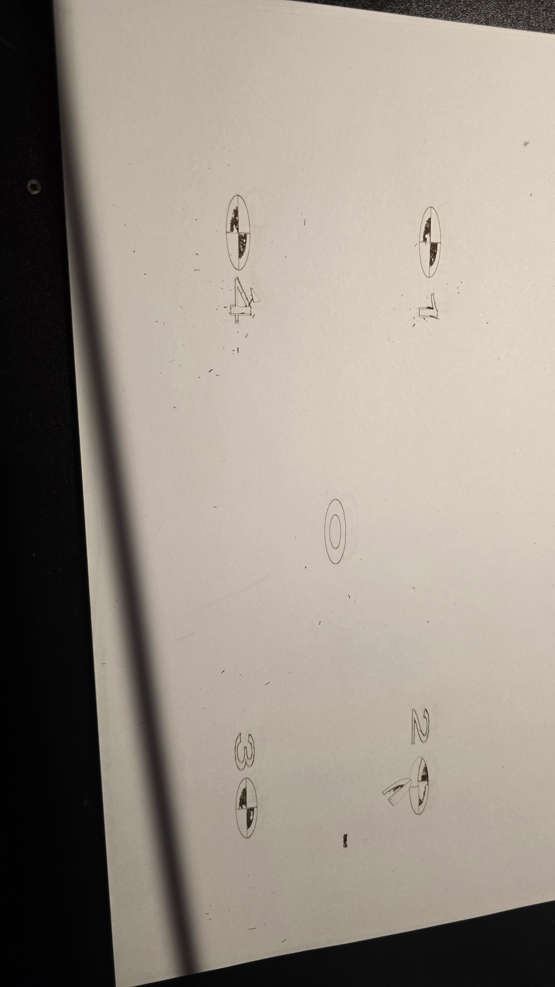

Its much better, almost all workspace is use in calibration, but now patter acrosss a machine workspace :face_with_peeking_eye: I must change this steps X, Y value or its something else?
And where i have to calibrate workspace? when i chose location on the laser manualy in workspace, for example y - 10mm, x - 50, the laser turn in y - 25, x - 80.
First of all, did you add limit switches to you S9? Otherwise it does not make sense to add a camera.
Next, in the dialog window, let LB choose the size of the calibration pattern, it usually does a good job. You do not need to change anything here. If it fails, change the scale to 170% or so, as your current scale is 205.

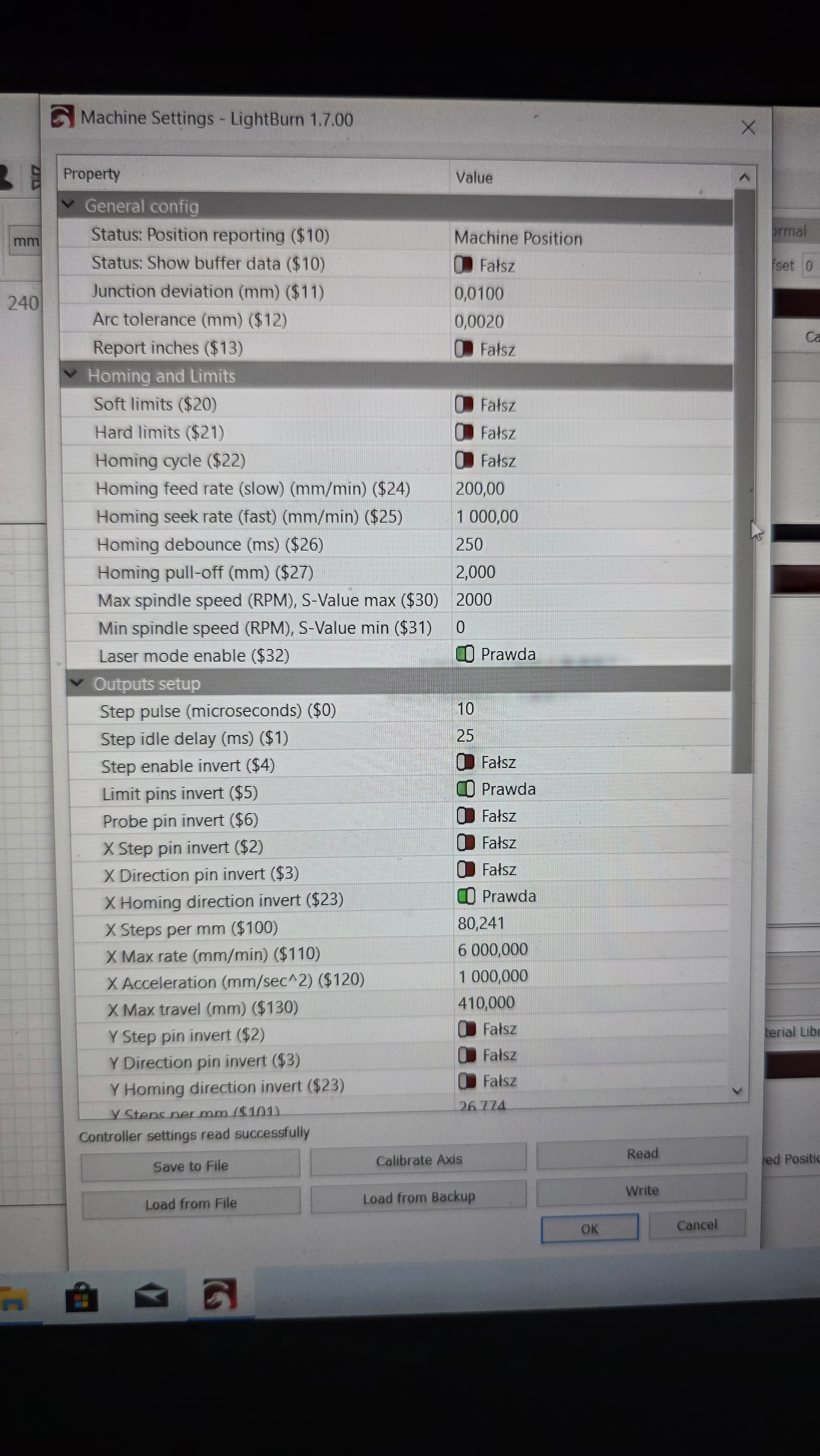

Last question is about this screen with values in screenshoot that i send before.
This is all okay? Only x,y steps will be bad?
I cut few minutes ago project, and material size whose i cut is difrent than project in lightburn.
Most are ok, but $30 should be 2000. Otherwise you are probably using only 50% of the laser power at the moment.
You can find a table with settings here: Firmware Update & Settings - Diode Laser Wiki

Yes. Or set the s-value max in device settings also to 2000 :wink: But usually, having it on 1000 everywhere is best.
I do not think you will gain much with the increase in step values. At 1000, you are already down to 5mV per step. That is 0.1% on the 0-100% power scale if I did not screw up the math.
