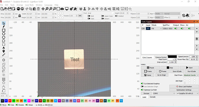

Question, could you open the project you are trying to run and take a full screenshot of your Lightburn window.

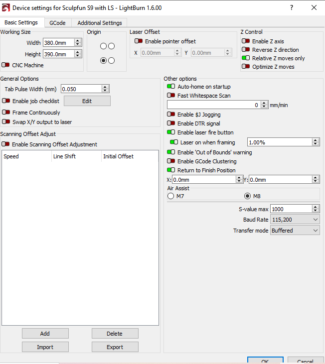

Additionally, please, could you also go to Edit > Device settings and take a screenshot
Hi Gil,
Please let me know if you need different windows in view

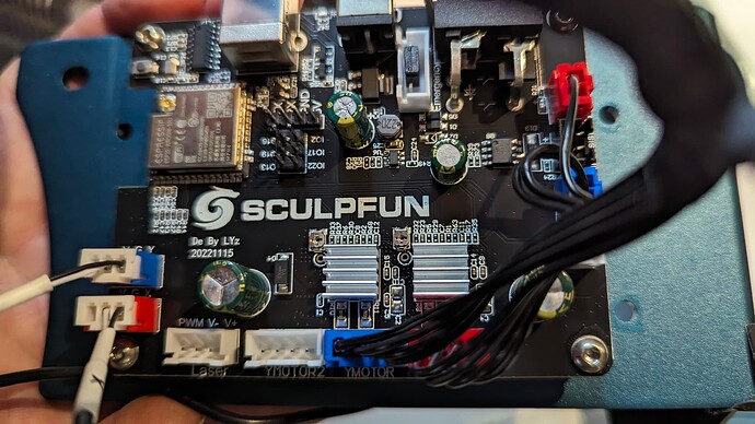

Just in case here is the motherboard
Everything looks perfect

I ran the test again. You can see the “Test” is slightly visible. But yesterday everything was working normally.

This would be indicative to a flaky cable, wire or connector
 You can pull them out and reseat them.

Did you try to do the “Test” text as line instead of fill? In your fill settings, you set the interval to 0.2 which is huge for the S9 head, the optimal line width should be 0.08. So there will be much whitespace in between the lines that could make it look faint.
