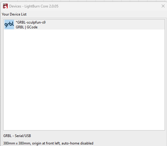

When following the instructions above there is NO difference. Both times the head stopped 1-2mm away from the X switch and the laser had to be manually turned off to stop the grinding noise and vibration.
However, on rebooting and reloading Laser GRBL, moving the head to the centre of the frame and selecting the Home icon, the head moved smoothly back to 0,0 and stopped against both switches.
When trying the same with Lightburn, the head did exactly as before - 1-2mm from the X switch it stopped and made a grinding noise etc. As I said to Misken, if I set the X=0 and Y=0, on the Move tab in Lightburn, and then Go To Position, the head goes smoothly to 0,0 and stops against both switches.
Here is the device as setup in Lightburn

Did you also reboot and reload Lightburn?
Actually, the answer does not matter. The Home cycle “it failed” with LaserGRBL followed by the “it succeeded” with LaserGRBL suggests a mechanical issue. It appears your machine is on the ragged edge of triggering the Xaxis switch. Othewise LaserGRBL would not have failed.
On the Xaxis switch, put 2-3 layers of masking (or other thick) tape on the lever of that switch. Test with both LaserGRBL and Lightburn.

I tried that just now, and I even moved the switch 2mm across the bar, with the same result as before. In fact, when I moved the switch the head tried to force it back to the left !
I’m going to admit defeat and I’ll either remove the limit switches and go back to operating ‘by eye’ or use the Go to position 0,0 on the move tab.
